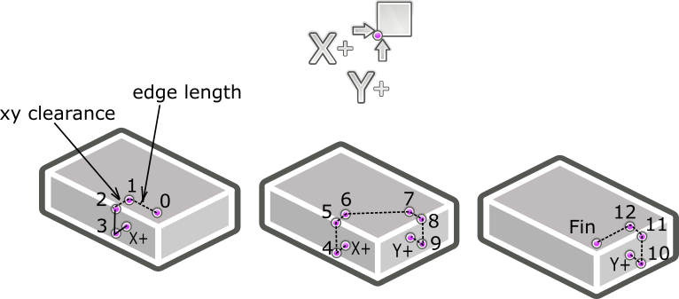

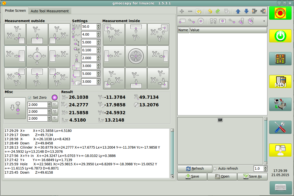

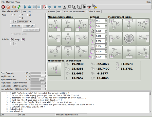

For full and comfortable working with the probe in linuxcnc I wrote the application Probe Screen.
In this article, I will share the description and source code.
Attention! Measuring operations are very intolerant of incorrect settings. It is strongly recommended to do preliminary tests on loose object that will not damage the probe when unexpected movements. It is recommended to carefully check each setting before measuring the workpiece.
Installation.
Use.
Set the probe in the spindle.
Move manually probe for Z about 2-10 mm above the workpiece surface,
and for XY about the position indicated by the colored dot on the appropriate button Probe Screen.
Fill parameters. Meaning of the parameters should be clear from the names and pictures (the name pop up when approaching the mouse). If you change the parameters are automatically saved in manualtoolchange.pref .
Hit only! the button that corresponds to the position of the probe above the workpiece. For the other buttons - another position above the workpiece.
You do not need to expose offsets for tool "Probe", the program desired zero offsets for the current tool makes herself, and G-code works off all in relative coordinates.
In fact, you can use the application immediately after the Home.
The trajectory of the probe by the example of measurement outside corner X+Y+

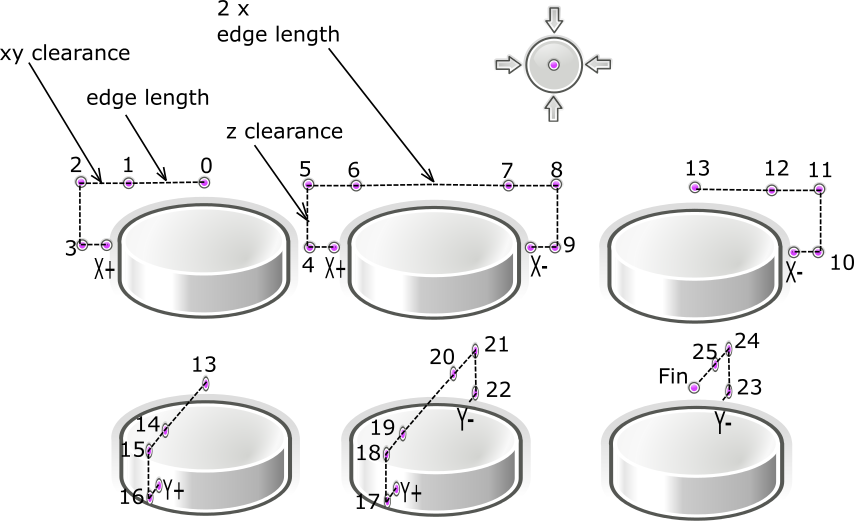

Path measurement cylinder, edge length should be approximately equal to the radius of the cylinder measured, xy clearance - outside offset from the walls of the cylinder

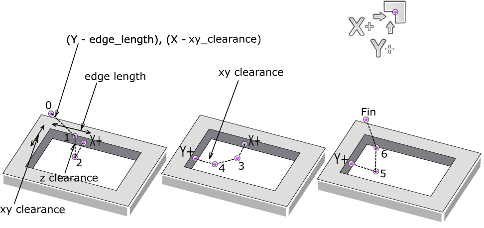

The trajectory of the probe by the example of measurement inside corner X+Y+
Path measurement hole, edge length should be approximately equal to the radius of the hole measured, xy clearance - inside offset from the walls of the hole.
Any of the search ends at XY moving at the desired point (or edge, or corner, or center), Z remains in the original position.

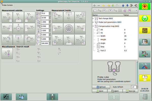

Replied by mariusl on topic Work with probe
Hi
Gmoccapy loads with the probing stuff loaded in the usertab but when I run it the system goes to MDI mode and nothing further happens. Is there some other stuff that must be installed or not?
