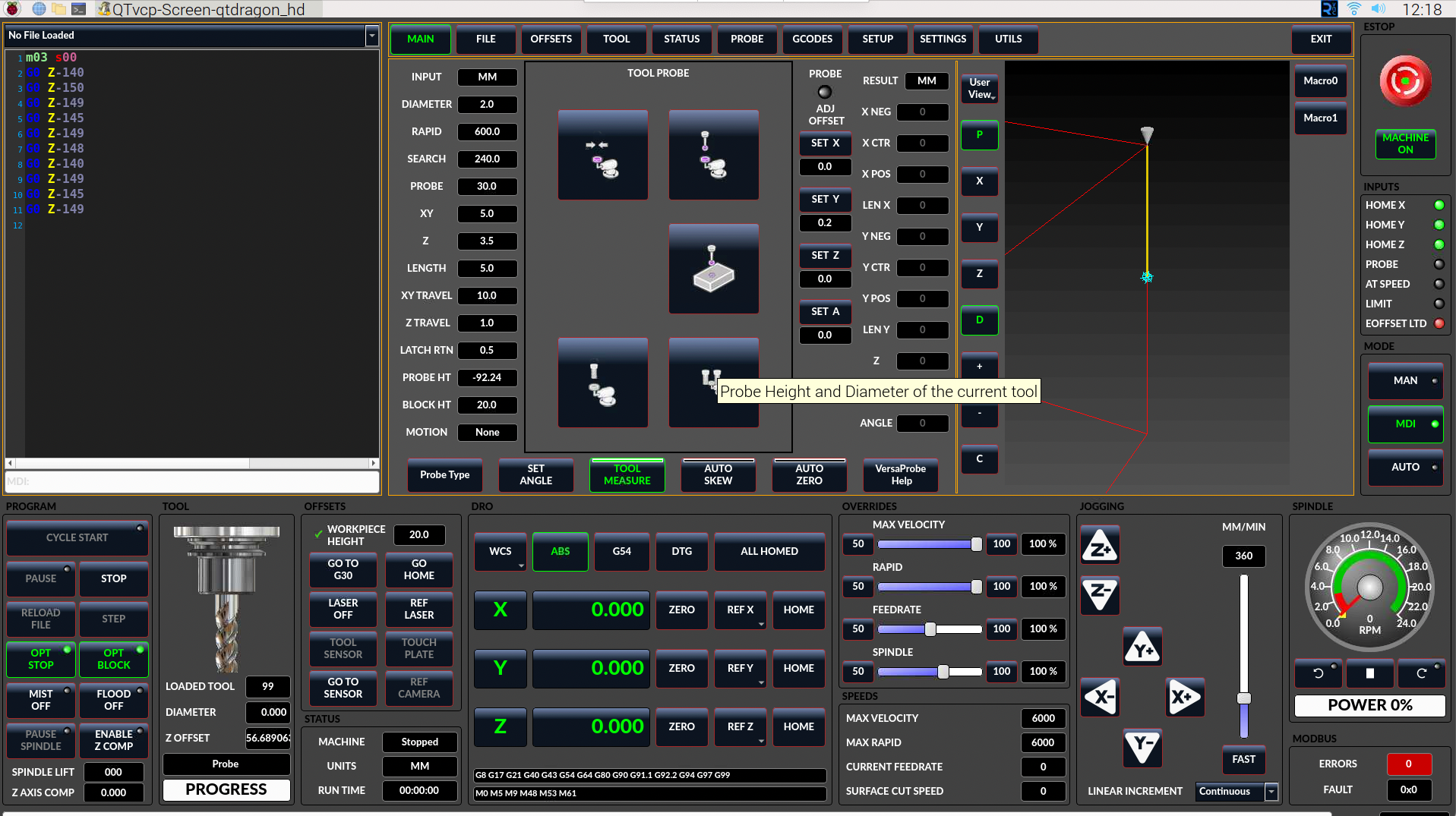

Have some issue, cant make Probe height for current tool / Probe height and dia of the current tool working
all other functions works, but that 2 probing remain disabled
versaprobe is set and working
pi4 / linuxcnc 2.9.1 / qtdragonhd
Tool measure enabled
M6 remap done
toolsetter xyz set, speed, dia, rev speed seet

Qtdragon uses a derivative of Verser's probe routines. It has diverged a lot code wise.
The tool probing measure routines are disabled in 2.9 (enabled in master).
The routines are there but I'm not sure if they are right - I'm sure master got more work done.
It's possible to enable them with a simple python file patch, but you would need to test very carefully. If you are interested in that, please open a subject in Qtvcp forum.
Maybe Verser can help us get the code better in the linuxcnc version.

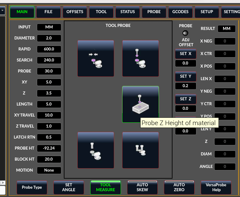

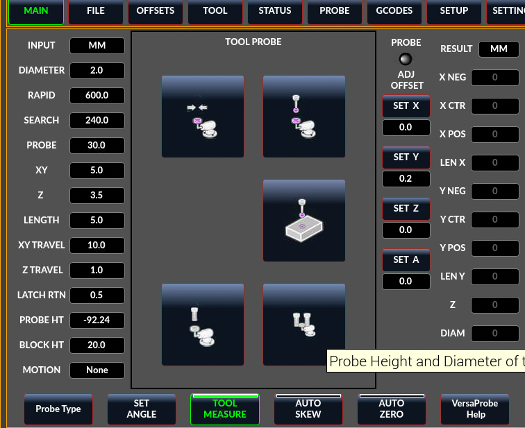

Add this to CONFIG_FOLDER/qtvcp/screen/qtdragon/
name it qtdragon_handler.py
Then the button will be enabled.
It will probe down
then move in x half of (tool diameter from the tooltable+tool probe diameter)  probe
move to the other side in x - probe
move to the center then do the same in Y
then will display the diameter in the probe status
Chris

28 Jul 2024 13:26 #306235 by chernogorsky
Replied by chernogorsky on topic Work with probe
Ok, it works if I add it to CONFIG_FOLDER/qtvcp/screen/qtdragon_hd/ as qtdragon_hd_handler.py
Thank you
28 Jul 2024 17:54 #306250 by chernogorsky
Ok, it have some Z issue
so the flow is
1. do probe_tool_with_toolsetter
1.1 touch TS
1.2 go back Z_CLEARANCE (Z = *0 + Z_CLEARANCE)
2. perform XMinus
2.1 Go to X+ # move X - edge_length- xy_clearance
2.2 Go down with z_clearance_down (Z = Z - Z_CLEARANCE == *0)
2.3 Perform probe('xplus')
on 2.3 I have an issue, since its try to locate the edge of the TS with Z = top_of_TS == *0
