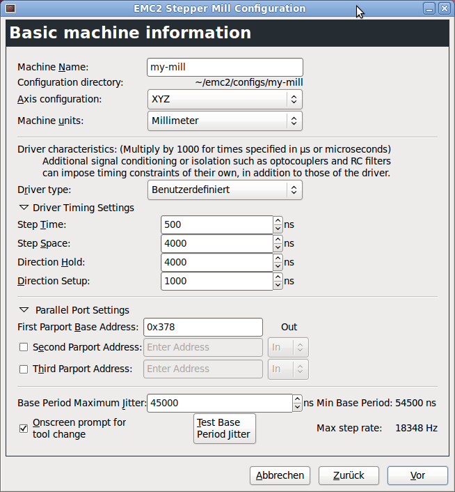

You did not state how you came up with your configuration, Did you use Stepconf?
If so you can review the info here on setting up the axis...
www.linuxcnc.org/docs/html/config/stepco...axis_configuration_a
Scale is what you want to adjust.
To check the Scale I like to use as long a move as possible so I move the axis as far negative as it will go, then make a short positive move (to take out any backlash), set that as zero then make as long a move as possible positive and measure the results.
If off calculate the difference and adjust the Scale.
I do this at relatively slow speed and acceleration so as not to worry about missing steps.

We don't know what your base period setting is, but I would expect you are seeing inaccuracies because you are generating so many steps to get anywhere, you are losing steps and thus position.

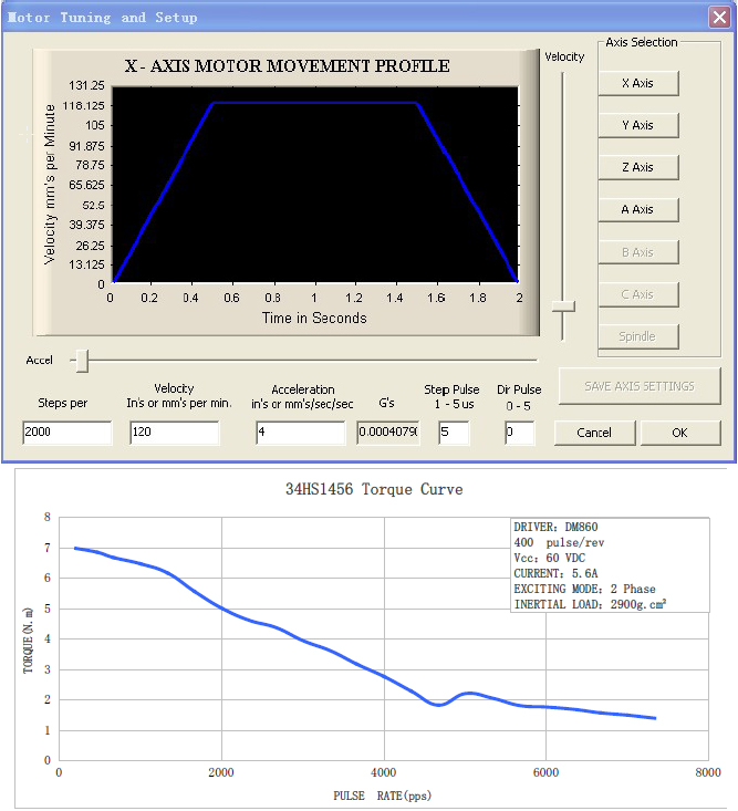

Yeah I used the stepconf, but from what I have seen you can do it in either the stepconf or ini file. Ill have a look at the config doco.. I got some specs from the manufacturer but they were just screenshots from mach3. (Below)
I tried to follow the config but when I entered 2000 steps and tried the jog for +-5mm, it moved about 0.5mm.. so I kept upping the steps until it got close to 5mm.
I left the microstepping at 2,
leadscrew I went with 5mm rev / mm
velocity 90
acceleration 120 (as it handled it well)
From what I can tell of the spec I have, it doesnt mention anything about microstepping.
I left the machine settings as default. I tried to use the Mill configuration given by the manufacturer (Below) which threw the jogging way out of whack. (5mm = greater than the movement of the table)
Is there something I need to calculate out of these settings for microstepping? or Thanks for your help so far guys
