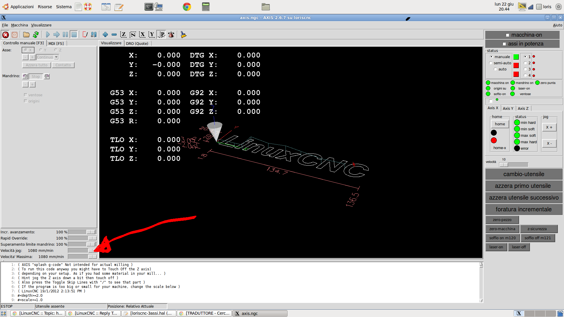

hello I am trying to configure two outer buttons to change the maximum and minimum speed with "halui.max-velocity.decrease and halui.max-velocity.increase" but it does not work

Have you set the scale?
halui.max-velocity.scale
www.linuxcnc.org/docs/devel/html/gui/halui.html
If you don't I suspect it may add or subtract 0 from the current velocity, so nothing will happen.

hello , I have not figured out where to set up " halui.max - velocity.scale " in my file I hal
written so
net max - velocity.decrease halui.max - velocity.decrease < = parport.4.pin - 12 - in
net max - velocity.increase halui.max - velocity.increase < = parport.4.pin - 13 - in
the signal is read regularly by emc2 but does not work I just do not understand . thanks

setp halui.max - velocity.scale <value>
It does work, but the updating between Axis and the underlying linuxcnc values is not immediate.
Also be aware that it is in machine units per second, not the displayed velocity of mm/minute or whatever
Set the scale to 100 and press decrease and you will stop the machine dead, just done it
regards

hello works perfectly !!! Thank you.
you can also configure rapid movements ?
