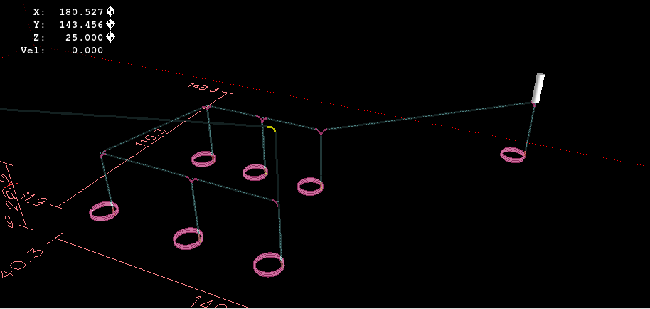

07 Sep 2015 15:25 #62185
by ArcEye
Replied by ArcEye on topic G0 XY move fail
I assume this is what your plot should look like?
I removed the % top and bottom, changed the header so that G40 was applied before the tool change and G43 applied where it should be, immediately after
the M6T? (not after a linear move that will go to the wrong place) and it seems to run as intended.
regards

- looping
- Posts: 96
- Thank you received: 10
07 Sep 2015 19:24 #62195
by looping
Replied by looping on topic G0 XY move fail
Thanks ArcEye
Yes this is exactly my plot.
I didn't dig into tool compensation yet
I don't event know the content of my tool.tbl
I 'll try your code soon and learn tool compensation .
I'll keep you posted
