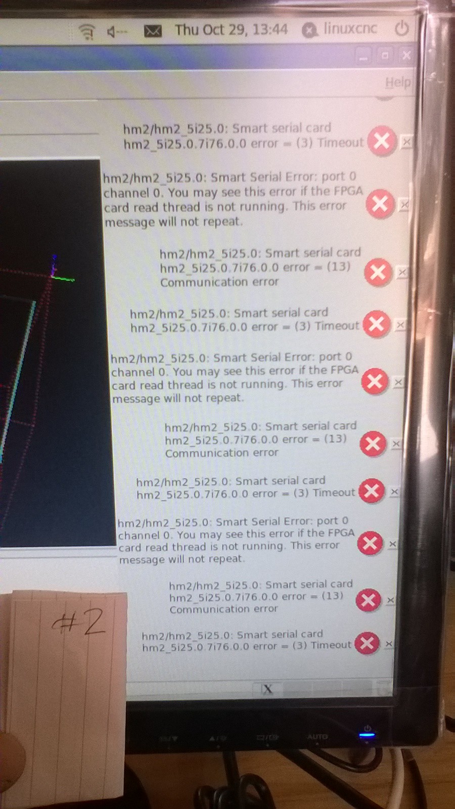

Good day.
Please help.
I have a 4axis machine, and encoded stepper motors (semi closed loop), and we use a 5i25 7i76 combination, computer latency at 25k.
The config loads, and the machine runs beautifully...for a few hours, then stops with a communication error message.
Any advice?
I have tried increasing servo period and the watchdog timeout, but by how much can I realistically increase these?
Thanks.

i'd guess your problem is more interference on the low volts gpio side , and more likely the stability of the 5v supply , make sure you have 5v at the 7i76 if your feeding it from the 5i25
as it's not dropping to say 4.6 v , also check your pci edge connector for dust & dirt .
do you know what version of the smart serial firmware thats loaded , make sure it's up to date

Thats a sserial timeout and is probably not servo thread or watchdog related
I would check
5V at 7I76
24V at 7I76
Cable between 6I25 and 7I76
Is it a IEEE-1284 cable from Mesa or something else?
How long is it?
Is it on P3?
Is the 6I25 jumpered properly for 7I76 cable power mode
I would check
5V at 7I76
24V at 7I76
How long is it?
Is it on P3?

As per E-mails, and explained, this is the client that I am supporting, --Just to reply on your suggestions:
I would check
5V at 7I76- This is very stable. running constantly at 4.99V-
24V at 7I76- Very stable Switch-mode power-supply
Is it a IEEE-1284 cable from Mesa or something else?- We first used the 10Ft cable supplied by Mesa, and now we also tried the 6Ft also supplied by mesa
How long is it?- 6Ft
Is it on P3?- Yes
Is the 6I25 jumpered properly for 7I76 cable power mode - Yes- On 7i76, W2=left(to be supplied with 5v from computer, and on 6i25, W2, and W1=up.
Now, on my Pc, I am busy setting up to simulate Anton's configuration, and dmesg output is as follows:
[109010.741073] hm2/hm2_5i25.0: Watchdog has bit! (set the .has-bit pin to False to resume)
[109010.742174] hm2/hm2_5i25.0: Smart Serial Error: port 0 channel 0. You may see this error if the FPGA card read thread is not running. This error message will not repeat.
[109010.742181] hm2/hm2_5i25.0: Smart serial card hm2_5i25.0.7i76.0.0 error = (13) Communication error
[109010.742185] hm2/hm2_5i25.0: Smart serial card hm2_5i25.0.7i76.0.0 error = (3) Timeout
[109010.766387] hm2/hm2_5i25.0: Smart Serial Comms Error: There have been more than 1 errors in 10 thread executions at least 200 times. See other error messages for details.
[109010.766395] hm2/hm2_5i25.0: ***Smart Serial Port 0 will be stopped***

This means your PC has multi-ms latency some times and causes the watchdog to bite
(if the watchdog bites, all I/O pins revert to input mode so the sserial communications are lost)
I would run a servo thread only latency test to check and go through the standard BIOS setup
and disable all power management and fan speed controls etc
Replied by PCW on topic Mesa 7i76 time out error
[109010.741073] hm2/hm2_5i25.0: Watchdog has bit! (set the .has-bit pin to False to resume)This means your PC has multi-ms latency some times and causes the watchdog to bite

Oh, Just to add to that, it is a brand new system. we are busy building 20 Systems, and we also tried the following:
To get the Latency down, we disabled the Dual processor, and sis alot of settings in bios, and have the latency down to 12000.
We put extra fans on the Computers, and Mesa cards, incase the problem is heat related,
We used different computers, and ended up setting up 5 machines next to each other,
We eliminated the riser card,
We also disconnected the stepper drives, incase there is grounding problems coming from the drives, running the machine with nothing but the 24V is connected to the 7i76,
and spent alot of time trying different scenarios, but ends up at the same point everytime.

Well if the watchdog bites, you are done communicating...
I would try a completely different CPU

I have it currently running on a different PC, and been running for about a hour, errors only start coming out after 2 hours sometimes
