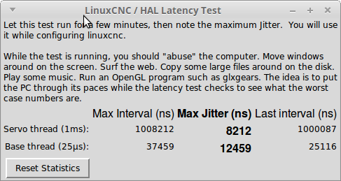

I am very new to linuxcnc and could really use some help configuring a MESA 5i20 (with 7i42TA breakout). I have not been able to get the step gen pins (step and direction) to work. I do not believe I am connecting the wrong pins (been successful with other digital I/O, limit switch, etc., connections). Attached are my hal and ini files. Also attached are the pin assignments (I am fairly certain I have the right pins) and a screenshot of latency test results.
