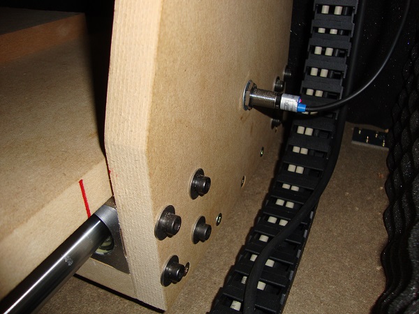

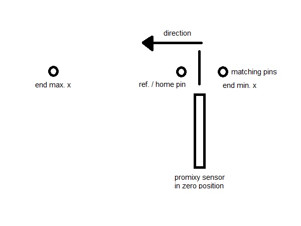

I'm just working on my 2nd cnc router with a few improvements. Actually I don't know how to configure the limit and home switch of the x-axis.
I'm using only at the x-axis one proximy switch NPN for both limit and home. Homing works fine, but when the machine starts to go in the direction to the max. end of the x-axis, ist stops after a few millimeters (15.0 mm) at the point, where the home contact is mounted.
In the baseplate I've mounted 3 matching pins, and when the portal is moving past, the sensor will be activated.
I have pictures for better understanding.
thank you for help.
greetings Thomas

The scheme you propose won't work because the home switch point will be seen as a limit.
What you can do though is remove the home pin and, home to one of the limit pins.
Then if you still want the 0 reference point to be the same as you have it now, add a home offset.

What are the pins? How are they held in?. It is just MDF, can you drill a couple of holes on either side of the pin, then grab it with a needle nose pliers and pull it out?

the pins are made of steal and are hardened, used in mechanical engineering for example. I know 2 kinds of pins, one with thread inside and one without. I've the one without
They are held in by press them in. The diameter of the pins is 6m6 mm. The hole in the plate is 5.8 or 5.9 mm.

The underlying problem is that with only one sensor, no matter how you wire it, the system has no way to know if the sensor is sensing a limit pin or the home pin.
Even if you had two sensors and the pins were on different axes, having a single pin mid-travel as a home pin is a problem because the machine does not know which direction to move to search for the home pin. The only way to get a reliable mid-travel home is to have a long target that covers half the travel.
So, given that there is basically no way that the mid-travel pin can ever be useful you do need to find a way to remove it.
I think I would try drilling a hole at a shallow angle underneath the table to insert a punch from the back to push the pin out.

MDF is very soft and so I decided to drill 2 small holes (3mm) next to the pin on both sides, then I used 2 small screwdrivers and pulled the pin out. All is good
Now I have to mount the limit switches again and I use the promixy switches only for reference again.
