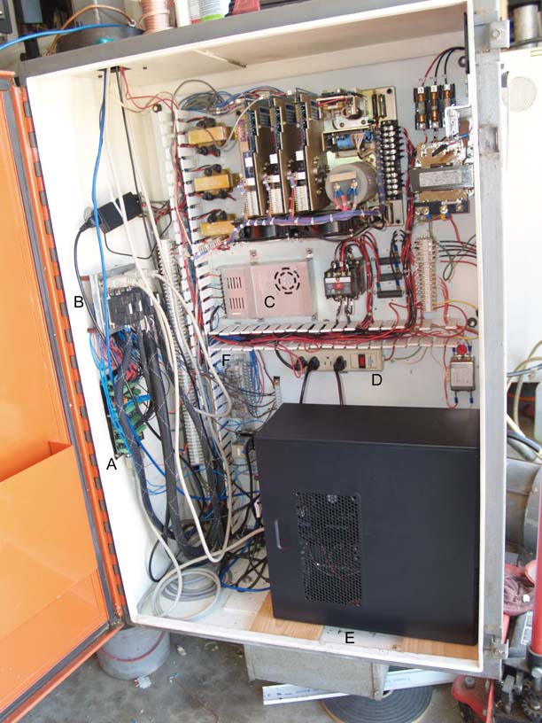

I have my Journeyman Tree 325 retrofit complete as far as the hardware goes. All I have left to do is to tie LinuxCNC into the 7i77 hardware through the hal interface, which is where I could use some help.

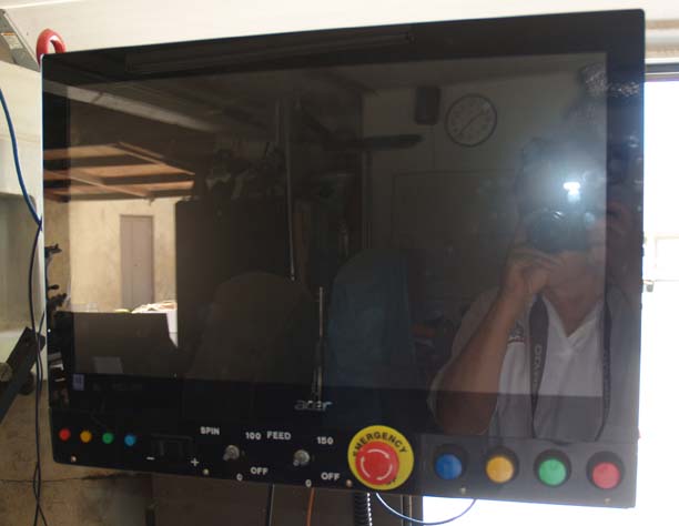

As you can see from the attached photos, in my cabinet I have the Linux PC (E), a 24 VDC power Supply (C), a switched power strip ( D ), the Mesa 7i77 board (A), the original control relays from the Dynapath Delta 20 ( F ) and a connector panel ( B ). My control panel, shown in the second photo, is based upon a ACER T232HL touchscreen monitor. The monitor came with a clear bottom bezel which I machined for the control buttons and then painted the back side black and mounted a rear shield over the bezel to cover the switches. The control panel has a single SPST switch which applies 110VAC to the power strip inside the cabinet. The PC has been modified so that as soon as it sees 110VAC power coming into the power supply, it will boot up so I never have to open the cabinet when I am machining. The switched power strip also turns on the 24 VDC power supply which powers the 7i77 board. I did retain most of the wiring from the original Dynapath controller which was on the mill. This included the relays ( F ) which enable the machine, function the drawbar, handle excess errors, and provide an interlock when the spindle is running. I kept the original wiring harnesses and fabricated a connector Panel ( B ) containing 37 and 15 DP connectors for the original Dynapath cables. I added two 25 DP connectors for cables running to the control panel and the MPG handwheel.
