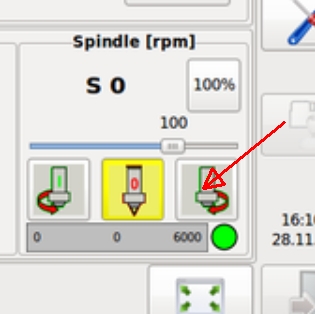

In Gmoccapy - When I click on the icon, the spindle starts to spin without problems.
