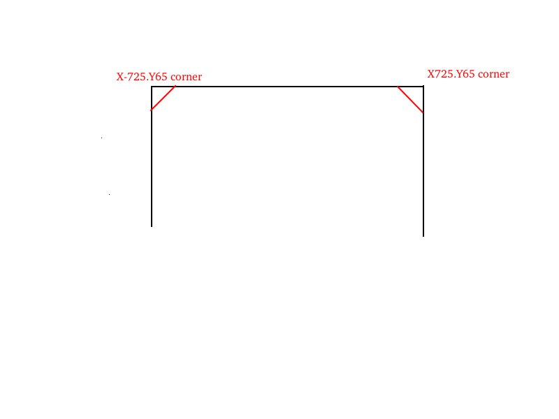

03 Nov 2016 18:19 #82386
by terkaa
Replied by terkaa on topic Absolute linear scales
Today we noticed control cutting corners a lot with G00 moves. We have following G-code:
(current pos X-725. Y-100.)
G00 Y 65.
G00 X 725.
G00 Y -100.
In the first end about 40mm before reaching Y65. X starts to move towards 725. In the other end about 40mm before reaching X725. Y starts to move towards -100. Any ideas why? Attached is drawing of path. Black is what it should be and red is actual:
Tero
G00 Y 65.
G00 X 725.
G00 Y -100.
Tero
