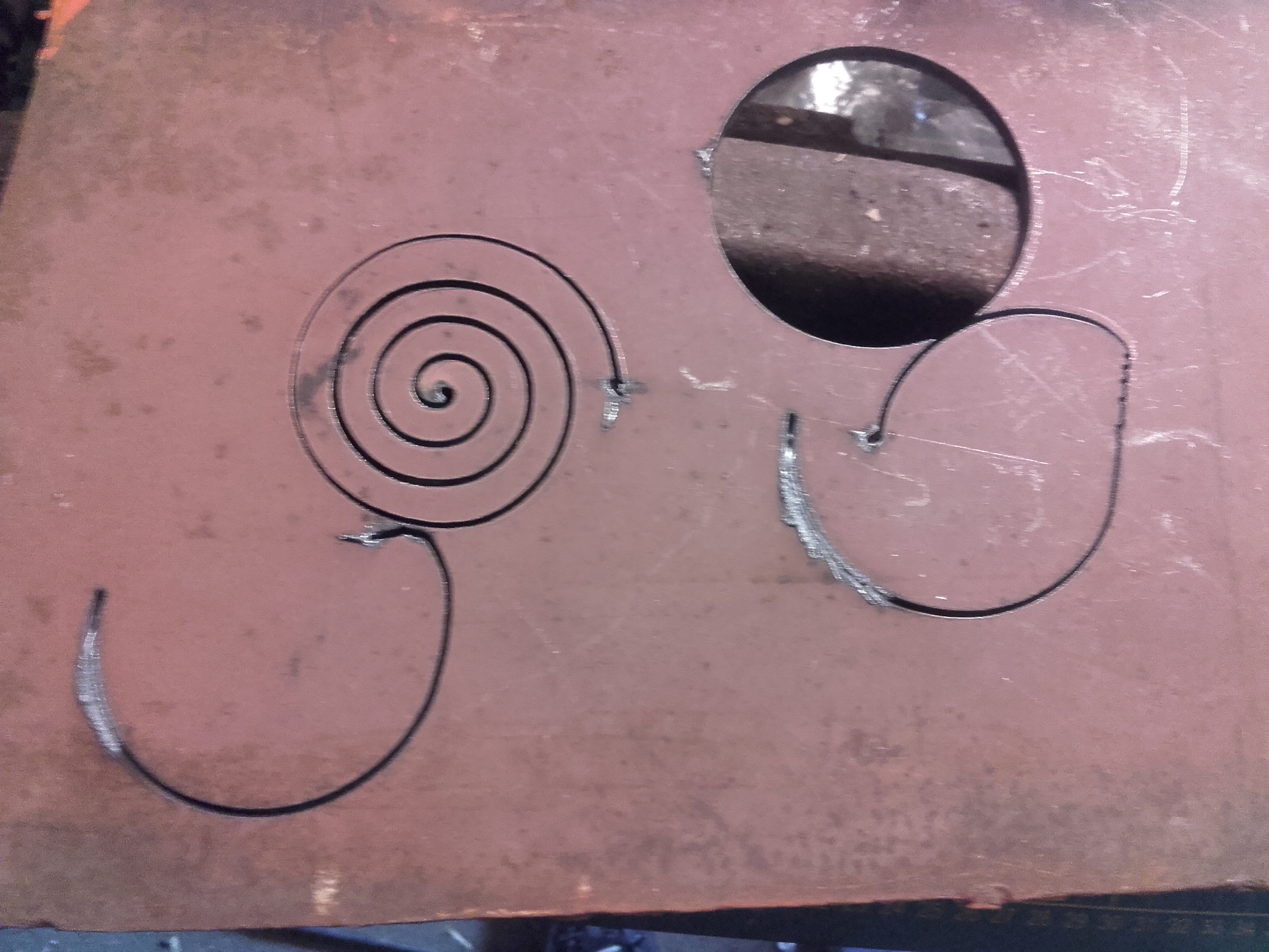

10 Oct 2016 07:08 #81502
by jeroenl
Replied by jeroenl on topic Need some help on configuration Plasma
The first cuts are a fact:
Need to fine tune a lot
But the problem i have is to set the correct value's in stepper config wizard. The demensions are not right.. its about 10 : 6.
My set-up : DM542 stepper drivers , 23Hs9430b Longs stepper motor. GT3 Belt 20 tooth pulley.
I have set the stepper drivers to 400 pulse/rev. So in the wizard i entered the same. + 2 driver microstepping
Pulley teeth : 20 : 1 i am guessing.
Leadscrew Pitch i have no idea how to calculate. The toothpitch of the belt is 3mm
- Rick G
- Posts: 35
- Thank you received: 114
10 Oct 2016 11:02 #81511
by Rick G
Replied by Rick G on topic Need some help on configuration Plasma
I think it is sometimes just easier to make a command move such as 10" and then measure how far the machine actually moved.
Compare the two and see what percentage off they are and then make the correction to your SCALE and measure again.
Rick G
Rick G
- Todd Zuercher
- Posts: 4794
- Thank you received: 1482
10 Oct 2016 11:43 #81514
Replied by Todd Zuercher on topic Need some help on configuration Plasma
If you have a 20 tooth gear on a 3mm pitch rack (essentially what you have on a belt drive) you'd have 60mm/rev. 400steps/rev / 60mm/rev = 6 and 2/3 steps/mm for your scale. (You might what to consider adding further gear reduction.)
- jeroenl
- Posts: 7
10 Oct 2016 12:45 #81517
by jeroenl
That makes sense. Probably up the steps/rev than on the driver.If you have a 20 tooth gear on a 3mm pitch rack (essentially what you have on a belt drive) you'd have 60mm/rev. 400steps/rev / 60mm/rev = 6 and 2/3 steps/mm for your scale. (You might what to consider adding further gear reduction.)
