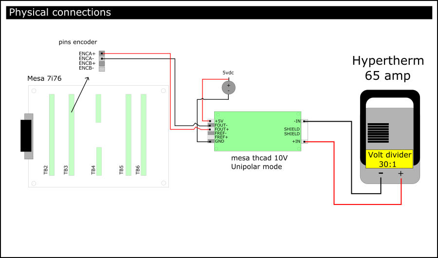

Hello everybody, I am dealing with thcad since three week so far. reading some post I am able to hook it up and it seem to work as I see the current volts from hyperthem powermax 65 in volt-meter widget. the machine is cutting fine with thc disable but when it is enable any correction happened (Z axis doesn't move never). I checked the configuration files lot of times but couldn't figure out where is the error in the configuration files.
I hope someone can help me out.
attached all configuration files
thanks you
thanks you

Did you hook up the ARC OK ?
It is not shown on your diagram.
In order for the THC to work the THC must be on , the velocity must within limits and the ARC OK must be on.
For temporary testing you could possibly unlink the ARC OK pin and set it to positive in Hal.
Rick G

it is not in the diagram but is connected as an input pin. ARK ok is hm2_5i25.0.7i76.0.0.input-20 it is hooked up to Mesa 7i76. You can see it in the .ini
regarding velocity limits how should set it up?
Thanks.
Thanks.
