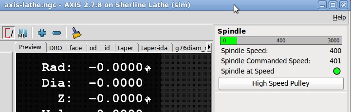

The reason I was having problems was my setup. There was noise on the signal. Things seem to be working once I address this. Thanks for the help.
Question- how do you decrease the number of significant digits on the add on pyvcp spindle speed bar graph in Axis? I want to just display the RPM to one RPM (i.e. XXXX rpm; not XXXX.X rpm). Adding <format>"4.0f"</format> to the <bar> section didn't change anything.
Thanks.
Thanks.

You might be able to do something funky in HAL where the <bar> connected to the spindle is converted from a float to an u32 integer but I suspect the bar will still display the ".0" anyway.
I moved away from pyvcp and defined my "extra info" using Glade. You can define the precision as an integer using the "text_template" property and setting it to %i or any other python format I guess.
Replied by verticalperformance on topic Generating RPM from simple high/low switch- possible?
Not sure if you can. Tried a few flavours of <format> and I think it is not defined for the ttk progress bar, on which I assume the pyvcp <bar> is basedQuestion- how do you decrease the number of significant digits on the add on pyvcp spindle speed bar graph in Axis?

Thanks for the hints. I got it figured out. Solution in this thread.
