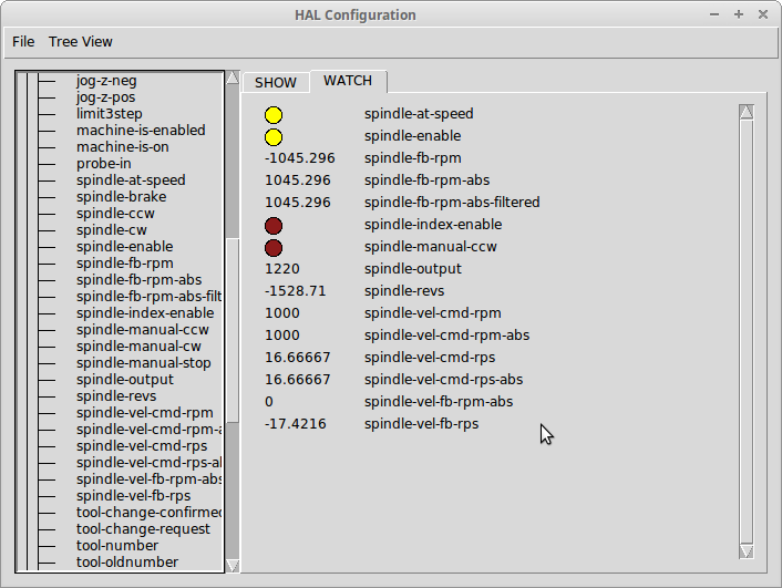

I have converted an Emco Compact 5 to LinuxCNC and I'm using the Mesa 7i76e card.
Almost all is working except it seems it won't perform threading (spindle syncronized motion).
When I program a simple G33 move it just waits forever.
I have hooked up an optical encoder that is giving 100 pulses per rev, plus an index once per rev and I can see them in the HAL configuration, plus I've got the Spindle-at-Speed showing ok now too though I have a very non-linear speed controller...
Looking for help as to what I may have missed.
I.e. what signal is it waiting for that I can check in the HAL configuration?

Replied by PCW on topic Spindle Syncronized Motion (Threading) with 7i76e
Have you verified that the spindle position counts UP by one each turn?
Also the index needs to be checked. if you can disable the spindle drive you should
be able to test both of these things by hand rotating the spindle.
To check the index , either watch or halmeter spindle-index-enable and then
type:
halcmd sets spindle-index-enable true
in a terminal window
Now when you rotate the spindle, spindle-index-enable should go false when the index is detected.

by mikeross
Replied by mikeross on topic Spindle Syncronized Motion (Threading) with 7i76e
using halcmd sets spindle-index-enable true and rotating the spindle by hand I can see spindle-index-enable go false when it passes the index slot.
The weird thing I'm now noticing is that the spindle-revs do not change by 1 per revolution, but rather some random number, turning slowly and stopping at the index I get (per rev) 3.785, 4.3625, 3.7625, 4.105,
turning slightly faster 3.485 2.8075
faster still and trying my best to stop at the index:
1.5675
1.005
(actually they are negative values - see screen shot)
so there is something wacky going on. The optical pickups are just cheap-o units intended for use with arduino's, there may be reflections or some other thing causing the eratic behavior.
I'll try getting the machines original pickups working - and then I'll let you know if I can get the spindle sync going.

I have resolved my encoder issue and now I can see the spindle-revs increment by 1 per full revolution and by 0.01 for each encoder slot (actually they decrement - shows negative values for spindle-revs). Also the spindle-index-enable goes to false once the index passes it. Bu t I still can't get any motion when trying a g33 or G76 (I've tried the g76.ngc example to no avail - works right up to the threading section.
What to check next?
Does the negative spindle-revs value mean that its configured for rotation in the wrong direction? This machine can only go forwards as it stands now.

I just checked by using M4 instead of M3 and I get motion, so I just need to figure out how to invert or absolute the signal.
You can reverse by changing the sign of the spindle encoder scale (from 100 to -100)
You can also reverse in hardware by grounding the encoder "B" input
(since you are using the encoder counter in up/down mode, the B input sets the
count direction and defaults to high = count down if unconnected )

Changing the encoder scale to negative worked. Thanks for your help.
