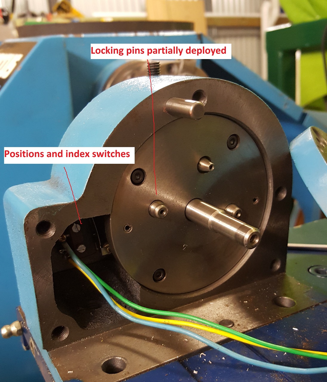

I'm retrofitting a small CNC lathe (Hercus PC200) and I need some pointers on getting the turret going with Linuxcnc.
It's an 8 position tool turret driven by a DC gearmotor.
When the motor is rotating forward, the turret rotates.
There is a position sensor for each tool position (actually a single NC switch with a dimple causing switch trip near each tool position)
There is an index sensor (NC switch).
To lock, the motor is reversed, this drives 3 locking pins backwards. These have to line up with a plate which holes in it. The pins hit a plate when fully out, completing a circuit (locking sensor).
(Thus the turret can only rotate in one direction)
So it's a similar turret to many others that use a rotate then reverse onto a pawl. The difference is that the locking requires the locking pins to line up with the lock holes. The pins do have a taper on them to deal with some misalignment.

Locking plate/holes - behind the plate is a brass plate with a wire connected. The plate is otherwise isolated until the pins touch it.
Locking pins partially deployed
27 Sep 2017 08:32 #99518 by johnmc1
Replied by johnmc1 on topic Lathe tool changer turret - DC motor based
Good day,
Why is the centre pin tapered, maybe it is has something to do with helping centre the lock pins?
john
27 Sep 2017 15:34 #99528 by pippin88
Replied by pippin88 on topic Lathe tool changer turret - DC motor based
John,
It may be for that reason. That pin seems to come further out and appears to be the one that makes contact with the brass plate.

06 Oct 2017 22:28 - 19 Oct 2017 16:31 #100032 by pippin88
Below code works on my machine. Slightly different approach from code posted earlier, as I worked out a bit more about how the turret works mechanically and under the old controller.
LinuxCNC HAL component to implement ATC toolchanging on Hercus PC200 Lathe
Based on "EMC2 HAL component to implement ATC toolchanging in Denford ORAC CNC lathes" (c) ArcEye 01122011 schooner30@tiscali.co.uk
Modified by pippin88 - 07/10/2017
All values are metric
Version 0c -  The PC200 toolchanger has an 8 position unidirectional turret. There is an index sensor (PC200changer.index),
              and a position sensor (PC200changer.pocket) that pulses once per tool position.
  			      When the motor moves forwards, the turret rotates forward.
              The position sensor does not line up exactly with the actual tool position, but is past the tool position a bit
               - the turret reverses until the spring-loaded pins line up and jump into the locking holes.
              When the locking pins are fully deployed, they close a circuit (PC200changer.lock)
              The turret uses a simple DC motor. This is driven by an H-bridge (L298N) which takes two input signals to determine direction.
              motor A and motor B. A HIGH, B HIGH = motor off; A HIGH, B LOW = motor forward; A LOW, B HIGH = motor reverse; A LOW, B LOW = motor off;
              I use A HIGH, B HIGH for off, as this is less susceptible to noise than a resting LOW state.
               Compile the component with 'sudo comp --install PC200changer.comp'
               Below .hal file extracts give a specimen .hal connection guide. Place them as appropriate in .hal file

        case 1: // HOMING SEQUENCE
                // Turn motor forward
                motorA = 0;    //    "Motor input A";
                motorB = 1;    //    "Motor input B";
                // use a state machine to detect the index pulse only once
                indexState = index; // read the index sensor input pin
                if (lastindexState != indexState) { // compare the indexState to its previous state
                      if (index == 0) {   // if the current state is LOW then the index went from ON to OFF - FALLING EDGE
                          turretposition = 8; //Set Tool Pocket 1
                          turrethomed = 1; //Set turrent homed flag
                  			  if (reqtoolnumber == 8){
                              progresslevel = 4; //move to locking sequence
                  			  } else {
                  			     progresslevel = 2; //move to motor forward sequence
                lastindexState = indexState; //store indexState for comparison next time around
                break; // index not triggered - get out of case 1 and go round again
        case 2: // UNLOCKING - use first pocket pulse to show that turret unlocked, and to prevent that first pulse counting as a position increment
                // Run forward - need to clarify pins etc
                //use a state machine to detect pocket sensor
                unlockState = pocket; // read the pocket sensor input pin
                if (lastunlockState != unlockState) { // compare the pocketState to its previous state
                      if (pocket == 1) { // if the current state is HIGH then the button went from OFF to ON - RISING EDGE
                          progresslevel = 3;
                lastunlockState = unlockState;    // save the current state as the last state, for next time through the loop
		            break; //get out of case 2 - - go round again
        case 3: // FORWARD TOOL FIND SEQUENCE - Forward move until desired tool position
                if(turretposition==0) { // if returning 0 something is wrong - should be homed and at pocket 1 at least
                      rtapi_print_msg(RTAPI_MSG_ERR, "Error - counter error");
                      progresslevel = 12; // doesn't exist so will go to default, output msg and then sit in level 10
                      break;
		            //use a state machine to detect pocket sensor once per position only
                pocketState = pocket; // read the pocket sensor input pin
                if (lastpocketState != pocketState) { // compare the pocketState to its previous state
                      if (pocket == 0) {   // if the state has changed, increment the counter
                      // if the current state is LOW then the button went from ON to OFF - FALLING EDGE
                          turretposition++; //increment tool position counter
                          if(turretposition > 8)
                          turretposition = turretposition - 8; //we have gone round from 8 to 1
                lastpocketState = pocketState;    // save the current state as the last state, for next time through the loop
                if (turretposition == reqtoolnumber) {
                      progresslevel = 4; //move to case 4
                break; //get out of case 3 - go round again
        case 4: // LOCKING SEQUENCE
                // Reverse locking move
                motorA = 1;    //    "Motor input A";
                motorB = 0;    //    "Motor input B";
                //use a state machine to detect lock sensor once only - detect falling edge
                lockState = lock; // read the pocket sensor input pin
                if (lastlockState != lockState) { // compare the pocketState to its previous state
                    if (lock == 0) {   // if the state has changed, increment the counter
                      // if the current state is LOW then the lock circuit has grounded
                      //Turn motor OFF
                      turretislocked = 1;
                      progresslevel = 5;
                lastlockState = lockState;    // save the current state as the last state, for next time through the loop
                break;  //get out of case 4 - go round again
        case 5: // clean up ready for next toolchange
                //sleeptime = 0;
                progresslevel = 6;
                toolchanged = 1;   // signal finished
                break; //get out of case 5 - go round again
        case 6:
              //if(sleeptime < 1)
              //      sleeptime++;
              //      break;
                progresslevel = 0;
