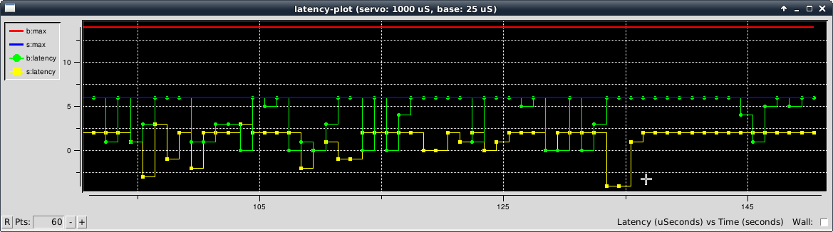

10 Nov 2017 18:11 #101623
by Domsku
Replied by Domsku on topic Stepper does not turn on Mesa 6i25 with 7i76 and Leadshine M542T
So, as I understood, the speed limiting factor in my settings is the SERVO_PERIOD = 5000000 (nano seconds). And if I want to speed up max. velocity, I need to reduce this value, correct?
After checking the latency of my computer (latency-plot is attached) I set the servo period to 30000. Result was, that my computer got stuck, as soon as I tried to run LinuxCNC. So I put it to 50000. That helped, but LinuxCNC complained about a realtime error. After changing servo period to 70000 everything works fine.
Now, my max. step rate should be 1/(70000 x 10^-9 sec.) = 14285 Hz and with 80 pulses per mm I would get a max speed of 14285 HZ / 80 pulses/mm = 178.6 mm/s.
Did I get it right or is there something I forgot? I still didn't test it with my hardware.

10 Nov 2017 18:33 #101624
Replied by Todd Zuercher on topic Stepper does not turn on Mesa 6i25 with 7i76 and Leadshine M542T
Generally for a hardware stepping machine the servo-thread should be left at the default of 1000000. When using Mesa hardware the thread speeds in Linuxcnc do not really have any thing to do with the maximum speed that your motors can move. That is all handled in the Mesa hardware and controlled by the pulse and space length settings mentioned by PCW. Changing the servo-thread speed only changes the interval when Linuxcnc does it's calculations and if set to small can lock up the computer (like you found.)
The following user(s) said Thank You: Domsku

10 Nov 2017 18:33 #101625
Replied by PCW on topic Stepper does not turn on Mesa 6i25 with 7i76 and Leadshine M542T
The servo period has no direct effect on the maximum step rate
( step rates to about 4 MHz are possible with your hardware, and this is independent of the servo thread period )
The default servo period is 1000000 ns (1 ms) There is normally
no reason to change this so I would restore this value to your hal/ini files
