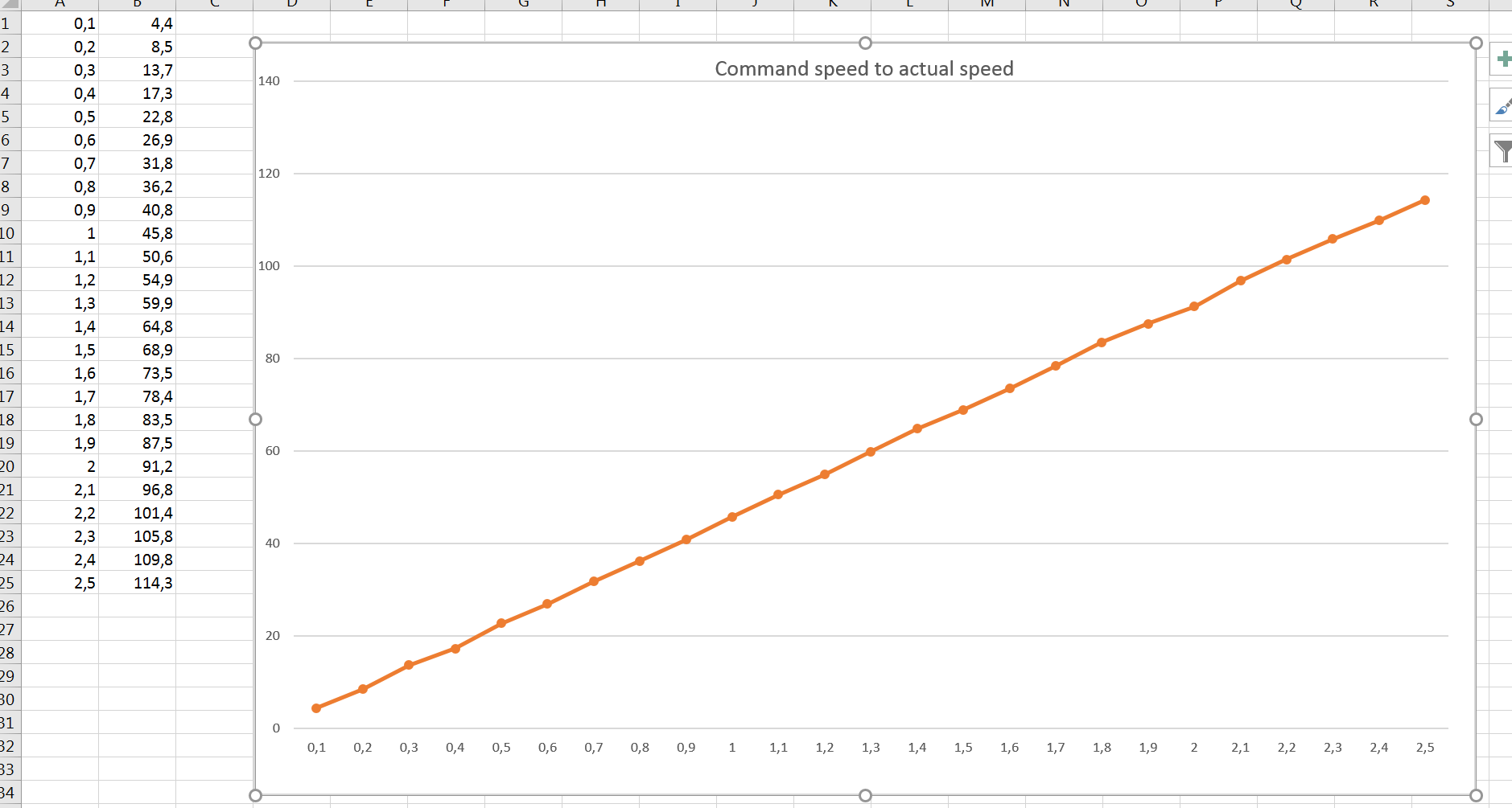

I tried that and it went reasonably well. I had to set up the f-error to some big number because it was easier than disconnecting enable from the loop.
Based on plotted command voltage in V on actual velocity in mms^-1 I would say that it is not so bad:
But I discovered that I haven't had zeroed input gain properly. And I don't know if I will ever be able to completely zero it for motor to stop. It is still moving one count in couple seconds. How big problem it is going to be?

Slow drift on analog velocity mode drives is normal and harmless
Once the PID loop is closed the drives cannot drift
Also the drives should not be enabled unless LinuxCNC is running
and in control of the position loop (except for this kind of testing)

The motor seems to be a lot stiffer than before because of the zeroing of the input gain. Before I was able to move the shaft about 20 counts out of position, but now I can only about 2 counts before the system will put enough force to overpower me. I probably zeroed it when PID calculation was running with nonzero P which caused faulty "base" zero. To actually turn off PID is good advice and I think should be included servo tuning howtos.
