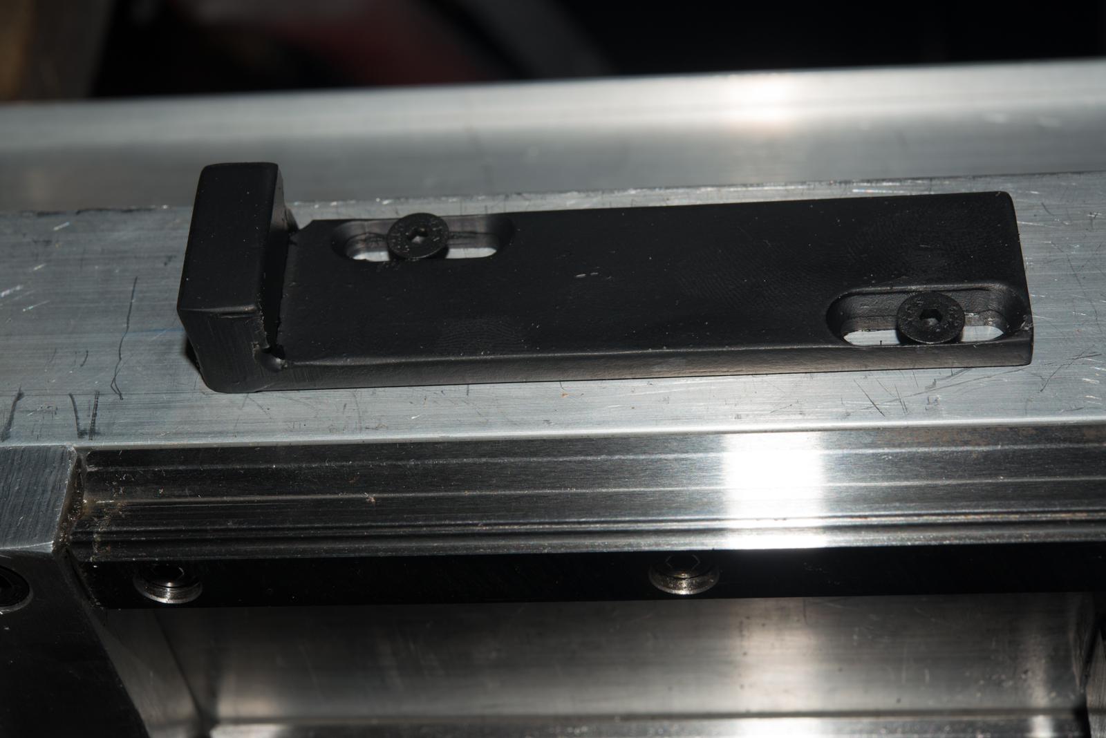

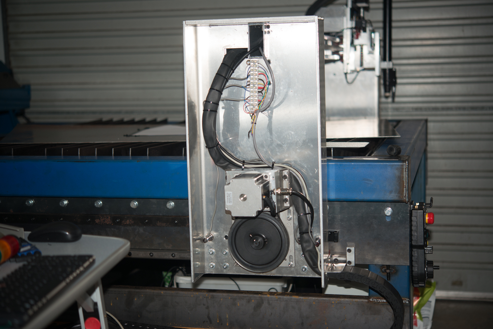

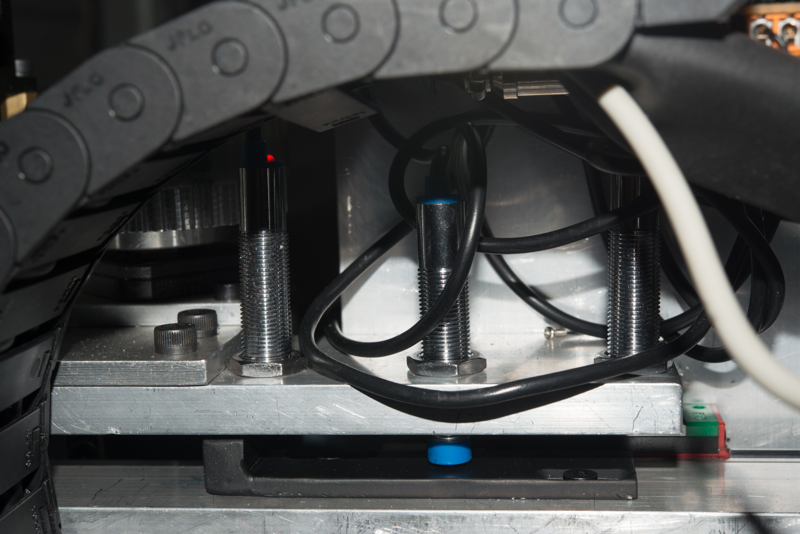

At times like this, I always start at the beginning in halshow to make sure the signals I am using are turning on and off as expected.
I would make sure that the home switch is actually where you think it is. I changed my machine geometry around and realised that I'd inadvertently swapped the stepper wiring plugs around so the home switch was on the wrong side to the stepper and I had similar behaviour to what you describe... It was hard to debug as it had been working before but when I really slowed down the velocities, I could see the problem.
Also, I found that the prox switches required to be enabled while the machine decelerates to a stop. This is why I devised limit switches that looked like this with 100 mm of travel so it could come to a stop
3 prox switches mounted on the gantry.. Outer ones are limit switches and inner one is the home sensor.
This worked so well I mounted them on the gantry in exactly the same way.
You can see the limit switch plate poking out to the right and the home prox switch hiding on the left of the black cable with the limit switches on the outer edges of the gantry .
Your ini homing settings look OK to me. Here is mine
EDIT: Its worth noting on the second photo that the HOME_OFFSET has moved the gantry away from the edge of the sensing plate where the home position was sensed to use as much of the gantry travel as I could without the limit switch being triggered.
HOME_OFFSET = 45
HOME_SEARCH_VEL = -100
HOME_LATCH_VEL = 10
HOME_FINAL_VEL = 50
HOME_USE_INDEX = NO
HOME_SEQUENCE = -1EDIT: Its worth noting on the second photo that the HOME_OFFSET has moved the gantry away from the edge of the sensing plate where the home position was sensed to use as much of the gantry travel as I could without the limit switch being triggered.
Last edit: 24 Jan 2018 19:11 by rodw.

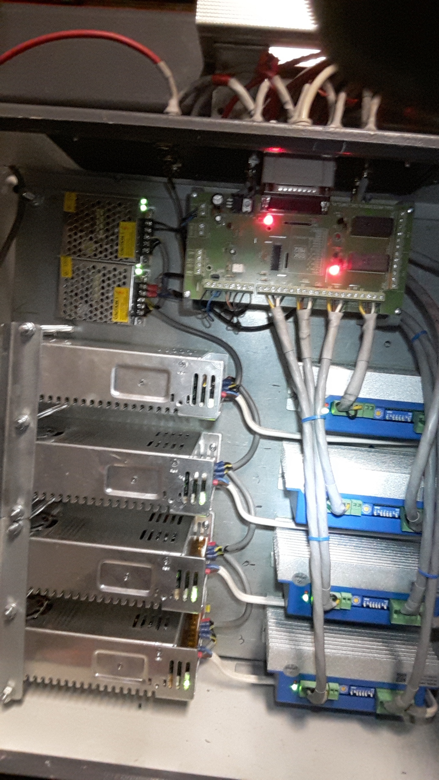

24 Jan 2018 20:16 - 24 Jan 2018 20:22 #104953
by denhen89
Replied by denhen89 on topic How to connect Home switches for dual motor on 3 Axis machine [2.8 Pre Master]
So, thanks guys, i have some information and i think after those information you will be able to tell me if i need an resistor or not, but i will need to edit the post soon to add some pictures via smartphone, but i will explain as good as possible.
So, my proximity home switches (PND NO) are connected seperatly. Each switch has its on terminal where the Black signal wire goes in. The switches need 6-36 VDC. I use an external 12V/3A PSU for the Limit switches, because the BOB gives only 5V on this terminal block, so there is only the Estop connected to 5V and GND.
Switches have 3 Wires. Black, Blue, Brown.
Brown goes to + on Supply,
Blue goes to - on Supply.
Black goes to BOB.
Blue wire from - Supply goes to GND of the BOB.
The Terminal-block from left to right (on the picture its not visible due to the connected wires):
HMA+, HMA-, GND, 5V, Z HOME, Y HOME, X HOME, E-STOP
X Home is connected to X Home terminal
Y1 Home is connected to Y Home terminal
Z Home is connected to Z Home terminal
Y2 Home is connected to HMA+ terminal
one (blue) wire is connected from HMA- terminal to GND terminal (blue wire, see picture)
I checked if the wires from the home switches are nowhere broken, by checking volt from GND to HMA+, Z Home, Y Home and X home.
When switch is off, there is 0V, when switch is on there is 15V. (Y2 home gives exactly 15.00V, Y1 home gives 14.25V.)
No the problem or what is actually going on:
Like i already wrote in my last post, the Y2 switch does not change from TRUE to FALSE when it gets triggered, it always stays on FALSE like it would be triggered (dont understand why the Y2 motor even moves if it is on FALSE, because Y1 stops if triggered switch and is on "FALSE".
Next thing i did, was to take of the BLUE wire which connected terminal HMA- and GND, and then Y2 Home switched from FALSE to TRUE, but now is stays permanently on TRUE and not anymore permanently on FALSE.
I am not sure if that means that i need an Resistor only on that switch?
EDIT: Mike_Eitel, yes i am using an Parallel Port BOB. The switches are connected to an external 12V/3A PSU.
Not sure now if i need an resistor on the Y2 Home switch (HMA+ terminal). If so, which one, pull-up or down resistor?
Black goes to BOB.
Last edit: 24 Jan 2018 20:22 by denhen89.

24 Jan 2018 20:44 #104956
by Mike_Eitel
Replied by Mike_Eitel on topic How to connect Home switches for dual motor on 3 Axis machine [2.8 Pre Master]
I'm puzzled.
I have severe problems to see 15V ( from a 12 V PSU ????) on a printerport input! Killer!
My feeling is that you have had good luck(until now) not to burn your printerport!
Maybe as your psu is not ground connected to bob?
Or is it a galvanic separating bob?
If you really have to feed sensor with more than the allowed input level, make it by a usual trick of the tiny voltage regulator 78H05. vdd= input is your black wire, gnd is your gnd, and output of regulator drives a f.x. 1k resistor to gnd, parallel to your bob input.
