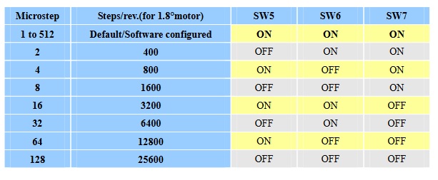

Got the router to load and excute code now but my dimensions are off when I move 1.2m it only move ~80cm.
I have used stepconf to set the router up, microsteps are set to 8 on drivers and in software and the pitch for the ballscrews is correct as well.
I have scale = 320 for my 1604
scale = 400 for my 1605
1:1 drive, been moving up and down the axis repeatability is good just dimension are out. I have stall protection (AM882 drivers).
Any ideas?

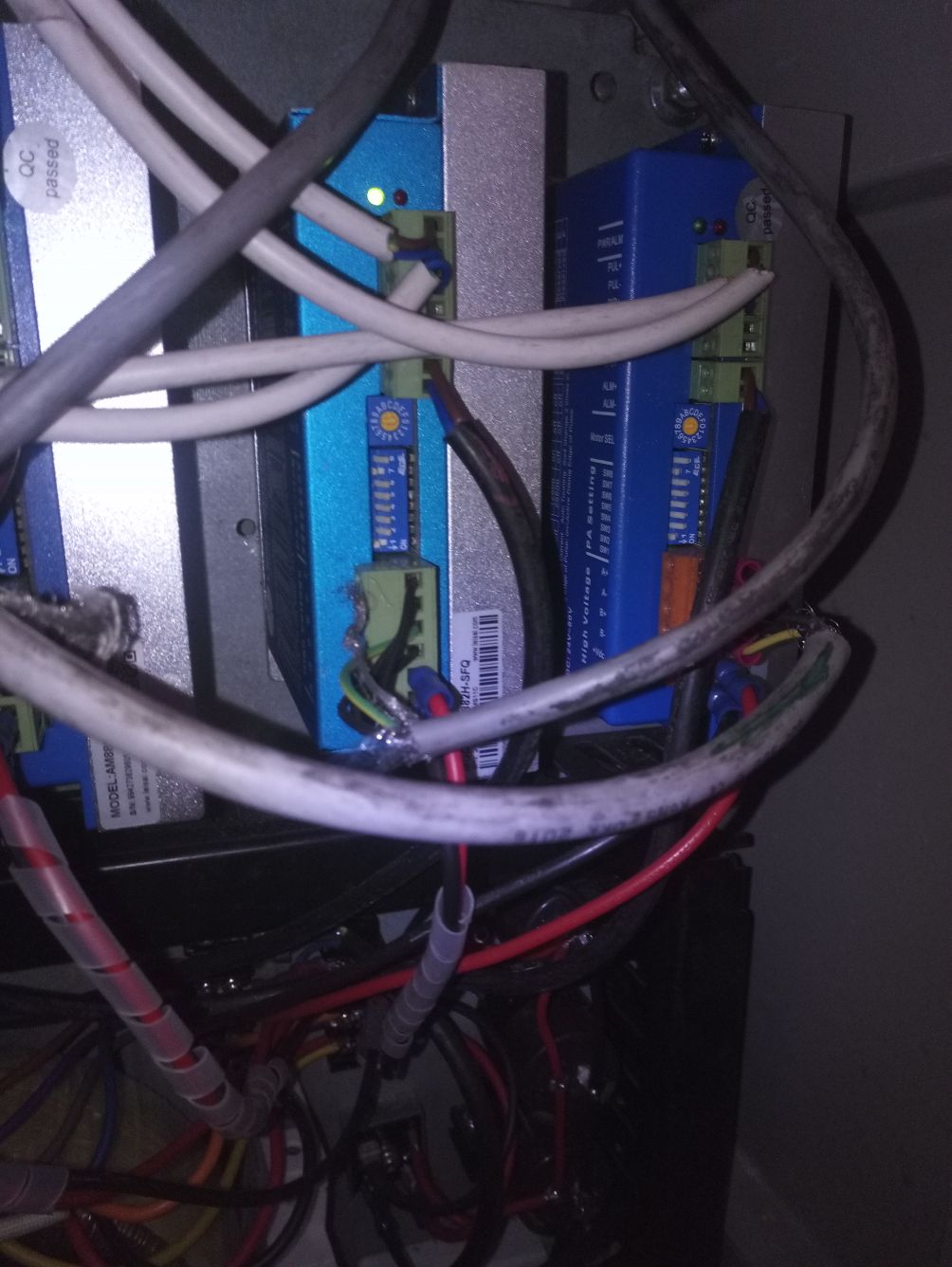

Hi I mixed the numbers up in my post I had it set to 320 for 5mm and 400 fot 4mm pitch.
I've realised it's exactly 1/2 (Not sure where I got 85cm from lol) so I changed in stepconf the ratio to 1:2 and now everythin is spot on.
Will post my .ini tomorrow see if I can work out why
But importantly it works now upgrade so I can have another go at homing with 2 switches and 2 motors on 1 axis.
This is my Jumper settings
This is from the AM882 manual

Problem solved, if you look closely at my jumpers you will see I have them the wrong way round, so off is on and on is off. This meant my microstepping was set to 16 NOT 8.
