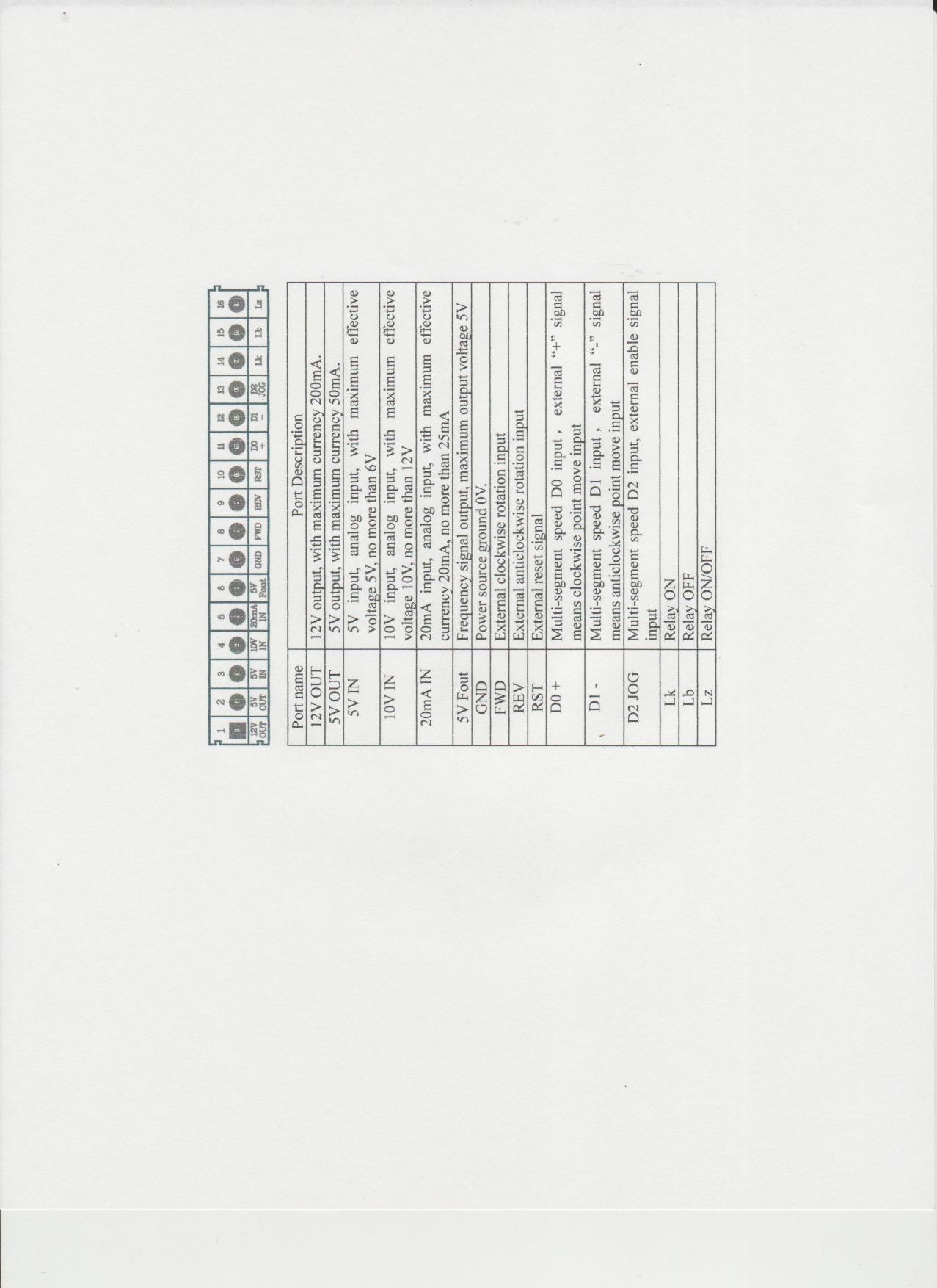

I have been looking everywhere for this information with no luck.
The vfd says that it is a Huanyang vfd but it is in fact an Isacon which has the same configuration as the askpower vfd's out there.
The manual is not much help so I'm hoping someone else is using one of these and can hopefully point me in the correct direction.
I am trying to run a water cooled spindle 400hz 2.2KW with the 2.2kw 3hp VFD. I have an ST-V2 breakout board and I also have a RS-485 to usb adapter. I have tried without success to connect the vfd to the breakout board using the 0-10v connections and the spindle relay. Not sure on how to write the custom.hal file for that scenario.
I have also tried to connect via the RS-485 usb connection and I am not sure which terminals on the vfd should be connected.
There seems to be good information on what to do with the custom.hal file for that scenario.
The terminal page is attached.
The VFD and Spindle work as they should in manual mode. But I want to be able to control the spindle through Linuxcnc.
I'm sure my inexperience is most of the problem . Any and all help would be greatly appreciated.

It doesn't appear that the VFD works with Modbus, so I think you will have to use 0-10V
Do you have a 0-10V variable voltage coming out of the break-out board?

Thank you for the speedy reply. Yes the ST-V2 Bob has 0-10v power supply which i believe controls the speed of the spindle. I will check the output voltage this afternoon to make sure it is correct.
Correct me if I'm wrong but I'm under the impression that I have to use a relay for Off/On also?
I am not sure what to put in the custom.hal file with this set up.
Bill

That will depend on the putput driver of your BoB. Some will work directly.
