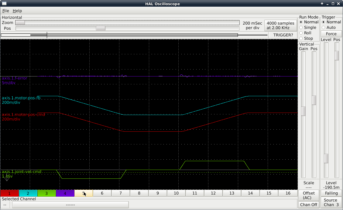

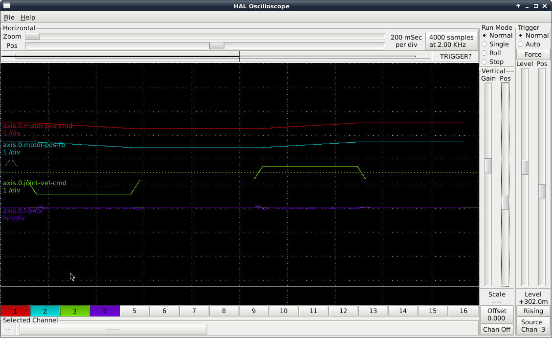

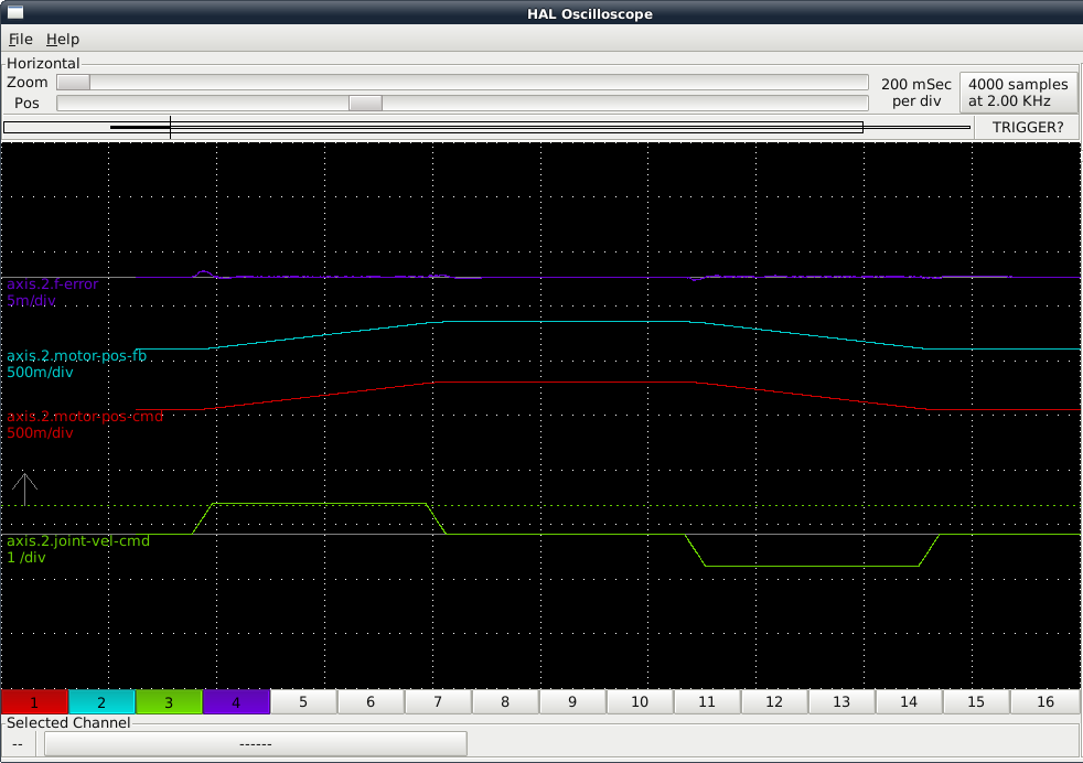

08 Apr 2018 17:55 - 08 Apr 2018 17:59 #108616
by DeckelHead
Replied by DeckelHead on topic What represents, or what should I expect from, a well tuned servo system?

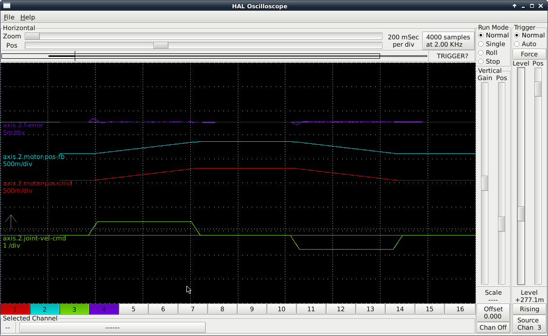

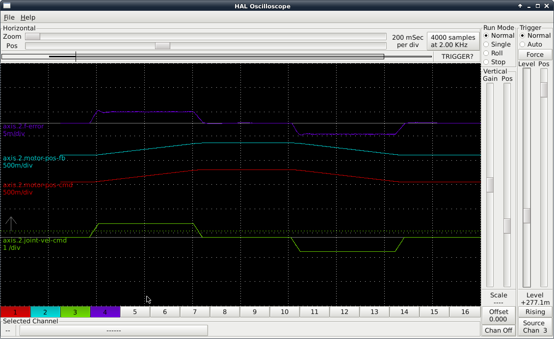

First off...Wow! setting DEADBAND to zero made my machine sooo much quieter! Instead of a rumble/buzz/whatever, now it is very quiet, almost like a fan blowing gently. Interesting.

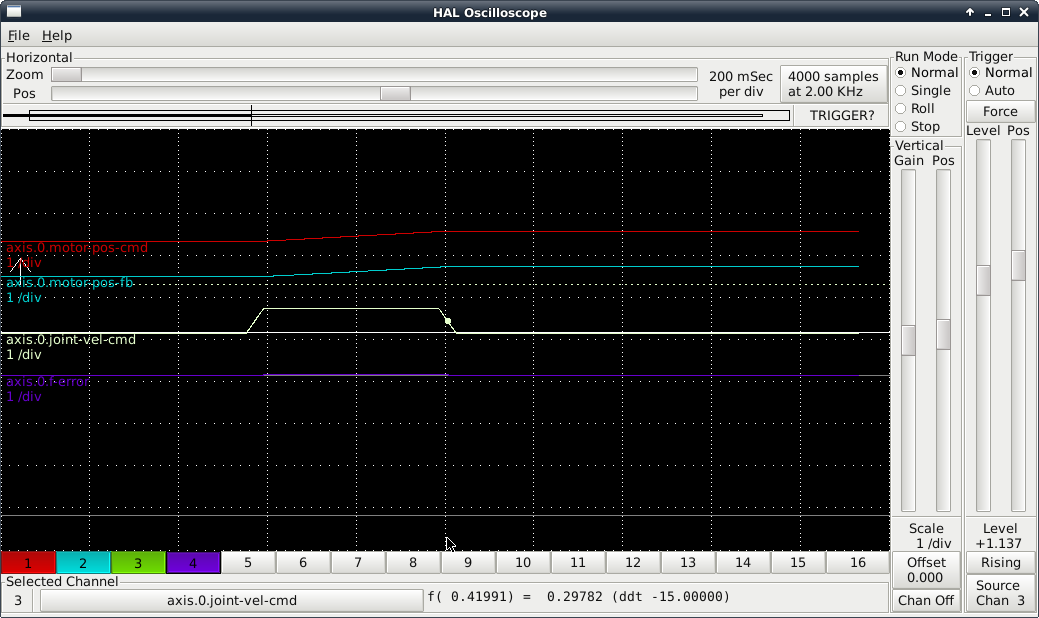

OK, I've attached files for the X, Y and Z axis. I did all of these because I suspect that my Z axis tuning was all messed up too, even though it seemed to be good. All in all, however, the graphs look suspiciously good. No ringing with the f-error (BTW, what is the difference between ERROR and FERROR?). I've also included the INI and HAL files, although not the pendant HAL file because I didn't think it would be germane. If it is, then let me know. You'll see some stuff commented out in the HAL which I still need to work on. There was contention with the pendant HAL that I have to resolve but it not relevant (IMO) to the tuning work. OK, so without further adieu....
All movement was done by toggling back and forth between G1 F60 X-3.5 Y7.5 Z6.5 and G1 F60 X-3.75 Y7.75 Z6.75 so, of course, a 0.25" span. However, all sliders, including feed override, were at maximum (I'm thinking that it would max at the INI setting of 60IPM though anyhow).
So, that is the baseline. I had to put a value in there for FF1 or the axis would not even move. I know of no suggestion on what I should put there to start with, however, so that might have been a mistake (?). I'm also happy to say that my machine gun syndrome has disappeared with these initial settings and the axis position indicators are rock solid even at 0.000x.
Last edit: 08 Apr 2018 17:59 by DeckelHead.

08 Apr 2018 18:33 - 08 Apr 2018 18:34 #108620
Replied by PCW on topic What represents, or what should I expect from, a well tuned servo system?
A couple things:
1. You should _not_ need FF1 to cause motion (a P value of 50 means a 10V output with a 0.200" position error)
If you do, something is very wrong with your basic setup (the large deadband could certainly do this)
2. Assuming the default +-10V analog scaling FF1 should be 10/Velocity@10V (velocity in machine units per second)
the other way to deal with FF1 is to normalise the PID values by setting the analog output scale to machine velocity @10V in this case FF1 is 1.00
3. You need to set the halcope scale for the ferror much smaller so you can actually see the error

08 Apr 2018 19:42 - 08 Apr 2018 19:45 #108621
by DeckelHead

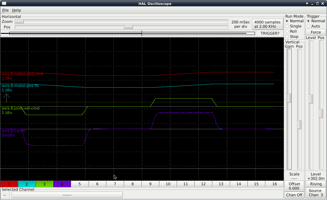

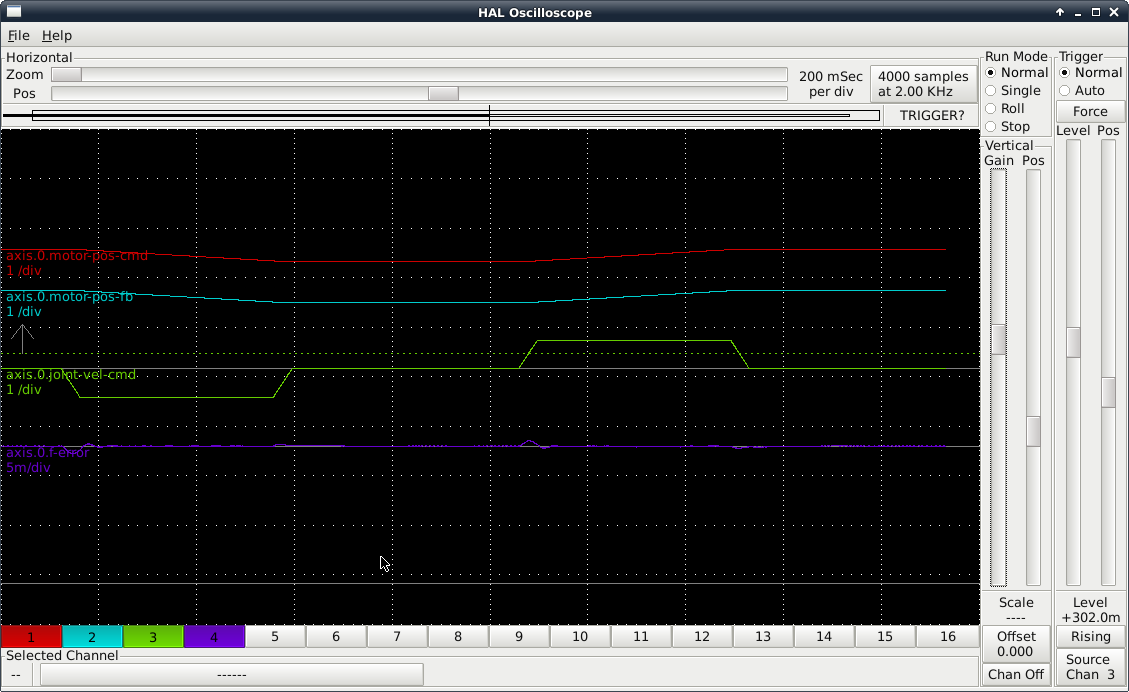

I realized that my scaling on the f-error was bad and fixed that. Sorry. I can also confirm that FF1 is not needed to jog. I have zero idea why that was the case before. I'm scratching my head on that but can only assume it was a combination of user error,ignorance, and maybe some other lever that was incorrect.
The good news is that I think I am getting how the different levers work to change the output. To that end, I tuned my X axis and have included scope outputs again. I had to use FF2 to center the ringing because I was unable to eliminate it completely. The FF1 file is after FF1 was set, and the FF2 file was after that variable was set.
The final Z settings are as follows:

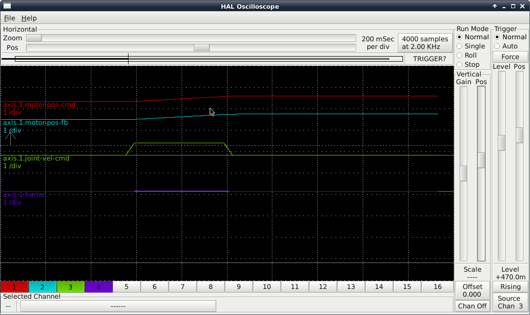

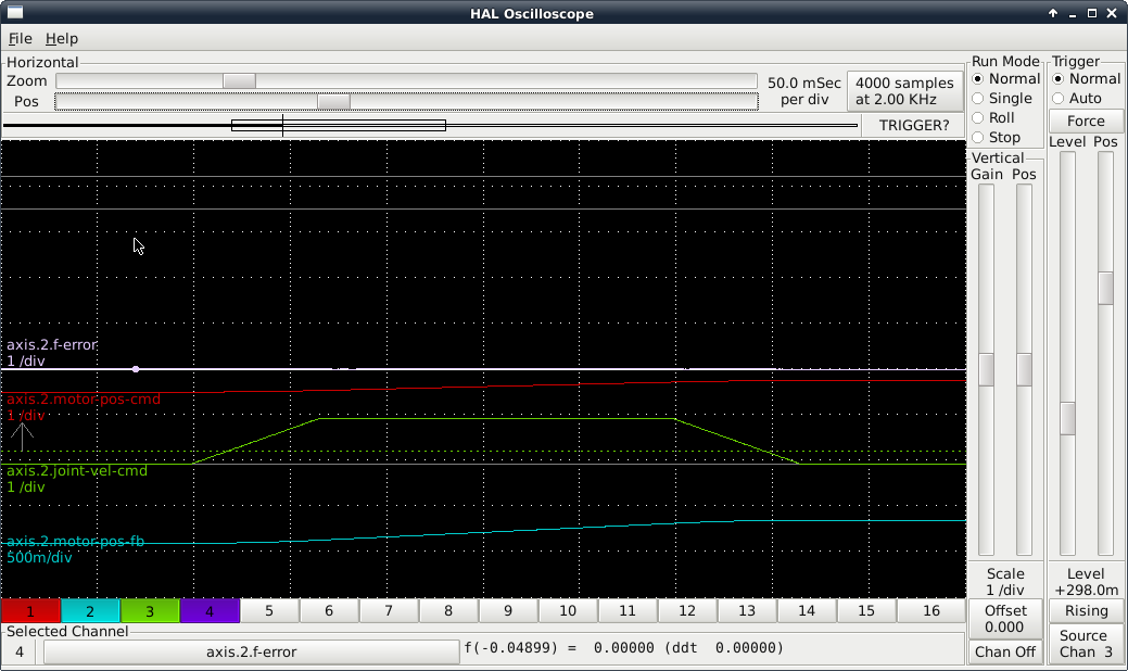

- DeckelHead
- Posts: 166
08 Apr 2018 20:21 #108622
by DeckelHead

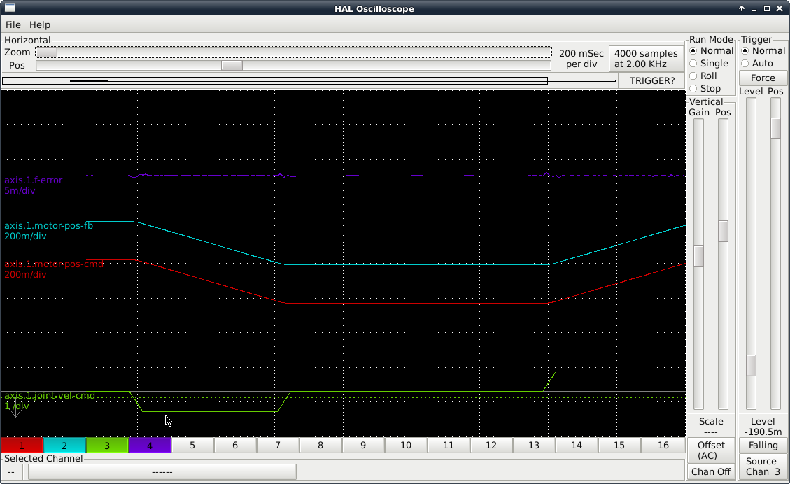

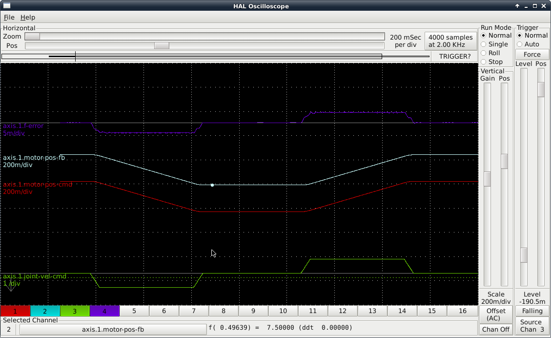

Here are the plots and info for Y and Z. I find the fact that the FF1 and FF2 to be almost identical for all three axis to be suspicious. But maybe that is normal (same motors, same drivers... still, strange). Also, the FF1 was higher than I expected, based on the information in the tuning tutorial. Anyhow, here are the settings and screen captures:

As I said before, assuming the default +-10V analog scaling FF1 should be 10/Velocity@10V
so will be close to the same for all axis if they have the same drives/ analog command--> velocity scaling
Your (tuned) FF1 of 2 means that you have a machine that would move at 300 IPM (5 IPS) at 10V
