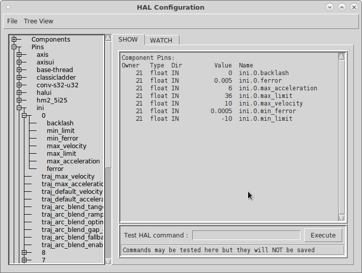

But it maybe possible within a running Linuxcnc to test new values. Depending on the version of Linuxcnc you have installed it may be possible to look at and change the values of some ini settings as hal pins, including the soft limits using Hashow.
Then using the Test Hal Command box you could setp the pin for the ini value you want to change. Just remember that any changes will only be in effect for that session of Linuxcnc it will not be saved to your ini file. You still must edit the ini file to make a permanent change. (Also remember changes you make to your ini file have no effect on a session of Linuxcnc that is currently running, you must exit and restart Linuxcnc for changes to take effect.)
