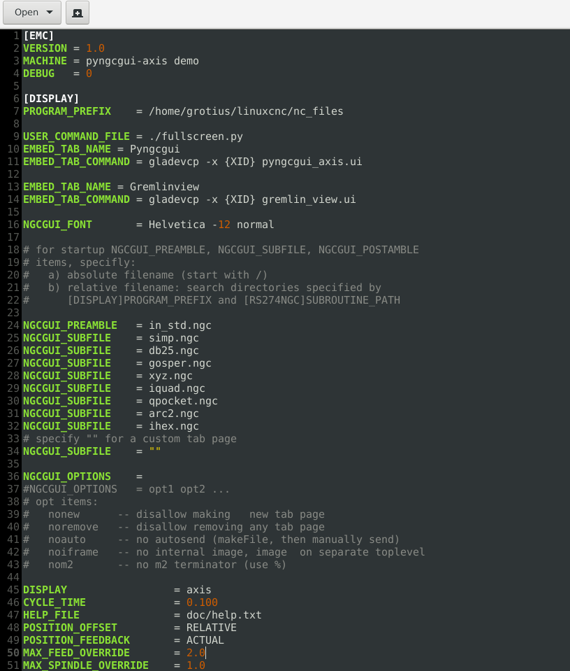

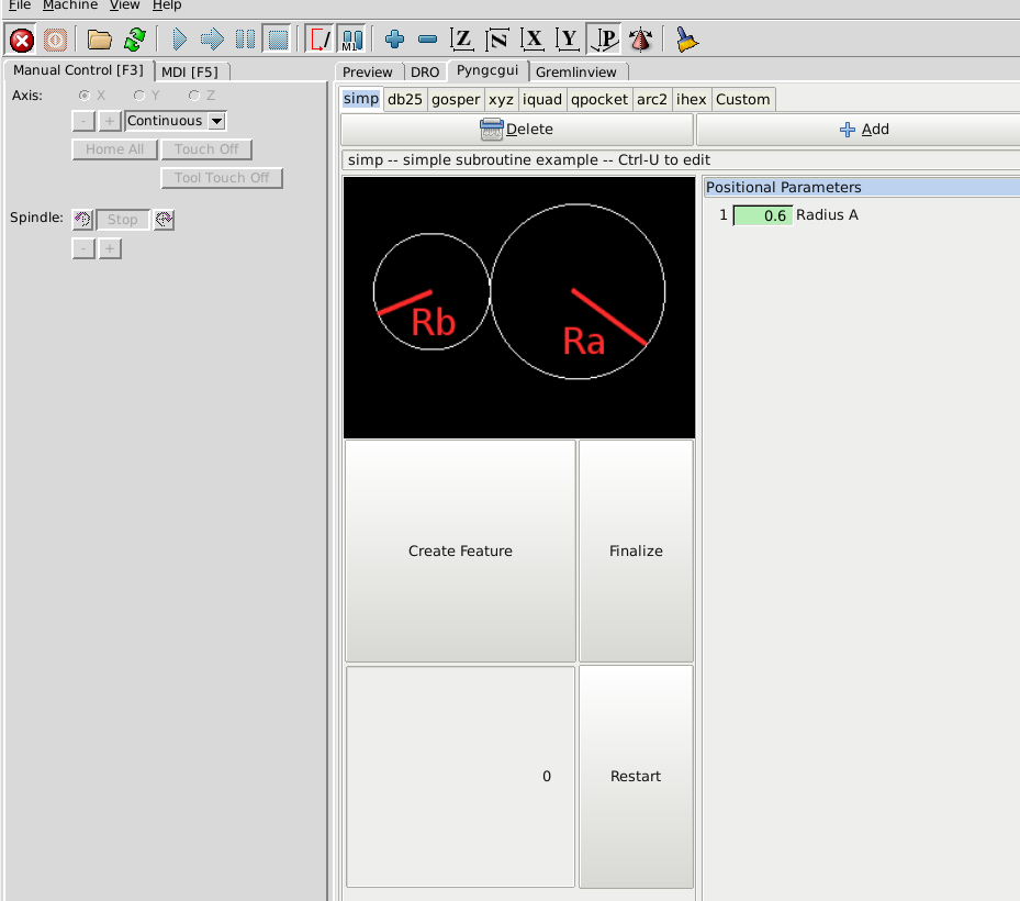

If you start linuxcnc with config picker, you can select several ngc items, see picture, it is within the axis program example list.
Okey i see there are several ngc programs to play with. This is nice.
This samples are already installed on your system. If you want you can change the example programs to your own usefull program.
But first make a copy, so you can go back if you make a bad character.
then it says, choose yes :
program startup. The files are now in your config folder. You can change the code.
If you right click on your desktop icon, you can see by properties where your core startup file (ini file) is located, in my case :
/usr/bin/linuxcnc '/home/grotius/linuxcnc/configs/sim.axis.ngcgui/pyngcgui_axis.ini'
Okey this line looks confusing but i explain :
This section is for starting linux :
This section is for starting your section :
So open your : pyngcgui_axis.ini file, this is your base file. From here you can modify and locate all the stuff that is
currently used.
Good luck !!
If i open the ini file, i see this, its a black screen with some text :
If you also want a black screen to program, Its very relaxing for your eyes.
just type in terminal : sudo apt-get install gedit and choose by options for different backgrounds...

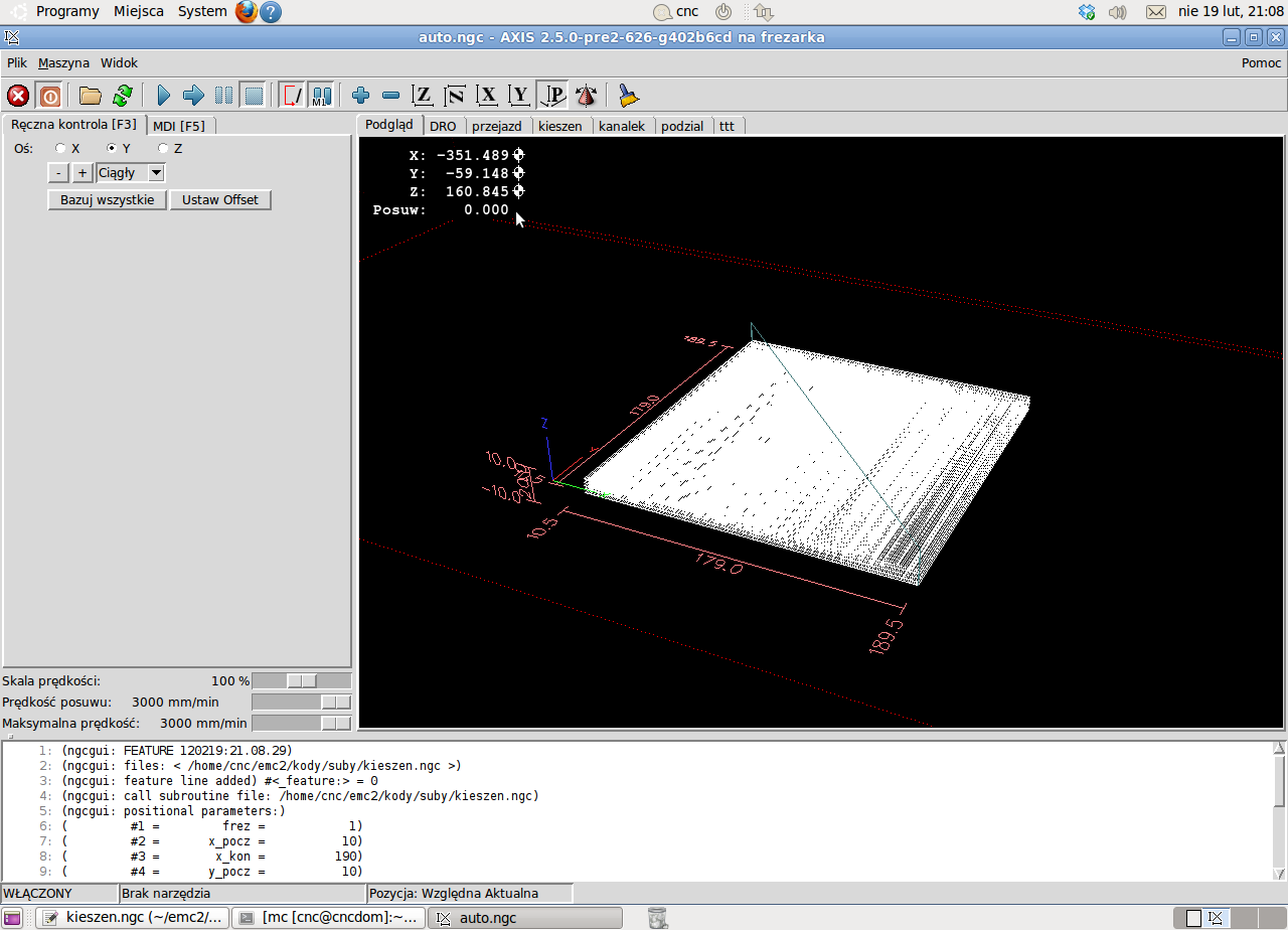

Hello, I have launched NGCGUI programs again but from what I see they are in a demo and explain to me
- I have a randomly created machine configuration or I can connect these programs together so that I would have the spindle on and the appropriate XYZ axis speed parameters displayed.
- whether these programs are only for creating a directory and whether they are just a demo.
- and whether you can set the Polish language
Gives a photo, I found this network so it would look like I do not have everything polonized
