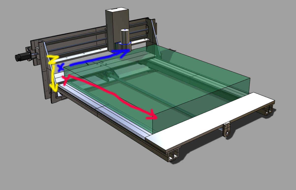

I want to run my CNC with the gantry parked in back, instead of the front edge.
I would like to place a part, like you could read it, from right to left, going down a page.
Is it possible to flip the co-ordinate system like this, without it mirroring/inverting/ruining parts?
I can flip the x-axis, but that's not the same.
I've looked into the coordinate system page, but that looks like it's for offsets.
linuxcnc.org/docs/2.5/html/gcode/coordinates.html
Metaphorically, I want to have my monitor stand at the foot of the bed, and the part at the headboard : )
Come to think of it, most CNC machine pictures have their gantries toward the headboard.
This would be a great GUI setting.

Yes you can do that but I'm not sure how well the display will show what you want becasue what you propose is not in accordance with cartesian geometry. eg. If you stand facing the table on the front side at the origin (0,0), the X axis increases to your right and the Y axis increases to your front. You have them the opposite way around. At one stage, I had my origin at the diagonally opposite corner to yours and swapped the axes around so the origin was at the bottom right of your diagram becasue it was too confusing to work with the machine. This meant the front of the machine is now the opposite end to where your gantry is.
If you are using master branch, swapping the axes and directions around is trivial by changing the ini file settings. I recently posted an example in the Hal examples section of a working 7i76e config using master branch that allows this.

As Rod alluded to, keep with Cartesian geometry otherwise confusion will come your way.
As I understand it, origin would be fixed at the top LH looking at the machine in the picture (if we consider the spindle being placed at the "front" of the gantry. Home is just a convenient place to park your machine. Please beat me with a mallet if I got this one wrong.

I would say the origin (0,0) is at the bottom left. It is on my machine anyway.
I Made a Gmoccappy macro button called park which puts the machine at to right corner.

I've taken your advise and worked toward the standard solution, but....
I have a big problem. When I can get the X-Axis in LinuxCNC to move in the positive direction, it will home toward the high side of the axis. X-positive is supposed to be heading toward the right in the picture above, right?
I am using a step forward / step backward 1,1,1 option in the HAL.
Could it be bugged?
I've tried combinations in both the .hal and ini, as far as swapping it homes to the positive.
Isn't it supposed home back toward 0 looking for the switch?
I am going to try a negative homing speed.

That did it.
I also had to put a negative value in for my homing offset to untrip the switch.
