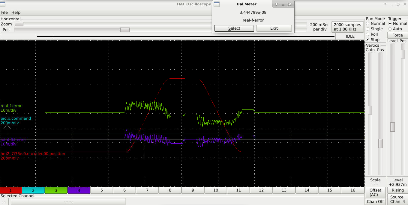

30 Jul 2018 17:26 #115157
by Hakan
Replied by Hakan on topic Stepper motors and linear scale closed loop setup?
Yes I use the latest version, a week or two old, and I see that pid.x.command-deriv is connected to joint.0.vel-cmd. OK, so the result I got could be better without the command-deriv. I can try.
Before that I can show the results of
- using position and velocity feedback from encoder 0 (mixed up with joint.0.pos-fb in the previous post. Should have been position-fb from stepgen there)
- pid.x.deadband = 0.002 (step_scale = 400 on x)
- P = 200
the same +1 mm and -1 mm movement as in the video.
The real following-error is below +-10 µm now. Was +34.5 -10 µm before.
Who is putting the axle back to zero after 10 msec? motion? The pid has no I term at this point, only P.
At P=1000 there was a spontaneous oscillation, so that seems to be too much.
From what I can see, the backlash is basically gone. I will try some more, this looks good.
- P = 200
- Hakan
- Posts: 1317
- Thank you received: 454
30 Jul 2018 19:24 #115163
by Hakan
Some further tests with pid parameters. Here is where I end up.
P = 400
I=0
D=0
deadband = 0.0013
P is the important parameter. As far as I can tell, it should be as high as possible, without spontaneous vibrations occuring with some margin.
I will eat up the remaining error. But not in this machine. While idle and with a tad of f-error I can hear the motor taking a step say every second. But the motor doesn't seem to be strong enough to move the table just one step, at least the encoder will not pick it up. This results in a step taken every second without effect. (step = microstep). I never tested because I got so annoyed of the step-sound, but I guess the table will move after some tension has been built up by the motor (stick-slip). I also would like to see that the I-counter do not count when the f-error is inside the deadband, but the I-counter always integrates the error it seems. So I was set to 0.0.
D was also set to zero. I tested quite a bit but could never get a critically damped signal. It was easy to get a vibration of the X axis at 4 Hz. Decreasing D so it didn't happen still did not improve the overall f-error. So the only reasonable thing was to set it to 0.
Deadband was also undergoing some change. Up and down, it seems 1.3 µm is a good value that doesn't cause oscillations and keep things steady.
I am also a bit interested in the appr 100 Hz vibration that seems to always be there when the X-axis moves. Not dependent on speed nor acceleration. Some eigen-frequency in the milling machine? It could also be some effect from the closed-loop stepper motors.
The result is that the real following error stay below +- 15 µm at all speeds. I have tested with fast and slow, G0, G1. Without load. I guess I should test while milling as well.
One thing to note is that when jogging the X-axis in the positive direction, the motor doesn't "sing" anymore. It is more growling like when cutting threads in the lathe,
P = 400
I=0
D=0
deadband = 0.0013
