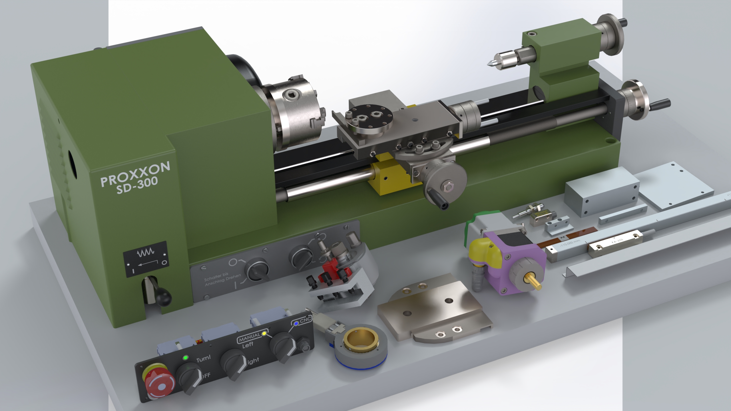

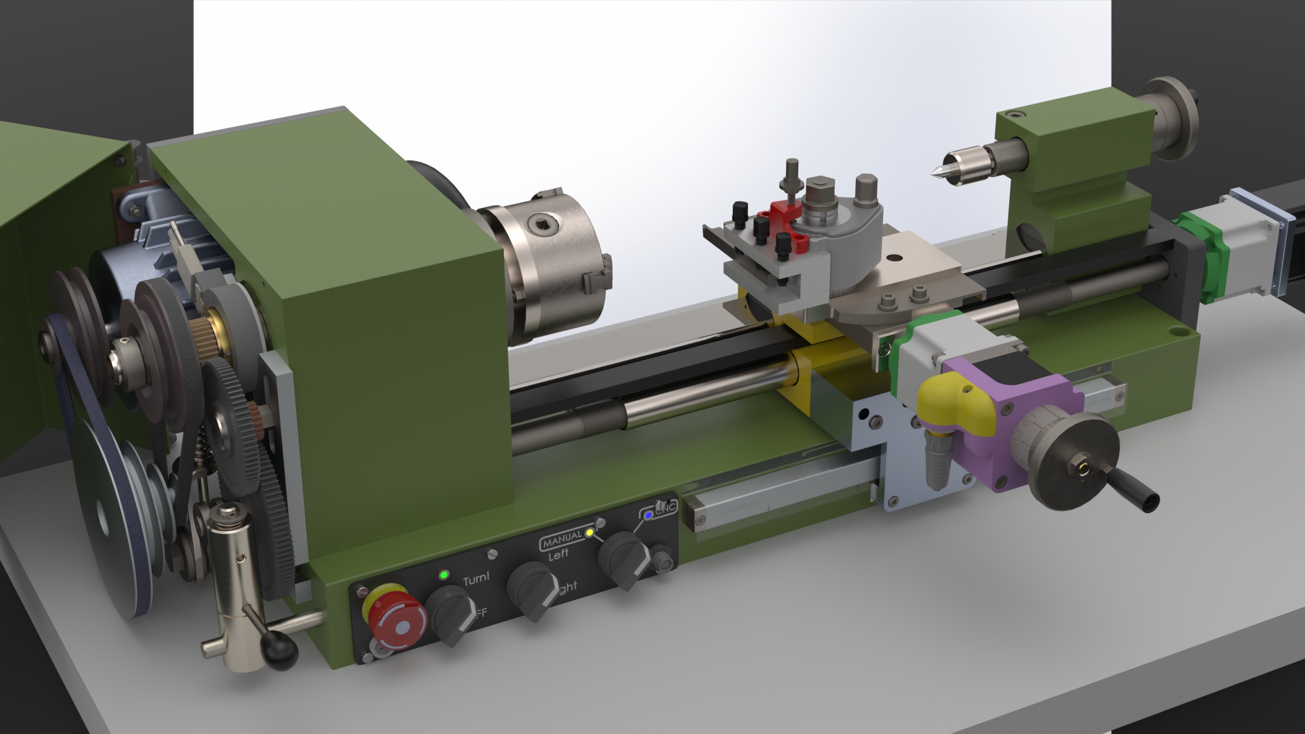

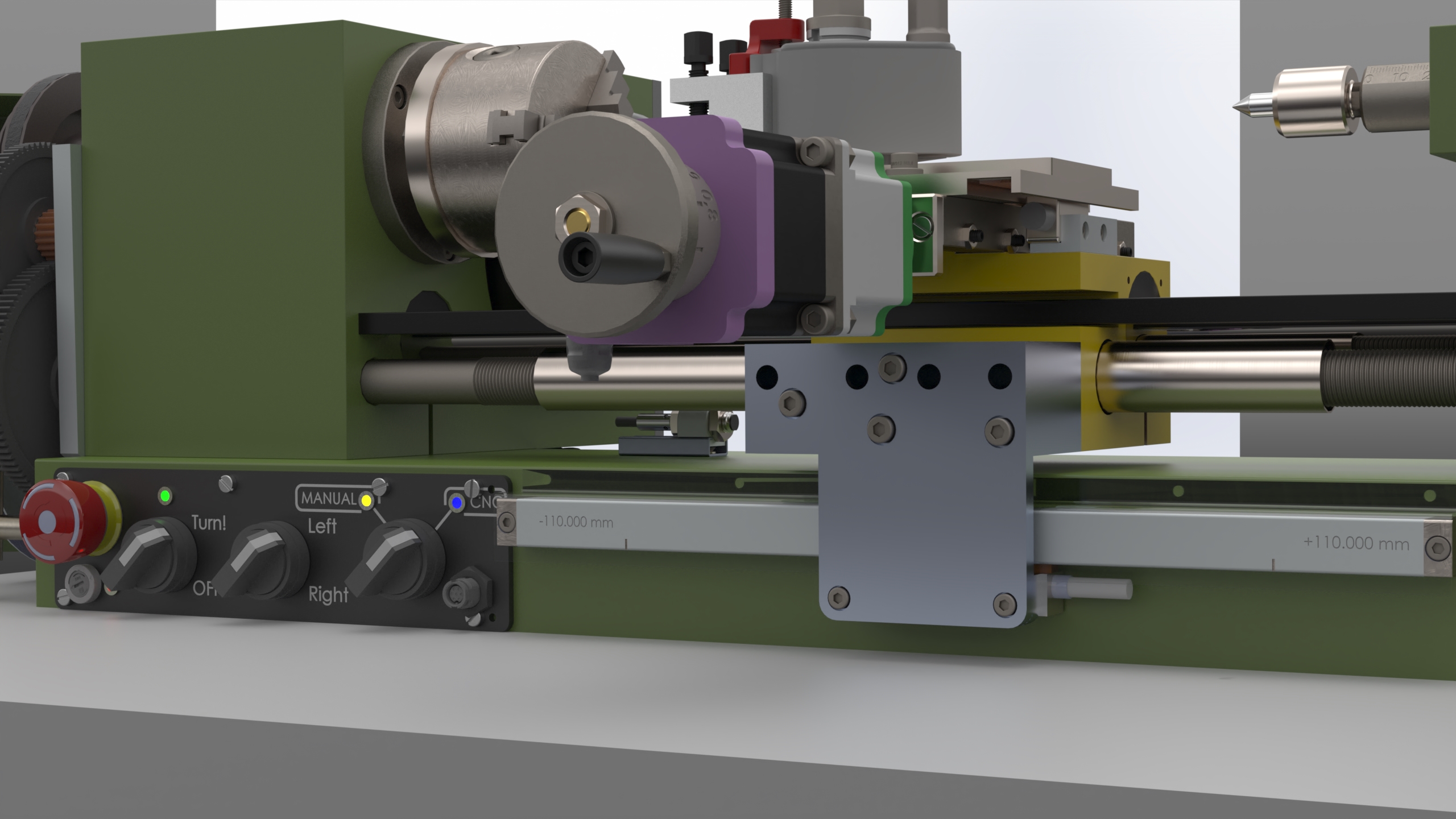

- Ronald J
- Posts: 13
30 Oct 2020 20:21 - 30 Oct 2020 23:27 #187828
by Ronald J
Replied by Ronald J on topic Stepper motors and linear scale closed loop setup?
Dear Hakan,
I have seen all your Youtube Video's, you have a big fan over here.
I love the concept of LinuxCNC, but I really struggle finding a good tutorial how you start at all, with a basic Lathe-Conversion using Spindle-Encoder, and two linear encoders (Sino KA200 & MSL130) as feedback.
For instance, I am in the middle of my Lathe-Conversion, and now have to determine what Version of the KA200 & MSL130 to order.
I really want the Lathe to be able to "home" itself into a start-position, that has a precise reference.
Would you, in your experience, recommend a single Z-Reference Signal in the absolute middle of the Linear Encoders, or would you recommend a Z-Reference Pulse (or Signal) at the absolute start or end of the measuring range (Example: 000,000 mm, Here the Z-Reference-pulse would be active, And nowhere else).
Any guidance here is very welcome. Thanks again for your great Video's about using & tuning LinuxCNC, using Linear Encoders.
(Attached you see how what the state is of my current Lathe Conversion)

31 Oct 2020 13:49 #187906
by MalteS
Replied by MalteS on topic Stepper motors and linear scale closed loop setup?
I have converted a Lathe. I have Glasscales but use those only for measuruing. The lathe is run in open loop mode.
You should have a reference signal at the end of the measuring range. The machine position is unkown on startup and your PC needs to know in which direction to start searching for the home position.
Please also note that encoders will give you an pulse signal only and not an absolute position.
And finally:
I would reconsider the X Axis design. Stepper motor resolution is not great. Yes it is increased through microstepping but at the expense of torque. When using 8x microstepping and a 5mm pitch lead screw you have a resolution of 0.003mm. Since this is a lathe your diameter will change by 0.006mm / step. Often you want to hit tolerances of 0.01mm and your position resolution already starts to impact what you're able to achieve here.
I used a belt reduction on my machine
(And encoders as handwheels, but this is a different story)
Running such a machine closed loop made sense to me if the bed slide don't move in X Axis direction relative to the bed. I'm sure mine would
And finally:

- Ronald J
- Posts: 13
31 Oct 2020 21:43 #187949
by Ronald J
This is a very good input, thanks for that. Any alternative solutions that could help avoid a indirect drive? Maybe use >>64 micro steps + higher torq Stepper Motor ?
(I try to keep the bill of materials small if possible)
Warm regards and again, a humble thank you for these replies.
R.
R.

31 Oct 2020 23:10 #187954
by MalteS
I'd not install Glasscales if money is a concern
