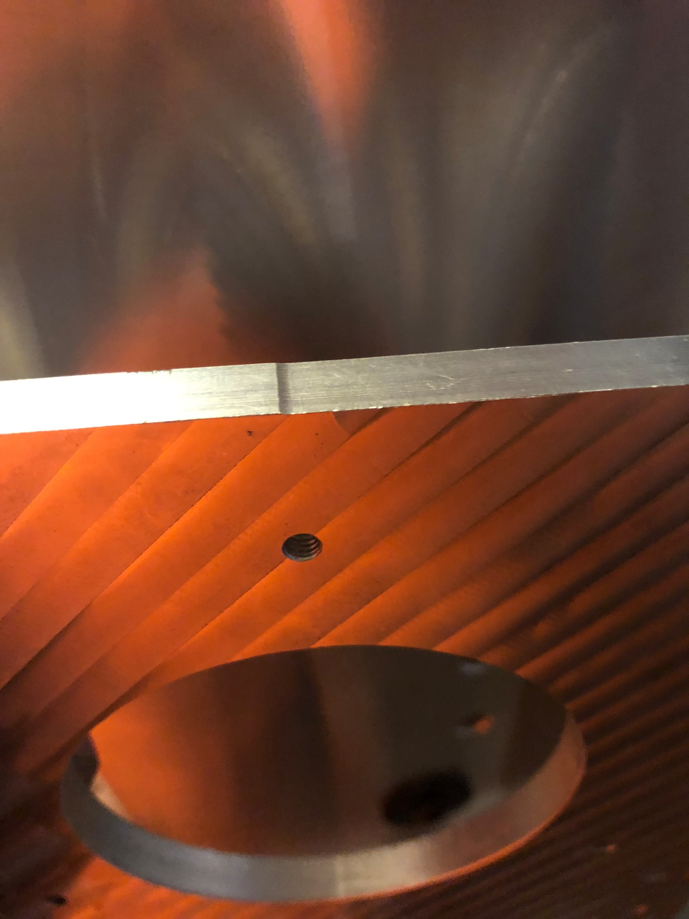

I get a strange Y movement on most of the parts I run with a squarish contour. It's always at the same side of the parts along the X axis feed. Halfway through the X movement, the Y will step out probably near .010". It's not slop or anything, on a multipass contouring op It will make the movement at the exact same place every time, and I can see the Y motor move at this point. I don't think it's a CAM issue because when the Y moves the DRO does not register this movement. Come to think of it I get this on large interpolated holes as well, I didn't think too much of it on a round hole because that's a coordinated movement with more room for error. On a straight line move it's a more obvious issue.
The only thing I can think of is that it's related to backlash compensation or something but that's a strange way of doing it. I assumed backlash comp would only make an extra movement at the initial direction change of that axis, as you would with a handwheel on a manual machine. Backlash comp is set at up to .008" at the moment, until I get some preloading set up. Dimensions turn up pretty good other than this weird facet that's left with this strange Y movement. .ini file and G-code of an affected part.

I see the same behavior on my z-axis, which has a small backlash correction (about 0.002").
Probably some quirk in the trajectory planner that somehow sees a change in direction for the idle (backlash corrected) axis, even though the commanded position has not changed.

Now that you mention it I do get an odd finish blemish when I run a facemill along longer parts on the X as well, same spot every time. I don't think it's the Z because there doesn't seem to be an "edge" to it. Probablt the Y again. Is there any fix for this, other than turning backlash comp down to 0? Assuming this is due to BC.

I dug into this a bit further, and I believe there is a bit of a bug in the "control.c" module.
During the backlash correction computation there are numerous checks to see if the joint velocity is positive, negative, or zero. However, these checks are done on floating point numbers with no tolerance. Therefore it is possible for a floating point math uncertainty to change the movement from positive to negative with only a change in the LSB of the double precision number. Even if the commanded velocity is zero, there are several additions and subtractions of positions, calibrations, etc, that could change the LSB.
Comparisons on floating point numbers are always risky for this reason.
I checked the source from both version 2.7.14 and 2.8 master. There appears to be no difference in the backlash sections.

If my guess is correct, the only fix would be to tweak the code a bit.
An easy test would be to put in an intentional very slight ramp in the y-axis, say 0.0001 inch, and then see if the jump still occurs. If it does then I am out of ideas. If there is no jump then the floating point zero check is a likely suspect.
