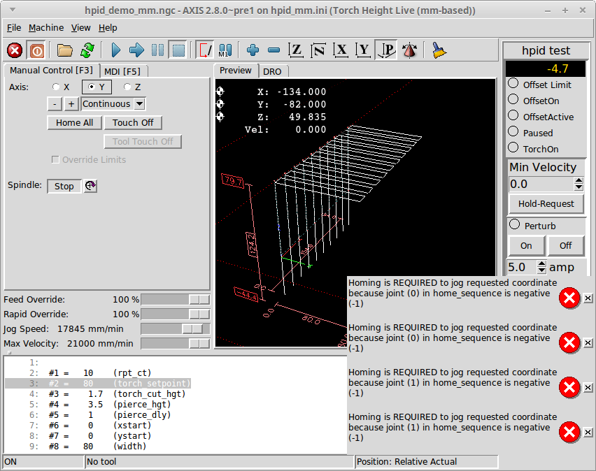

Ok an update I now (it seems) have a functioning ini file for the homing slaved axis, thanks to all and much reading.
I have noticed that when I home all and it gets to the homing of the slaved axis it all runs fine:)
But if I hit or catch the left or right arrow keys (X axis) in the middle of homing procedure one motor will stop and thus start racking the gantry.
Is this normal? .. When homed the gui screen changes signifying the home is completed with a "H" and then you can jog normally

- Posts: 12159
- Thank you received: 4151
09 Jul 2018 09:59 #113859
I can confirm this happens on my gantry using Axis GUI. An error window is raised and then it stops the movement before the machine really gets itself in a knot.
I think this is a bug in the Axis GUI.
It should disable the behaviour, rather than just report it.

Yes I fully understand "there is no reason to jog before the homing procedure" I do have a fully functional gantry machine with slaved axis but not running linuxcnc as yet. On my machine "that I have had for more than 5 years" before homing I can jog the machine (even slaved axis) but when it is homing to square axis the jog keys for that axis are not functional. This is using a Purelogic Board.
It is easy to catch a key and in my opinion the jog key should be inoperative during the homing period.
The question I asked was "is this normal for behaviour lcnc to be able to inadvertently hit a key and rack the gantry" or have I not configured it correctly? If so is it possible to disable jog keys during homing?

09 Jul 2018 10:19 #113861
Replied by rodw on topic Help required 2.8 slaved axis
I've raised an issue for this #461
github.com/LinuxCNC/linuxcnc/issues/461
