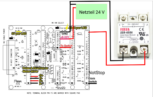

I want to start my spindel with a SSR Module.

I can't open your files for some reason but something like
JT
net spindle-on motion.spindle−on => some.output.pinJT

# --- SPINDLE-ON ---
net spindle-on => hm2_5i25.0.7i76.0.0.output-07
is set, but there is too in the hal..

What M code are you using to turn on the spindle? Spindle CW is M3 and CCW is M4. M5 turns it off.
Does it come on via the gui control ?

Goal is to use M3 and the gui control..

Does the SSR have an LED to show if it is being activated?

I think that the basic problem is that you have inconsistent signal names.
net spindle-enable <= motion.spindle-on
net spindle-enable => pid.s.enable
I think that those all need to be net spindle-enable...

Yes, the SSR has a activated LED..
The signal names were a suggestion from pncconf..

Signal names are entirely arbitrary in HAL.
Stepconf and PnCConf use the same signals fairly consistently, but these should not be viewed as defining any sort of standard.

Editing
to
net spindle-enable => hm2_5i25.0.7i76.0.0.output-07
works..
