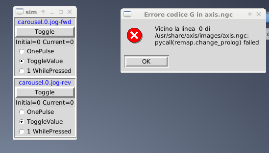

Replied by tommylight on topic triac changer tool
From your post:
loadrt carousel pockets=10 dir=2 encoding=index
loadrt conv_float_s32
addf carousel.0 servo-thread
addf conv-float-s32.2 servo-thread
You have loaded only one single conv, but you are adding the third conv.
should be
addf conv-float-s32.0 servo-thread
on all the lines where it is used.

28 Oct 2018 11:51 #119548
Replied by andypugh on topic triac changer tool
You only have one conv_float_s32 and that is called conv_float_s32.0
In the 4th line of the HAL you are trying to addf conv_float_s32.2.
(Which is what the error message says).
Either change the "count=" in the loadrt line, or use conf_float_s32.0 in that HAL file.
The reason that the sample config uses conv_float_s32.2 is that conv_float_s32.0 and conv_float_s32.1 are in use in other HAL files.
(Maybe I should have used 0 in that HAL file and 1 and 2 in the other files).
Change to .0 throughout your file.

28 Oct 2018 14:30 #119554
by gmarconi2
Replied by gmarconi2 on topic triac changer tool
Well with the changes you suggested me axes and spindle work.
The toolchange procedure with MDI m6 tx command starts, moves x axis, then clearly stops with "error failed to move arm in" for lack of feedback.
Now my job is to connect input and output to the mesa 5i25 7i76 board, a connection I tried to do it, I expected high output in GPIO No. 17 TB6 board 7i76 with this connection in hal made in the toolchange_index.hal file.but by checking with the tester the signal remains low I had to do other things to connect outputs and inputs to the carousel function.
Greetings gmarconi2
net car-fwd carousel.0.motor-fwd => hm2_5i25.0.7i76.0.0.output - 00Greetings gmarconi2
