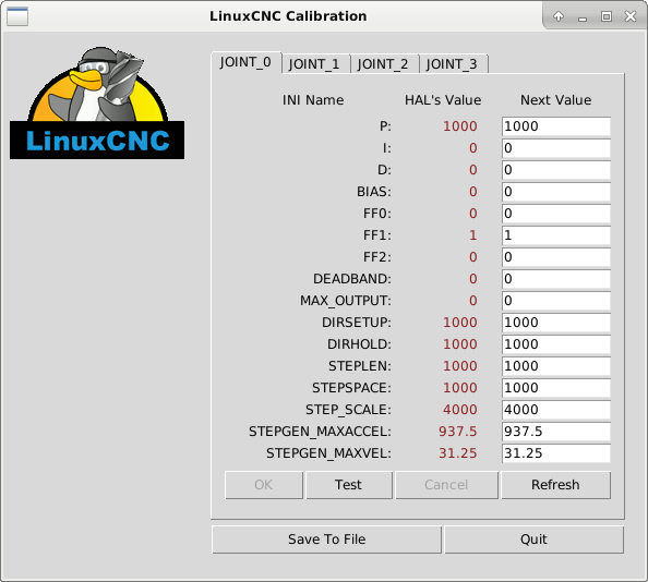

just another question ... can I see the PID "Calibration" Spindle like as axes (JOINT_0, JOINT_1, JOINT_N) to modify on fly PID?

I don't think there is any easy way, but you can make changes from a terminal window with halrun.
halrun setp pid.s.Pgain 100
When making changes I liked to first run the command with the existing setting, so that if the spindle went crazy, I can just press up arrow twice then enter, to reset the original setting. If that makes sense.
