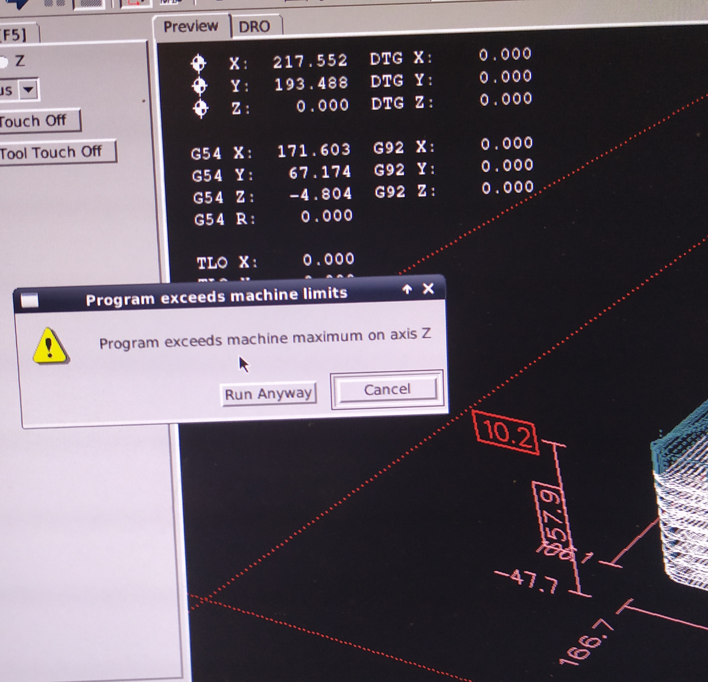

program exceeds machine maximum on axis Z was created by gzcwnk

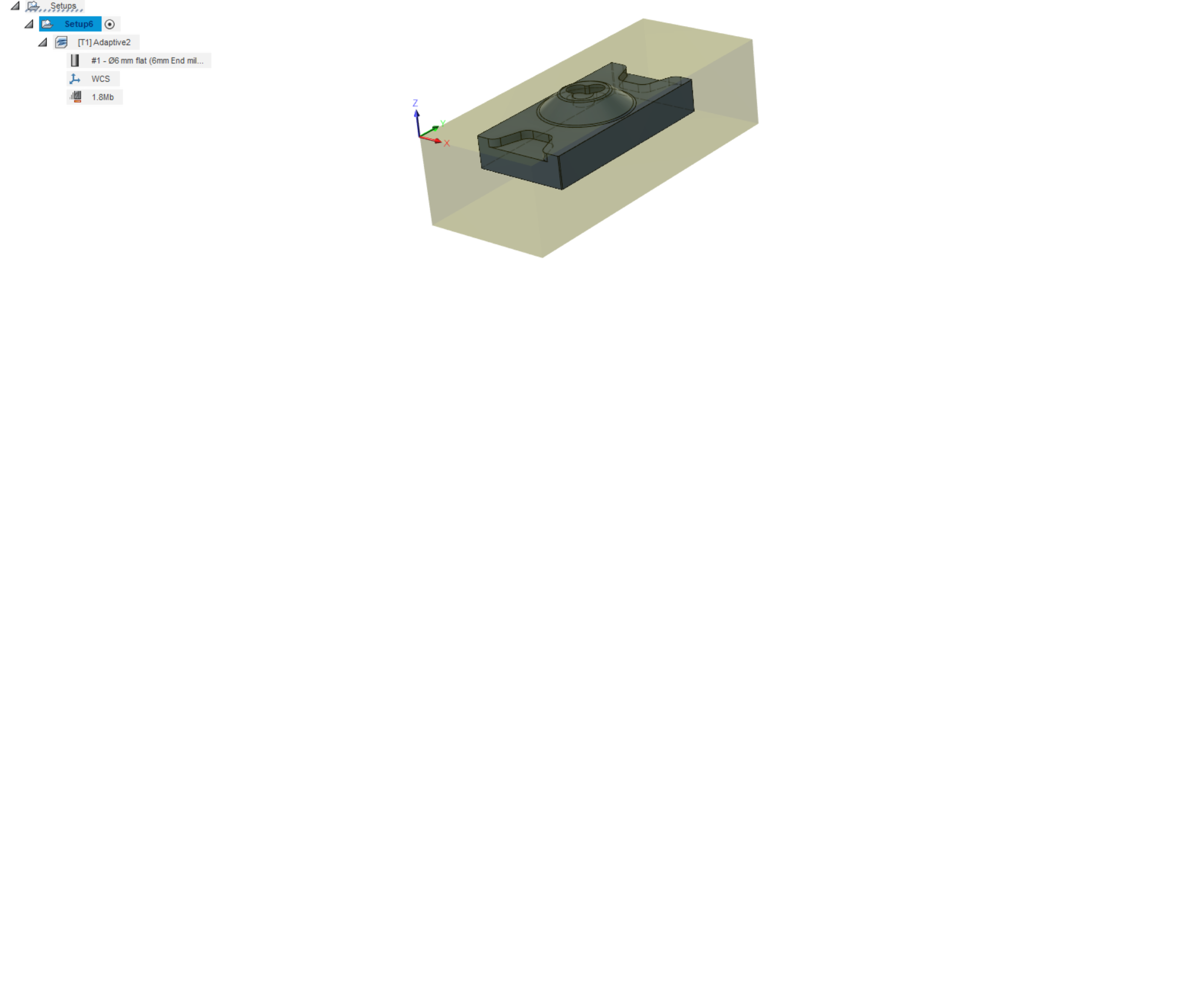

I am new to this. I am trying to do a bit of CNC work, this is my second attempt at a test piece as I learn CAM/CNC (first piece went fine).

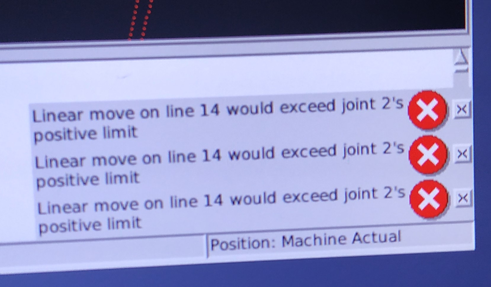

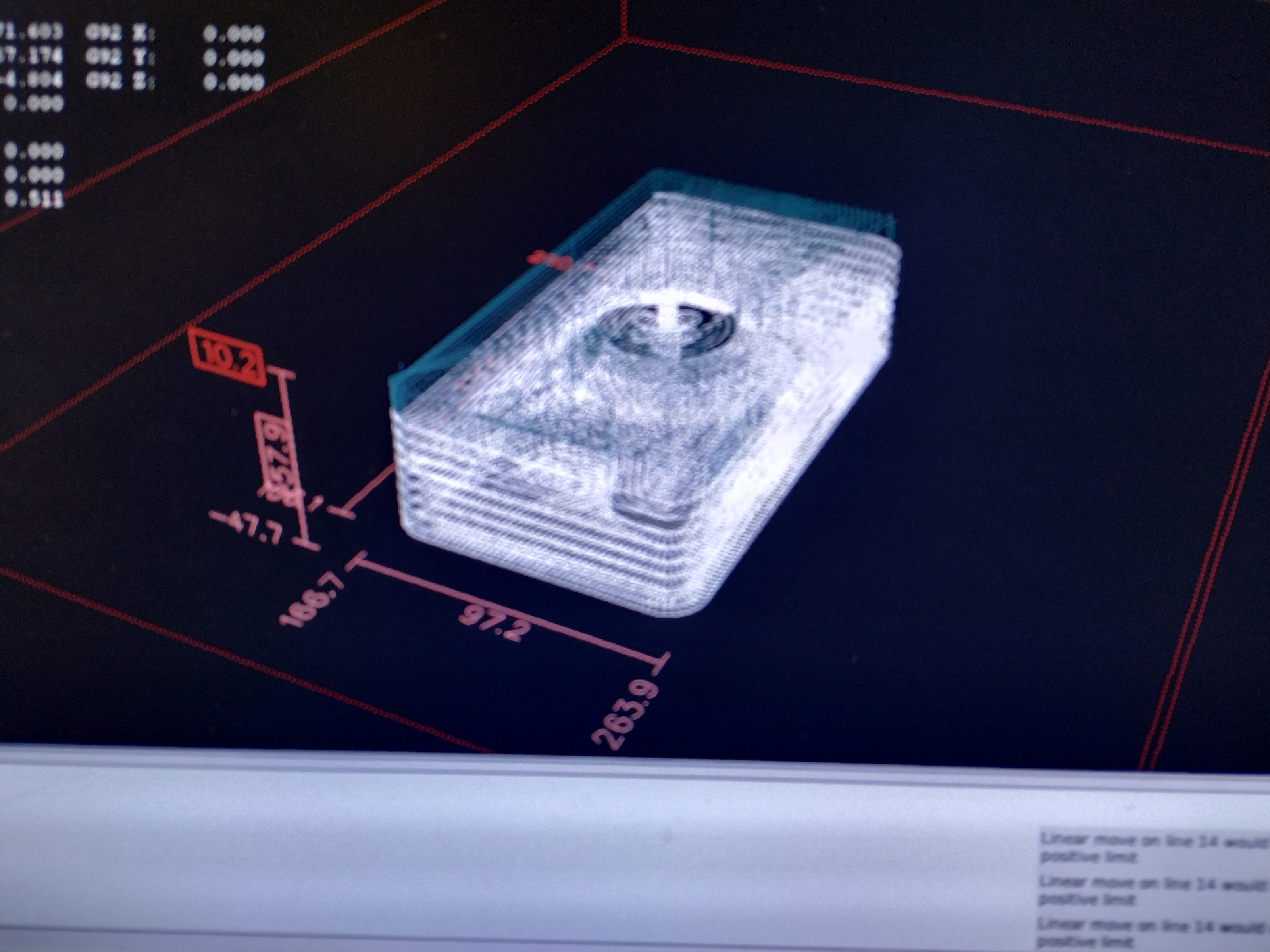

When I try and run the program on the second piece I get the above error.
When I try and run it anyway it moves to the start and then stalls where the next call / line is a plunge into the work.
At this point I have no idea why it will not rough out the piece.
I have 70mm of movement on Z and the piece seems to be about 59mm so I cant fathom why this operation will not run.

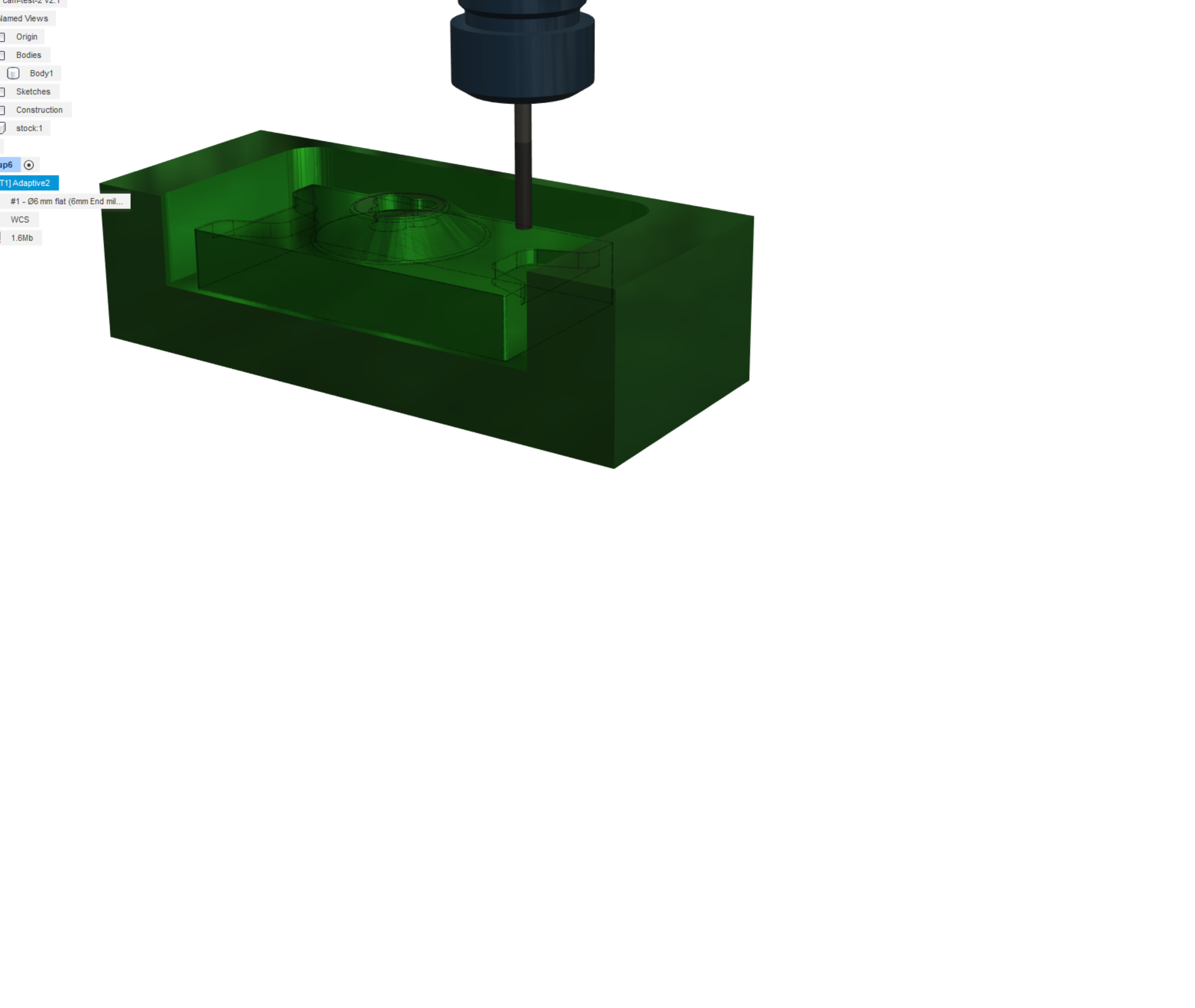

fusion360 screenshot
simulation
simulation

N50 G43 Z15. H1
So looking at some googling its suggesting? well I dont know its almost like a bug? "forums.autodesk.com/t5/fusion-360-comput...me-code/td-p/6723489"
its waiting for a tool change?
totally lost now.

Ok this is to do with clearance height I think? The work piece is 68mm tall and I only have 70mm max movement. So that Z15 is move up to a safe height?
- Clive S
- Posts: 2204
- Thank you received: 486
26 Dec 2018 09:29 #122903
by Clive S
It looks like you have answered your own question. If the part is 60mm and you only have 70mm in Z height . Then you have touched off in Z you cannot move to Z 15 as that would be more than 70mm.
Replied by Clive S on topic program exceeds machine maximum on axis Z

Yes I ran the piece last night til 11pm went fine....it is indeed a movement to the safe moving height.
