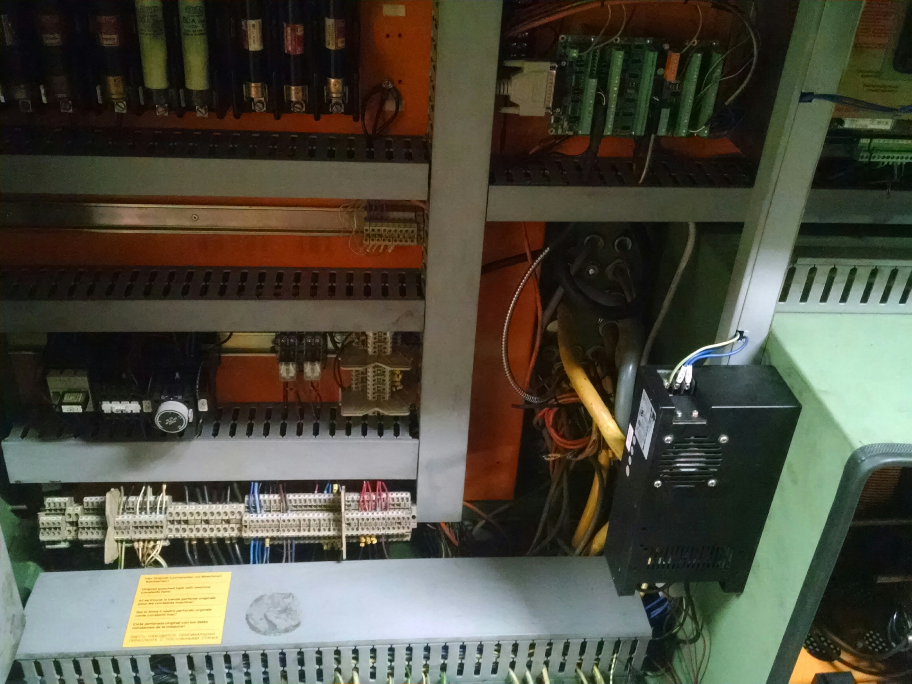

06 Feb 2019 21:16 #125873
by Mccartymachine1
Replied by Mccartymachine1 on topic Retrofitting a 1987 maho mh600c
Before disassembling.

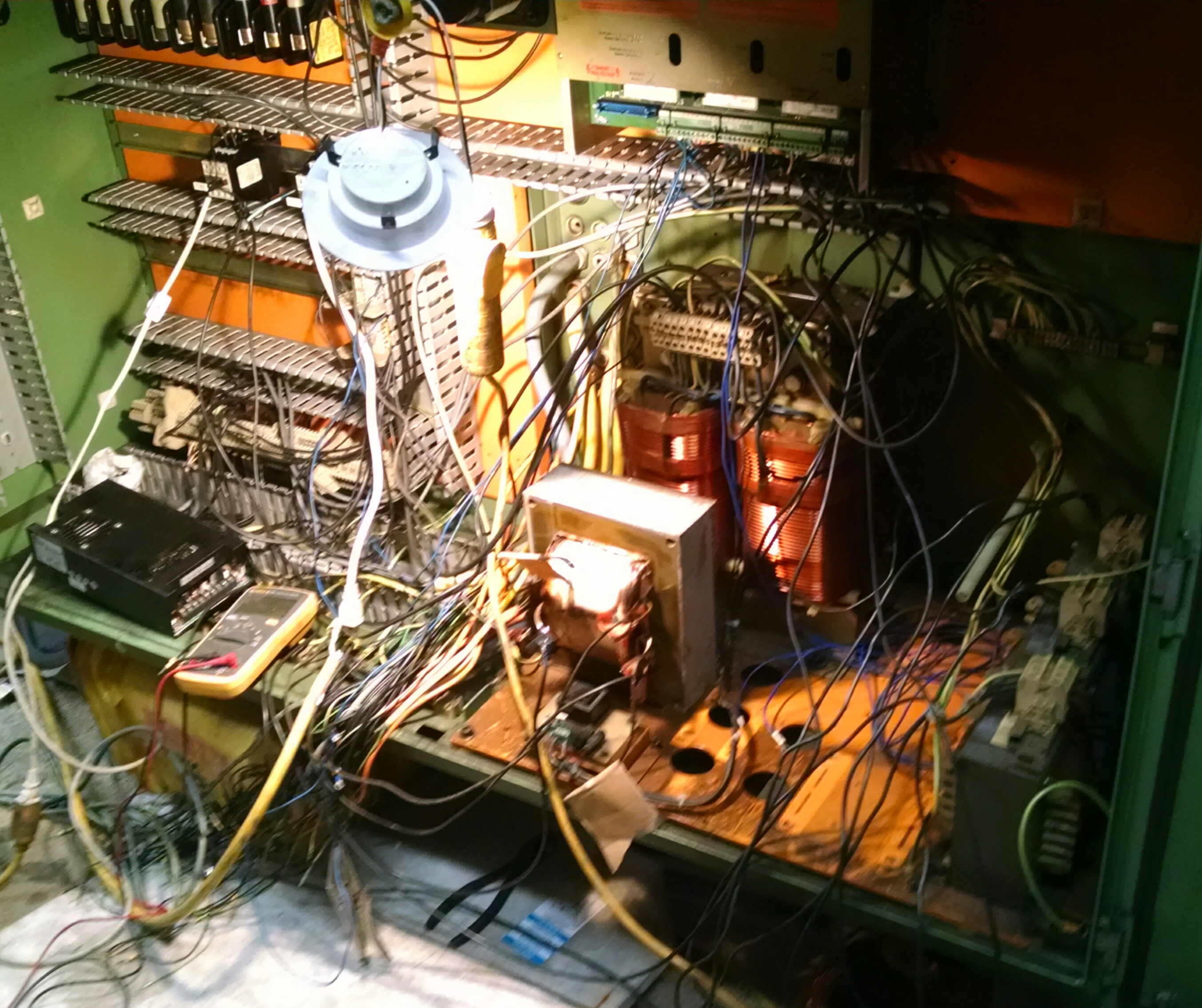

- Mccartymachine1
- Posts: 42
06 Feb 2019 21:16 #125874
by Mccartymachine1
While rewiring.

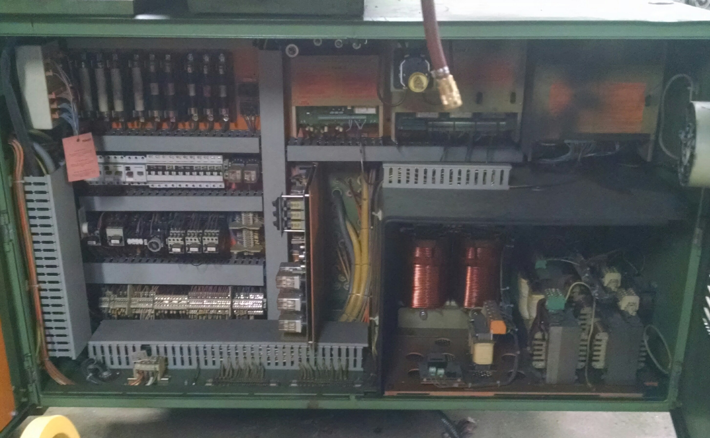

- Mccartymachine1
- Posts: 42
06 Feb 2019 21:20 #125876
by Mccartymachine1
Now.

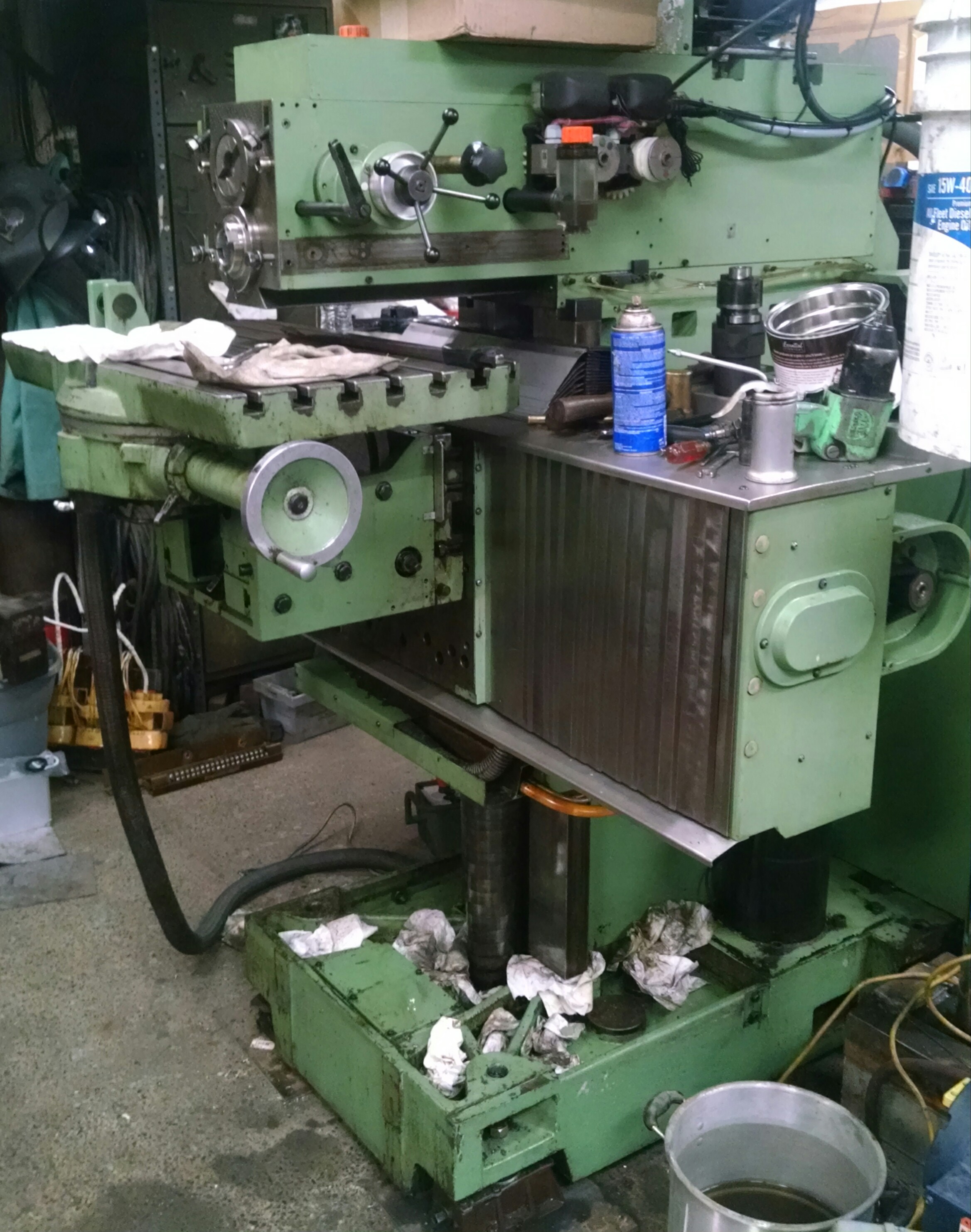

- Mccartymachine1
- Posts: 42

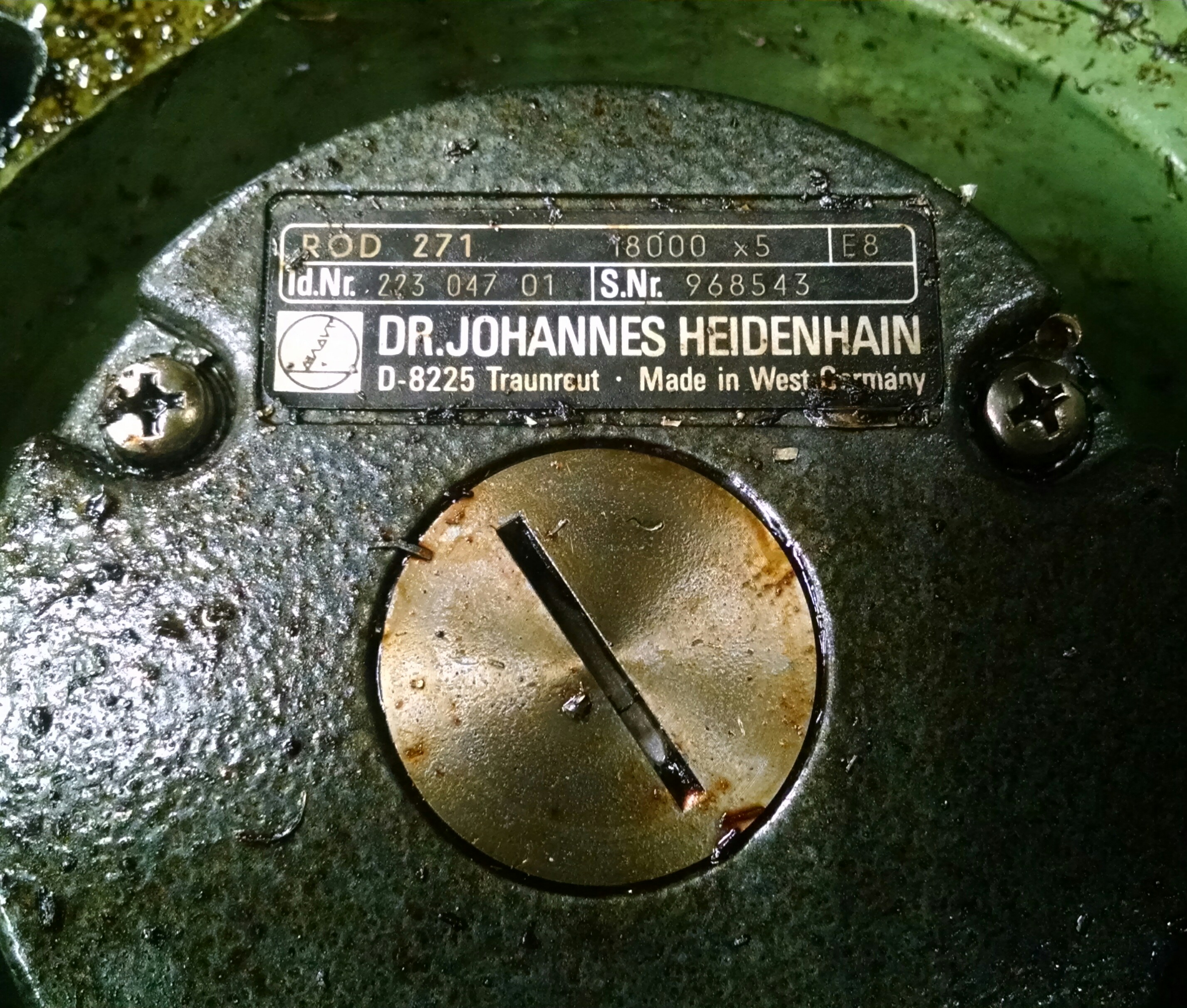

13 Feb 2019 01:40 #126321
by Mccartymachine1
I just got my universal table cleaned up and reassembled. Does anyone know how I can wire in the manual 4th axis encoder? I need help with both the wiring of the heidenhain rod 271 to the 7i77 and how to set it up without a servo output. Just using it as an angular dro.
- Mccartymachine1
- Posts: 42
13 Feb 2019 01:43 #126322
by Mccartymachine1
Rod 271 encoder on my mh600c.
