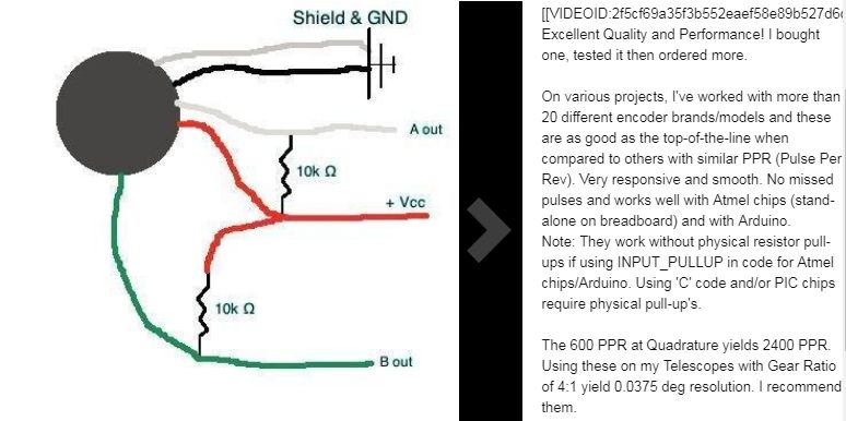

My little encoders I got are just cheap encoders without an index. www.amazon.com/gp/product/B00UTIFCVA/ref...00_s00?ie=UTF8&psc=1
So green is A, white is B ...red and black for the 5v+ and Grnd
Then I assumed shield was used as a shared /A and /B
This is working on the O-Scope this way but I can't find clear information on the TTL stuff with the 7i48 card. So maybe I have it wrong. If the shield is not a shared return for A & B do I just not connect the shield to anything?
A user shared this image but it didn't make sense to me before. Now with what your saying about TTL maybe it is what I need to do. Do the 7i48's have these pull-up resistors (10k ohm) built in? The document only had mention 1 time of pull-up resistors but not what value they were.
So maybe I wire Green to pin1, black & shield to pin3, white to pin4, red to pin6
That's only 6 connections on the 7i48 and made no sense to me but if TTL mode is used like that (single ended?) then that makes sense. I just need to know if I need 10k resistors or not like the image below.

For TTL mode:
1. You need the 7I48 jumpered for TTL mode
2. The /A and /B inputs on the 7I48 must be left open (unconnected)
3. Leave the shield unconnected at the 7I48 end

No pullups are needed (there are 2K pullups built into the 7I48)
but the encoder inputs must be jumpered for TTL mode:
7i48 manual page 2
7i48 manual page 2

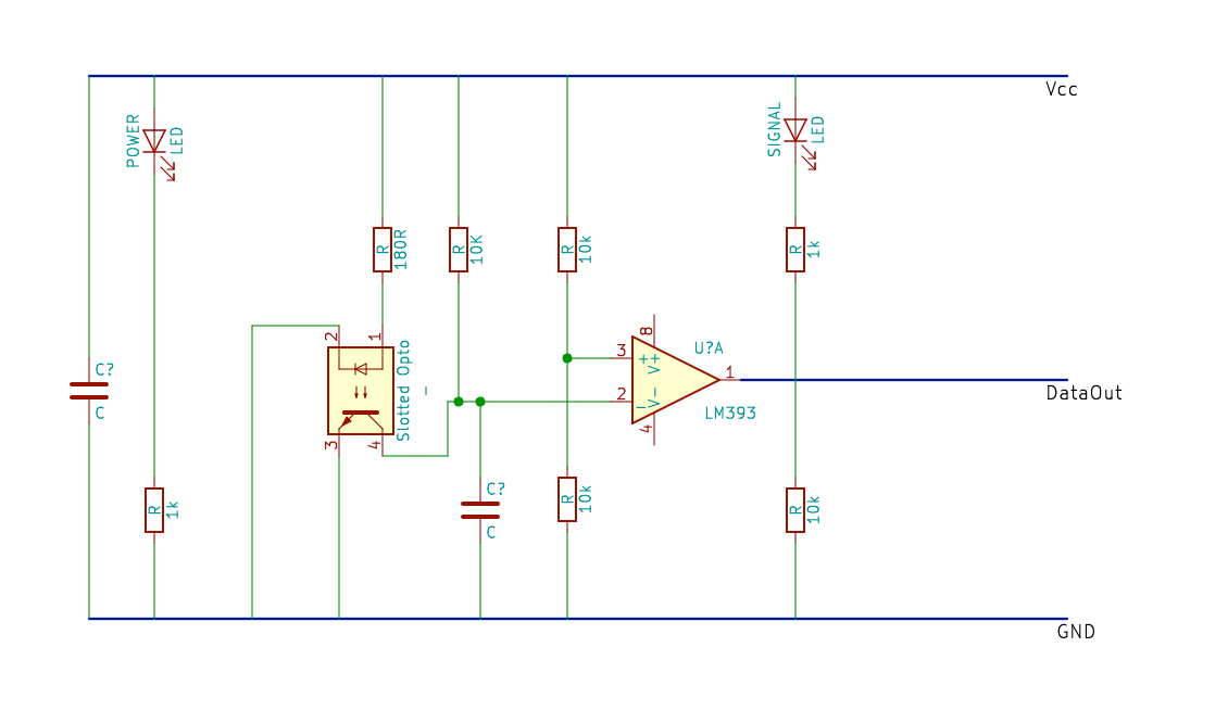

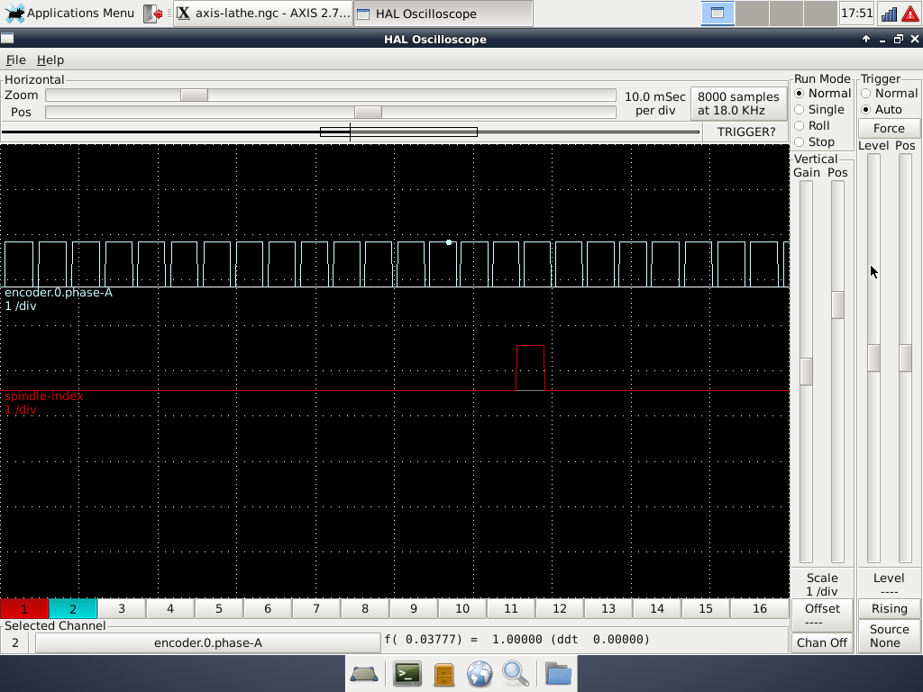

Hi Todd, My encoder disk has 60 slots. I have attached a couple of screen grabs
which I hope will give you a better idea of what's happening. The halscope one was taken with the lathe running at about 240rpm. Up to around 300rpm, I get a screen indication of spindle speed which is pretty sound but, above that it starts to get flaky and at around 36rpm, just gives up and goes back to zero. I tried a bit of simulated screwcutting with it last night and, up to around 300rpm it seemed to behave OK and, altering the spindle speed, the tool seemed to track the changes but, again, above 350 or 360, it just stopped moving. I suspect it may be the optos that have some kind of delay in there if other people have things working ok, I'm going to try to trace the circuit shortly, otherwise I'll need to try to figure out what kind of circuit is needed to interface plain slotted optos..
