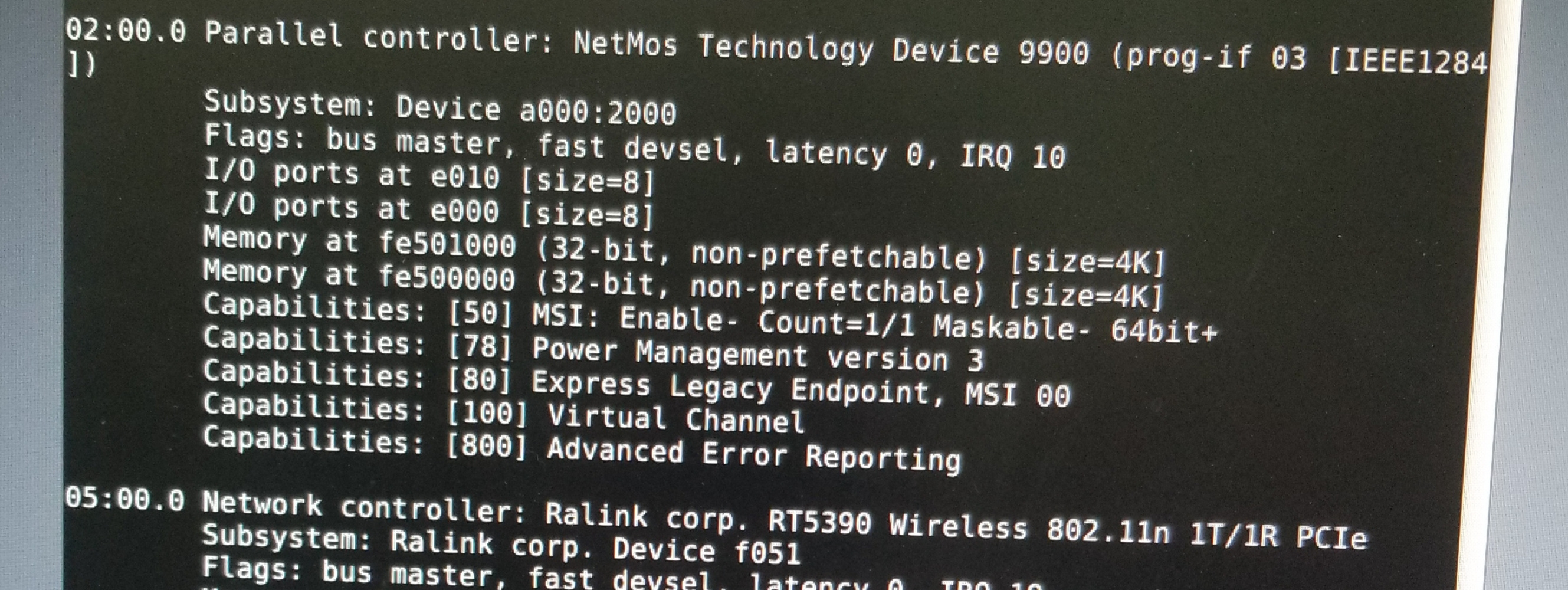

After entering the command(?) You said, this is what it shows for the parallel controller, I have no idea what I'm looking for, but it doesnt seem to say anything about a driver from my complete noob view. Any help would be greatly appreciated!

Whoops, photo didn't attach, I'll get that posted. I think this worked....

What base address did you use for the parport card in Stepconf?
It looks like the card is it e010 (or maybe e000)

Thank you for your help! It ended up being the wrong port, it is now moving as far as I can tell!
