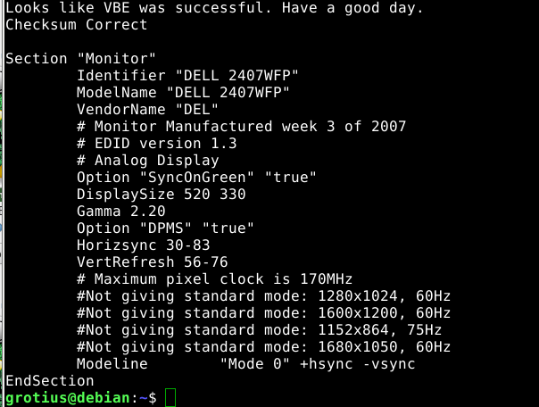

20 Feb 2019 00:35 #126798
by Grotius
Replied by Grotius on topic Setting up an ELO touchscreen for linuxCNC
Steven,
In the file it called a hid_multitouch for a hansg touch screen. How about your monitor name?

- F4br1c4t3D
- Posts: 51
20 Feb 2019 01:28 #126801
by F4br1c4t3D
Replied by F4br1c4t3D on topic Setting up an ELO touchscreen for linuxCNC
Grotius,
Thanks for the suggestion on getting extra info. The screen is actually called ELO1915 not 1519 as I said in my OP.
It's made by Elo and its identified by lsusb as "Elo TouchSystems"
vendor ID 04e7 :0073
