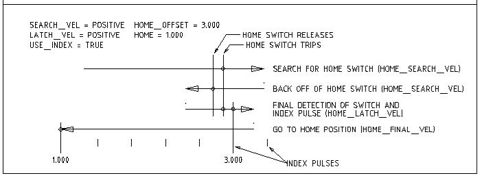

28 Feb 2019 10:44 - 28 Feb 2019 10:44 #127317
Replied by rodw on topic Homing on Linear Scale Index
I have to agree with Andy to some extent. We are not attacking you. But if you follow the
Homing configuration
docs
You can still home to an index but you don't need to crawl to find it. You can sprint or jog even.
This would work particularly well for the OP as he only has one index mark.
Please take the time to review this diagram taken from the link above
Have you actually tried this? How can this differ in finding the index mark then your method (other than being faster and not needing to "wrangle" the axis manually)?. Its the final move to the index that counts.
