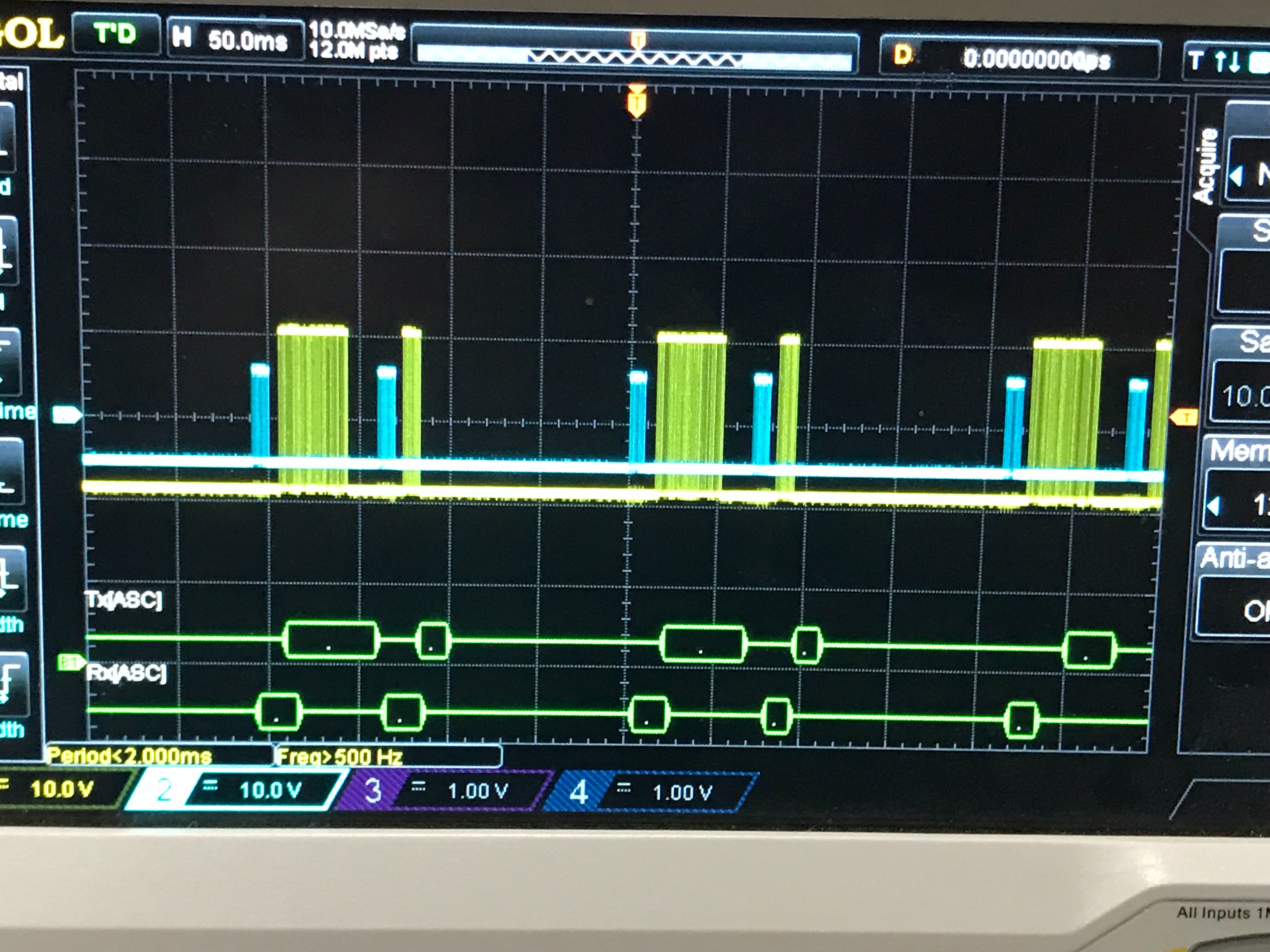

You can try lowering the communication speed of the RS232, but it is much more advisable to check the grounding and shielding.

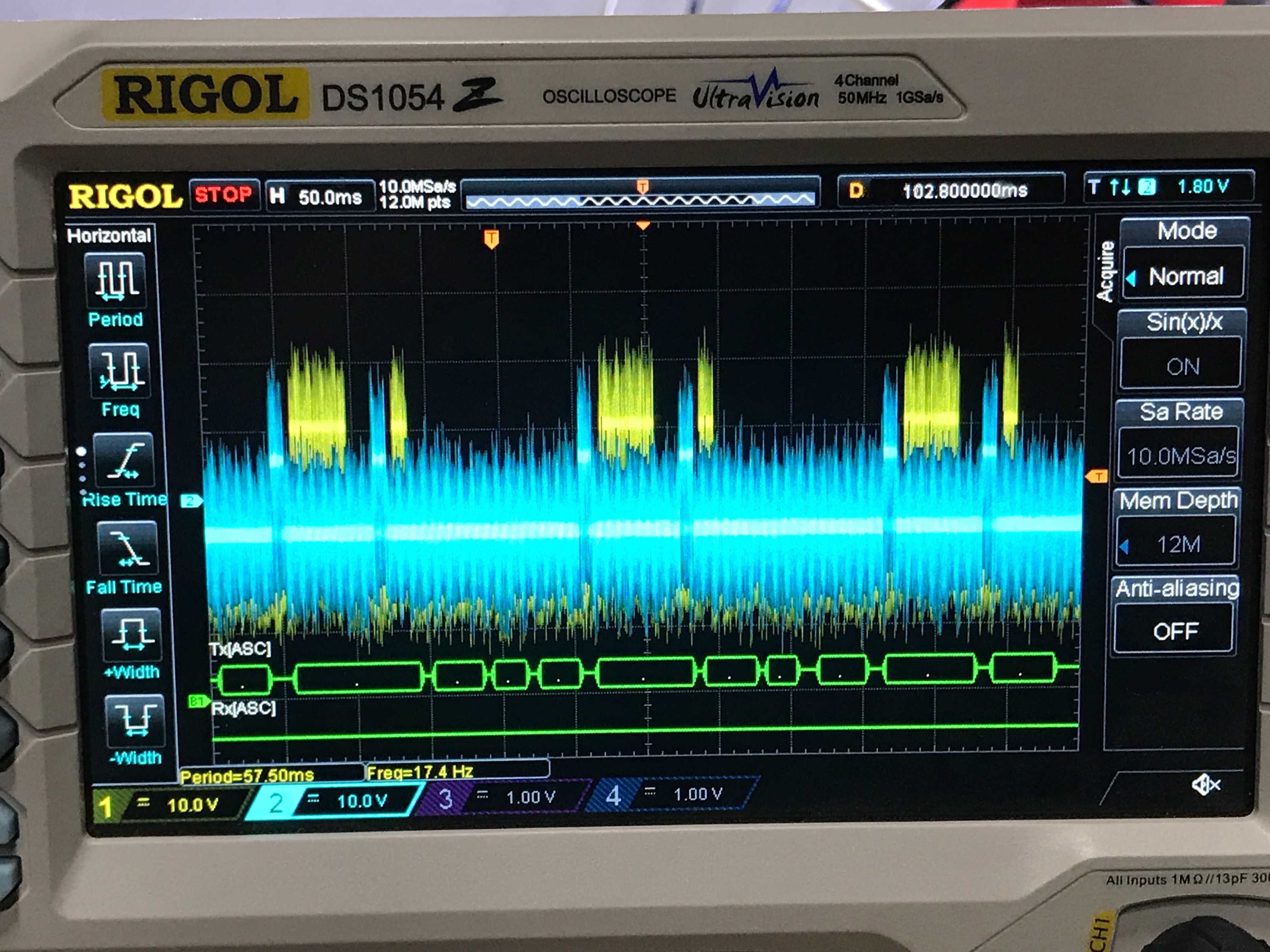

- thadwald
- Posts: 111
- Thank you received: 10
13 Mar 2019 03:07 #128480
by thadwald
Yeah. I assumed that the negative pin on my usb-rs232 converter was grounded and used that to ground the shield on my cable.
It’s not:
And grounded:
The noise all seems to be coming from the vfd.

- Posts: 19902
13 Mar 2019 11:06 #128500
Replied by andypugh on topic Spindle speed scaling
I took apart a cheap USB to Modbus dongle, swapped the USB plug for a pin header so that it would fit directly to a motherboard USB header and also changed the 2-pin screw terminal block to a 3-pin with a connection to the USB ground. (not 0V)
