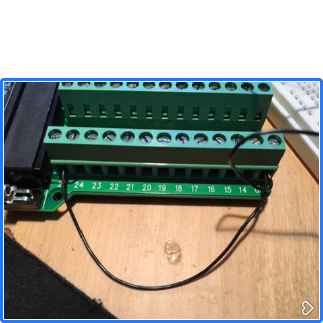

10 Aug 2019 09:09 #141858
by Ralfh
Replied by Ralfh on topic Mesa 7i92 Encoder wiring
So, i built a new .BIT with alternative pins:
i verified and attached the .bit if someone wants to use it. You can sudo-copy the .xml to /lib/firmwares/hm2/ to create your .hal with pncconf.
Also i found out how i bricked the pins. I got a Breakoutboard to connect wires to the DB25 connector via screw terminals. I connected all the GND wires on the Terminal "GND", but with the flat cable connection to the mesa board this screw terminal is NOT connected. I should have known that, since i crimped the cable. i will wire a cable to a functioning ground to never make that mistake again.
IO Connections for P2

13 33 IOPort Nonei verified and attached the .bit if someone wants to use it. You can sudo-copy the .xml to /lib/firmwares/hm2/ to create your .hal with pncconf.
