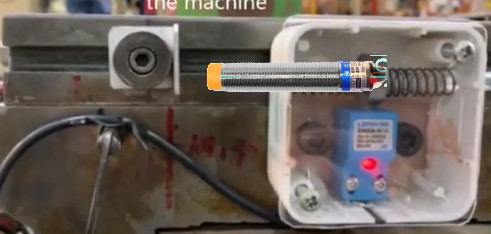

Hello, I’m new to the forum and new to CNC things. I am doing a CNC conversion on a Rong Fu style round column mill drill machine and having a number of problems with the LinuxCNC setup – most probably due to my lack of understanding. Please forgive me if I ask naive questions.
First problem/question.
For this question you have to visualise that you are standing in front of the milling machine. In the Stepconf X axis test, when I press the left arrow jog button <--- should the table move from right to left? The reason I ask is because in this scenario the cutting tool held in the Z axis spindle will be moving towards the right of the table/workpiece. I have it in my mind that the X axis 0 (zero) position is on the left hand end of the table for this type of machine. Most discussions and videos I have seen about this use examples of machines that move the spindle – not moving the table under the spindle.
Second problem
is with homing the X axis. At this stage the only stepper motor I have coupled to the ballscrew is the X axis. That way if things go wrong I will only damage 1 axis at a time .
I have started Axis and selected Home X axis. The problem is that after detecting the home/limit switch it backs off (as expected) and then tries to move past the limit switch. This produces a message ‘joint 0 on limit switch error’.
I have made a brief video of it, but don’t know how to upload to this forum – Video is here.
I have simplified the Stepconf config as much as I can help me understand how it all works.
My Stepconf config has:
Parallel port input pin 13 ‘Both limits and home X axis’
Axis X =
Home Location 1.0 (mm)
Table travel 0.0 to 304 (mm)
Home switch location 0.0
Home search velocity 5.0 mm/sec (I had it faster but then set this slower so I can observe what it is doing)
Home latch direction ‘Same’
I have attached the .ini file
I am not sure if it is relevant, but I have used one proximity switch on the X axis set up to do both limits. You can see it in the video. It is a Normally Open switch that is closed when the table is within limits. If it goes to either end limit the switch opens. I figure this design means I only have to mount 1 switch and wire, and if I get a broken wire then LinuxCNC will detect a limit switch error and stop. LinuxCNC is detecting the limit switch when I manually trigger it.
Thanks in advance for any advice.

- pl7i92
- Posts: 1872
- Thank you received: 359
07 Sep 2019 01:17 - 07 Sep 2019 01:25 #144453
by pl7i92
Replied by pl7i92 on topic Homing issue with new Rong Fu mill cnc conversion
hi
first this is not a good hardware as it debounces
you shoudt go with inductive 6-32V via a Relay direct to the Steel X
then homing Sequence
HOME = 5.0 # the Position the Axis ends after Homing
HOME_OFFSET = 0.000000 #the Position that showes in DRO G53 HomeTrigger location
HOME_SEARCH_VEL = -5.000000 #travel speed first trigger
HOME_LATCH_VEL = -3.000000 #travel speed second trigger
HOME_FINAL_VEL = 5 #Speed from Homeoffset to HOME
HOME_SEQUENCE = 1 #Number of Home Sequence 0=First usaly Z 1=X 2=Y ... -1=none of your choice
Last edit: 07 Sep 2019 01:25 by pl7i92. Reason: image

- pl7i92
- Posts: 1872
07 Sep 2019 10:05 #144479
by pl7i92
this switches you use arent safe on pos as they use mechanic triggers so it may trigger within the 1000reds per second more then one as it can be on or off at the mechanical trigger bounce
THE Relay sayinfg you can use 12V to the switch Back Relay A1/A2 and got internal only the BOB loop on the COM/NC
Where A1 is 12V and A2 goes to all switches LJ12A3-4-Z/BX
look PDF K4
look PDF K4
