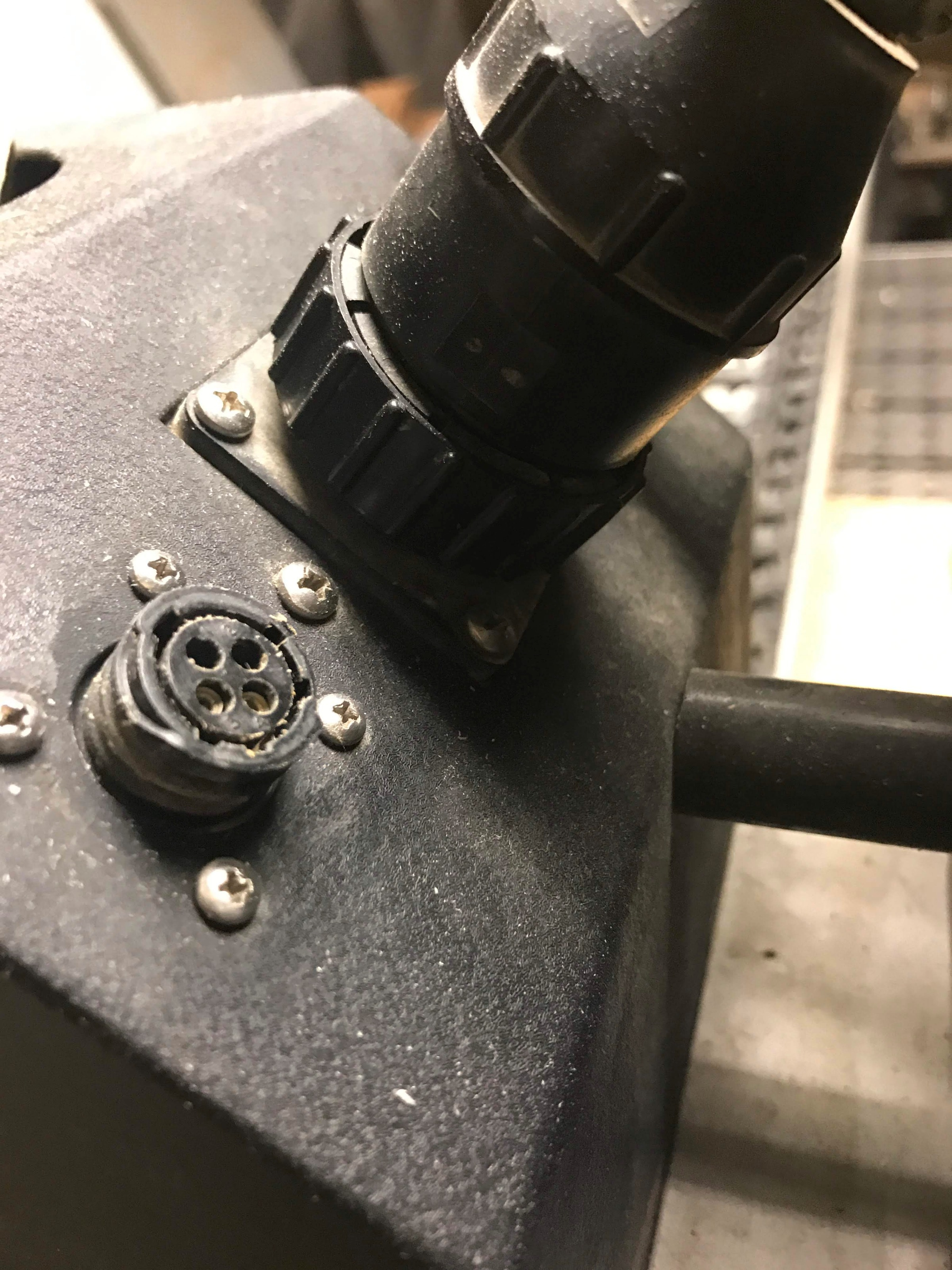

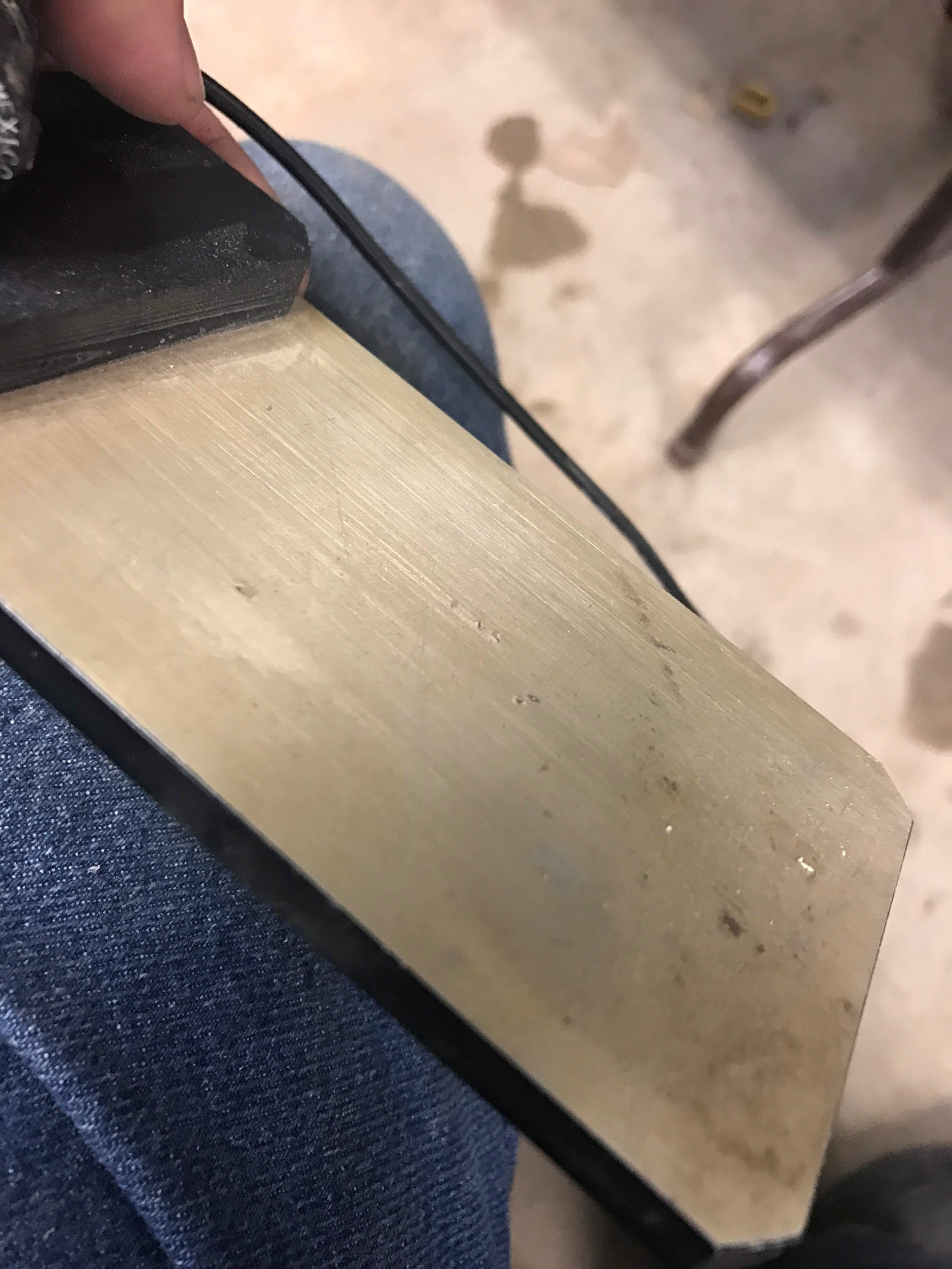

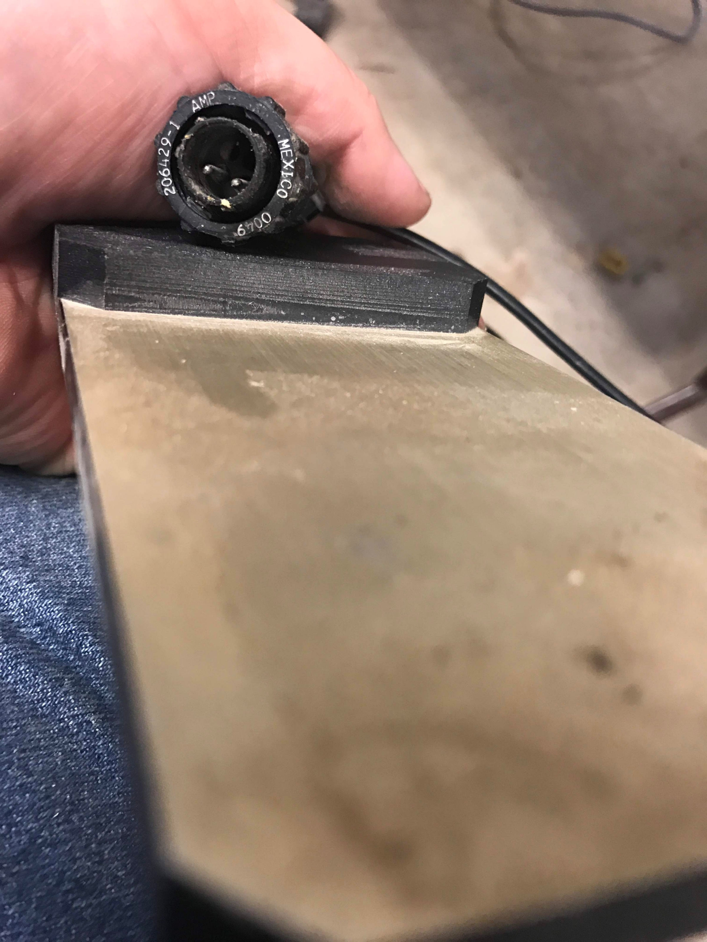

Here is some pics of the Z touch plate that came with my CNC. However, I cannot figure out for the life of me how it would work.
As you can see there are 2 wires going to the plate, both are connected to plate so there is no resistance between those 2 wires. They run to the controller and have been identified.
My understanding is that I would need a wire going to the tool and one to the plate. However I can't find any conductor going from the tool/spindle to the controller. I think the spindle is insulated? Would I have to run another wire to the spindle that would be clamped on tool? or is there any other way around this?
I created one of these pretty simply with my old parallel port / mach3 setup. I did have to clamp on to the tool though. Wasn't sure if that would always be required of if there was a better way?
Then what's the best practice for setting up a Z homing procedure within LinuxCNC?
Thanks for any info!

seams like a omic sence
get 5V on the plate and mesure the resistence if a steel tool touch the plate

BUT im with you it may only ((black pice)) be a pice of Electric shield to the Mashine
he needs to get a meter on to see what hapens without a mashine connect
meter BLACK to one pin of detector connector
the other to a BIT/tool in Hand and just touch
while meter is in Detect Thrue mode / ""Durchgangsprüfung""
then he is fine and can simply direct BOB connect via ground detect
I DO NOT RECOMED BOB ground on Mashine AS so many using that

I still haven't had any luck on this, maybe I need to purchase or build a different Z plate.
Between the bit and the ground there is some resistance but it's a connection. I missed it at first because I was just listening for a continuity beep from my meter, however there is a connection between bit and ground wires.
How could I wired that up?
I am using a Mesa 7i77 & 7i92 boards.
Anyone have any thoughts?
Thanks!

You might be able to add an opto-isolator (or even a relay) to the touch-plate circuit to convert the resistance change to an on/off signal for the GPIO.
