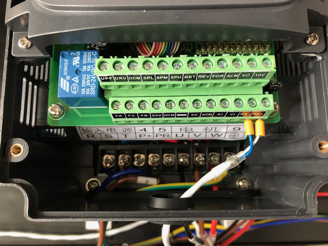

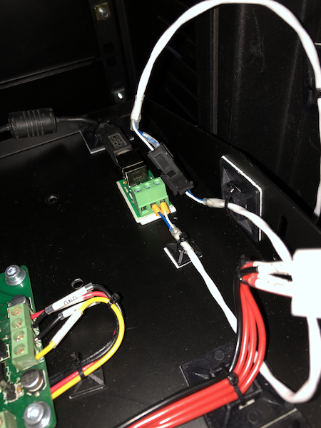

Here some pictures :
The USB to RS485 converter :
White wire (D+) has to be inverted with the blue wire (D-). pinout of the converter is :
Cable is a twisted shield pair without connecting shield (length is above 1,2m 47in) and RS485 works not very quickly (9600 Bauds)
And the connection into the HY inverter :
There's no schematic.
The Router CNC console is now closed. I will normally not open it yet until router table is made ... wait and see...
| Left | GND |
| Center | D+ |
| Right | D- |
