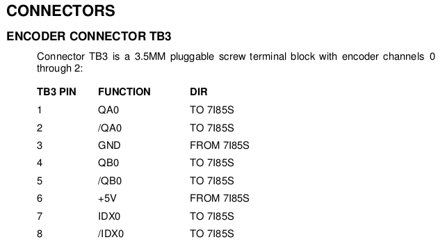

My scaling is: One pulse is 5μ and one motor turn = 5mm. If I turn the servo, the control changes in 5μ steps.

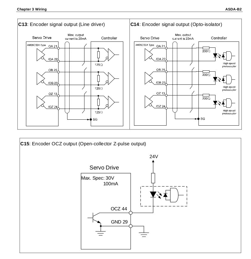

Connection are as follows:
Step + Dir from 7i76e to Amplifier (Delta ASD-B2) =>
Power from the amplifier to the servo (Delta ECMA C20604) =>
Feedback (incremental) from the servo encoder to the amplifier =>
and in the end: feedback from the amplifier to the input encoder on tb3 7i785s. The signal is a difference signal with A, B and Z phase

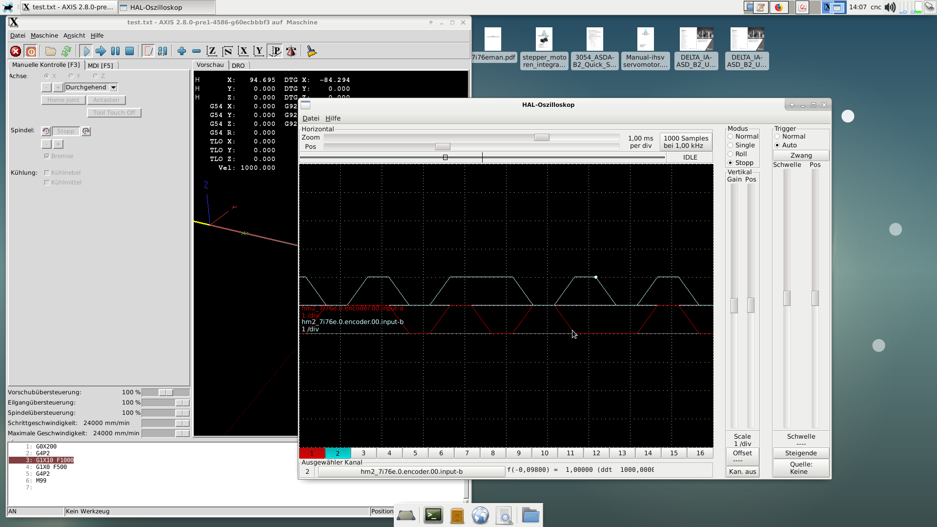

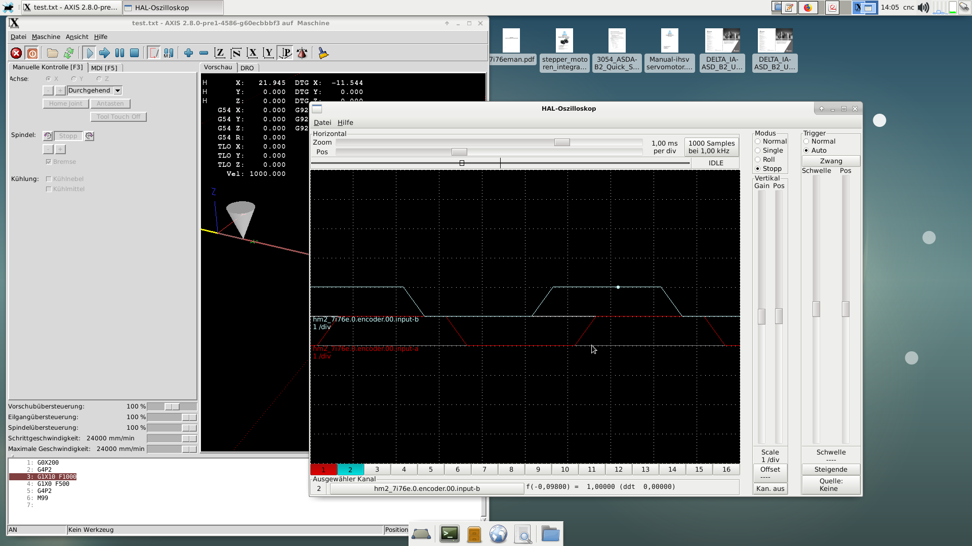

I have measured once with the hal scope but unfortunately I can read anything on it. First image is at 500mm / min feed and the second with 1m / min. Maybe you can explain that.

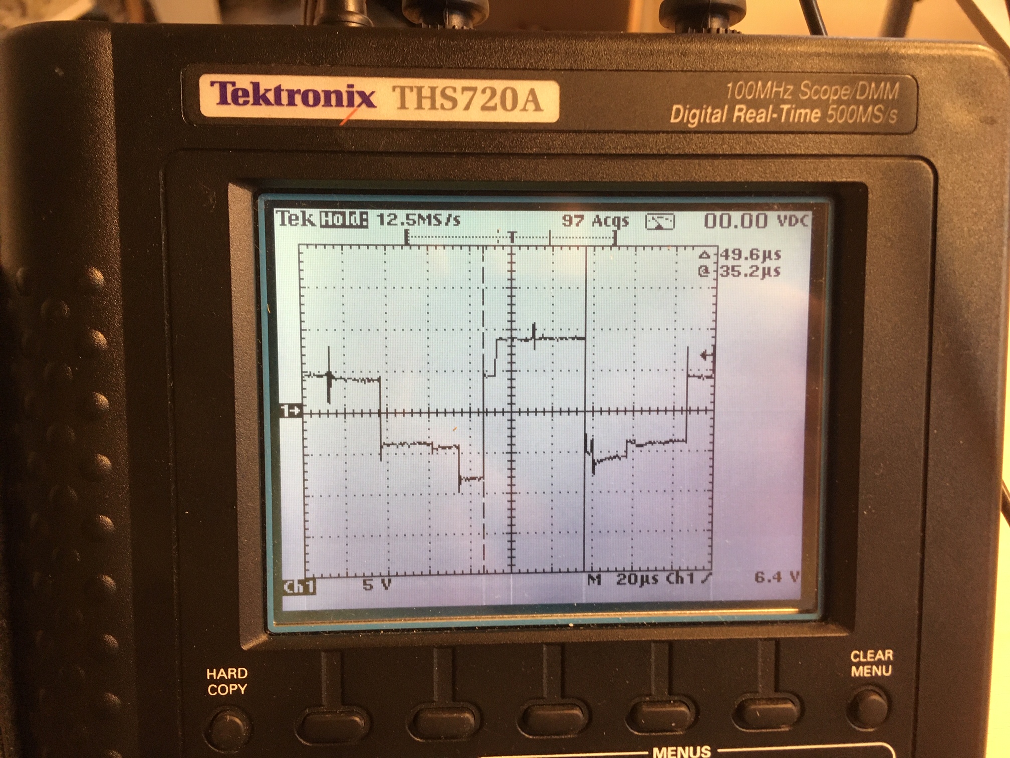

Then I took my scope and simply measured between A and / A. Are 24V with a period of 49,6μs at 12m / min rapid feed. 3rd picture. On the top right you can see delta t = 49,6μs
Calculated I have now 1 / 0,00005s = 20000HZ * 2 (A and B phase) = 40KHZ. My mistake I forgot the K
I hope that my idea is not so bad ...

13 Oct 2019 08:40 #147818
Replied by PCW on topic Servo adjust with encoder feedback
24V is _way_ too large a signal for a 7I76E or 7I85S encoder input
Both cards expect 5V signals

- Posts: 18118
- Thank you received: 5336
13 Oct 2019 09:58 #147820
OK those _should be_ 5V signals
no power is needed
(the OCZ signal is not used)
no power is needed
