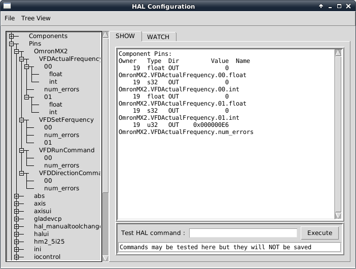

Today I managed to set up the mb2hal.ini file. Everything looks very fine and it was actually fairly simple.
The MX2 only supports the mb2hal-functions "fnct_03_read_holding_registers", "fnct_15_write_multiple_coils" and "fnct_16_write_multiple_registers".
The first transaction in my ini file is to read out the actual frequency of the VFD. The register numbers for the output frequency monitor of the MX2 are 1001 hex for the high value and 1002 hex for the low value. The range is from 0 to 40.000 (0.01 Hz-steps). How can I generate a float variable, wich I can than use as input for motion.spindle-speed-in-rps?
And the same question I have for TRANSACTION_03, just the opposite way around: how do I convert the float variable of motion.spindle−speed−out into two variables, in order to write them into the registers 0001 hex for the hi value and 0002 for the low value?
