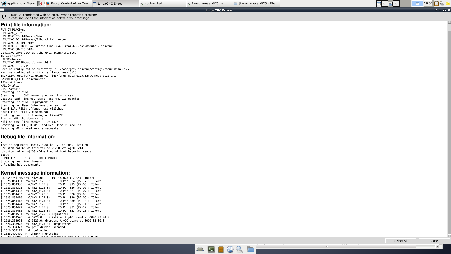

Hello ,
after hours of reading and trying i found your solution, i installed it but it doesn't work, i have a hitachi wj200 vfd.
the user manual is not easy, can you help me more?
have a good day

Which solution did you try? What doesn't work?
There is a special component for the WJ200:
linuxcnc.org/docs/2.8/html/man/man1/wj200_vfd.1.html

Replied by andypugh on topic Control of an Omrom MX2 VFD via RS485 USB-adaptor
Though that is a very rubbish documentation page!
Looking through the source code:
github.com/LinuxCNC/linuxcnc/blob/master...0_vfd/wj200_vfd.comp
The component would be loaded withfor example.
Note that the driver is loaded with wj200_vfd but the pin names follow the HAL convention and use wj200-vfd
loadusr -W wj200_vfd --baud 115200 --parity 0 --databits 8 --stopbits 1 --device /dev/ttyUSB0Note that the driver is loaded with wj200_vfd but the pin names follow the HAL convention and use wj200-vfd

12 Oct 2020 10:08 #185843
by jefsaro
Replied by jefsaro on topic Control of an Omrom MX2 VFD via RS485 USB-adaptor
- jefsaro
- Posts: 110
- Thank you received: 4
12 Oct 2020 10:10 - 12 Oct 2020 10:13 #185844
by jefsaro
