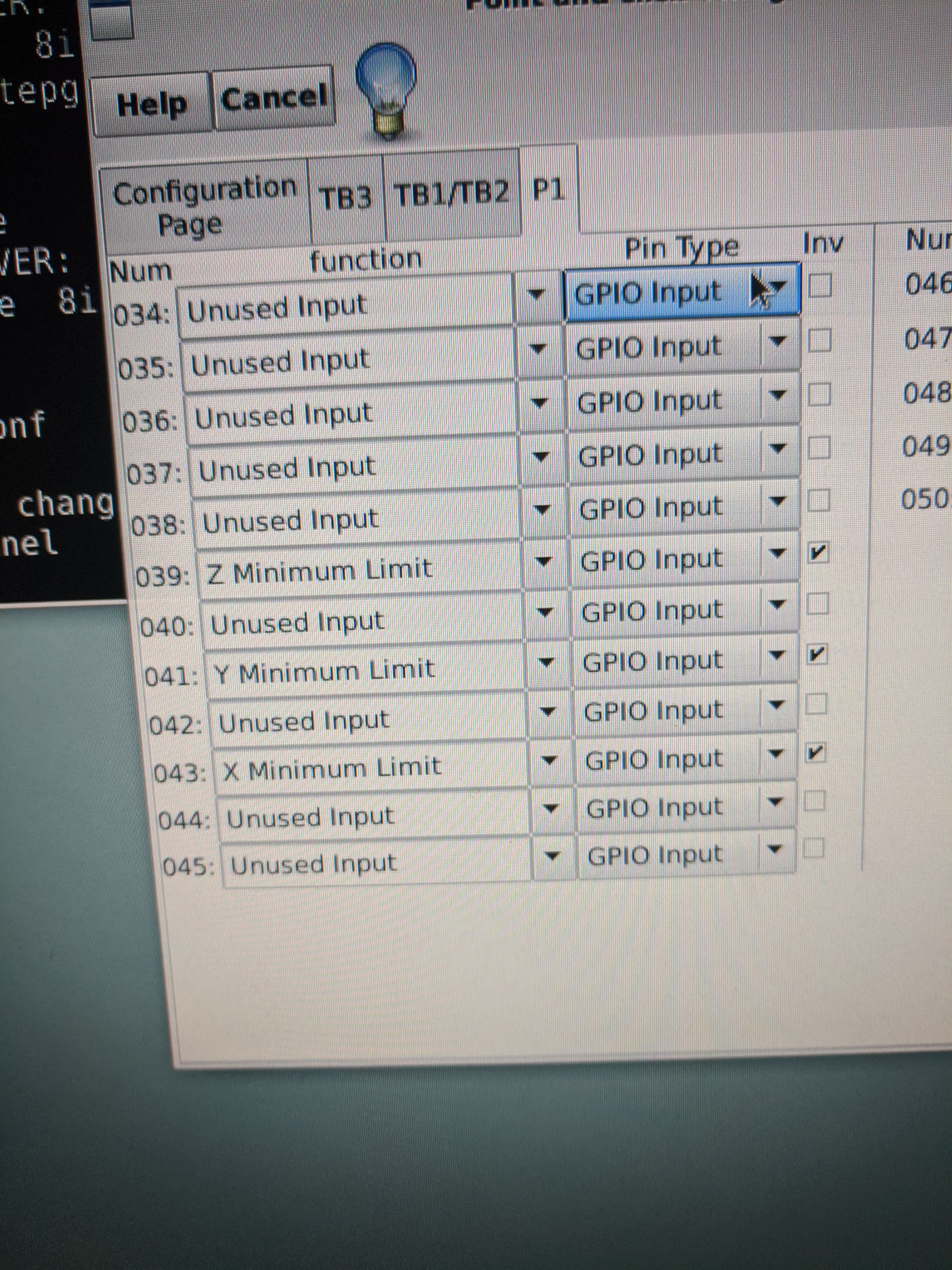

Hello, I have X, Y, and Z limit switches configured for my machine but they do not seem to be stopping motion of the machine when they are engaged. The LEDs on my 7i96 turn off when a switch is engaged, so I'm pretty sure I have them wired up correctly.
Here is what I have set up:
My hunch is that I'm not setting the correct pin numbers in the config, but I don't know what else they would be set to as that is how they are labeled on the board.
Any guidance is always appreciated!

Your limit switches should be setup on the TB3 tab

That did it! I knew it was something basic that I had done wrong. And now that I know this, I see where I could have found that information on the 7i96 manual.
Thanks!
