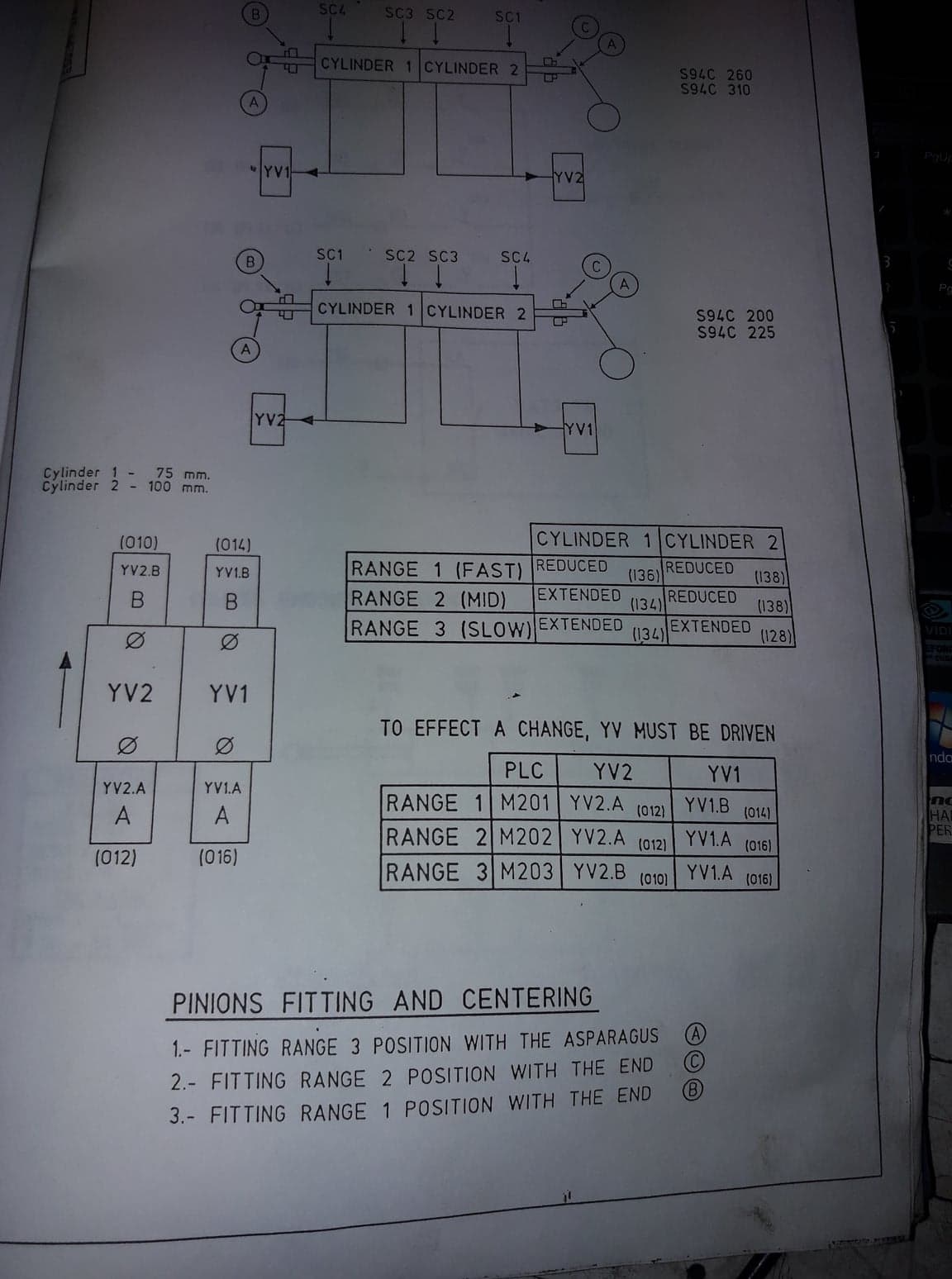

Hello
I have a problem with gears in a lathe
how to configure the spindle as i have 3 gears
0-310, 310-840,840-2300 rpm
I change manually but only on the 3 fastest gear I reach spindle at speed
Sorry for english i use google translate

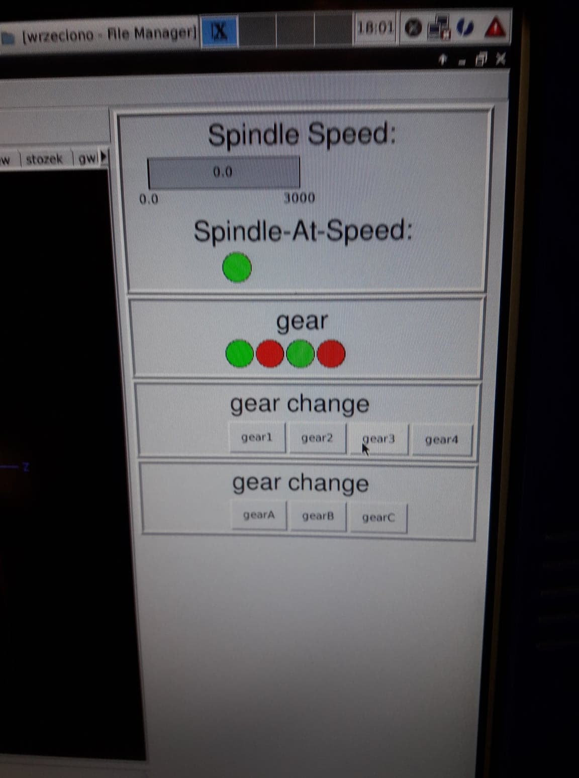

These are my beginnings with linuxcnc, but it works fine for sindle at speed in 3rd gear
840-2300 is ok
2nd gear works only up to 400 rpm spindle 1 gear does not work at all, it rotates in all gears but no passion turns. How to make the program run at low speed, e.g. 500 2nd gear, linuxcnc is waiting for reaching the 2nd gear,
on pyvcp spindle rotor 2300 rpm in fact the spindle rotates 870 rpm
how to do it so that the system can see the speed after changing gear, the encoder works because in 3rd gear you can thread
840-2300 is ok

You need to scale the spindle velocity command signal to suit whatever gear you are in.
Basically, when you are in a low gear, the motor needs to run faster in order to achieve the commanded speed at the spindle.
I use classic ladder for this normally.

Hello
if someone friendly will tell me how to scale the spindle for 3 gears and how to write the program in classiclader so that when changing the gear work the spindle scaling and speed correctly. what to add in hal / ini file
