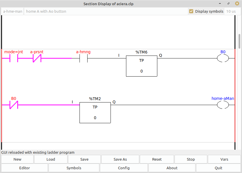

I can't seem to find info on how to configure my 4th axis to support homing. I have a sensor for it, but it's not clear how to configure linuxcnc so that I can do an homing operation (the 4th axis isn't always installed), and also not trip just because the index went by the sensor.
What's the config to achieve this?
- Posts: 4819
- Thank you received: 2177
15 Oct 2020 06:30 - 15 Oct 2020 06:48 #186184
Replied by Aciera on topic Homing A axis (I have a sensor for it)
I also have a detachable 4th axis. To manage homing correctly I have a hal-signal that defines whether the 4th axis is present or not. If it is present then it homes normally as setup in the ini if it is not present then I generate a homing pulse in classicladder to home the axis as soon as it starts the homing process.

To answer my own question: it seems it works as desired to simply configure homing, and to specify only a home switch input on the joint:
As to avoiding the need to home when the axis is not present, I'll have to do something like what Aciera suggested, although I really don't want to.
HOME = -1.7
HOME_SEARCH_VEL = 180
HOME_LATCH_VEL = -18
HOME_SEQUENCE = 0
HOME_USE_INDEX = 0
net max-limit-home-joint-4 joint.4.home-sw-in <= hm2_7i76e.0.7i76.0.0.input-15-notAs to avoiding the need to home when the axis is not present, I'll have to do something like what Aciera suggested, although I really don't want to.

Update: I was wrong. I wish there was a way to tell LinuxCNC to ignore an axis for homing at run time (e.g. via user interface, or some signal the hardware can detect).

If you omit HOME_SEQUENCE the joint won't be homed via home all.
