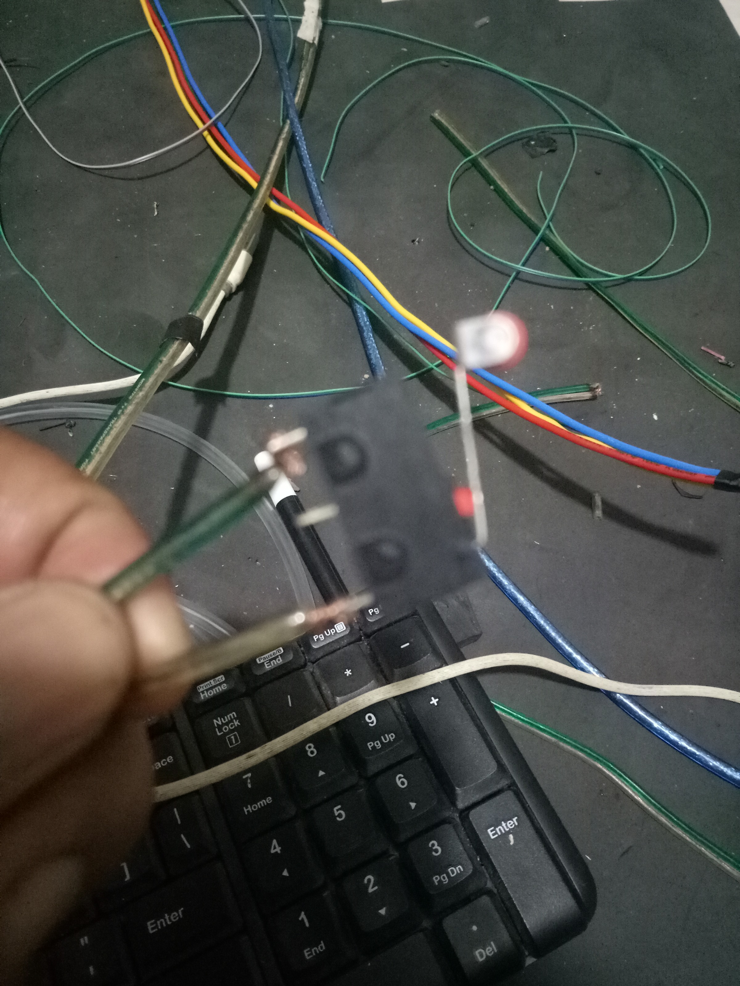

I have an error when setup limit switch.. All axis doesnt send signal to my BOB...
When i try to homing its dosnt work... I check the hal meter and its not happen anythings...
My limit switch is NPN

What type of BOB do you have? some common "Mach 5 Axis" types require
a 12V supply for the inputs to work
